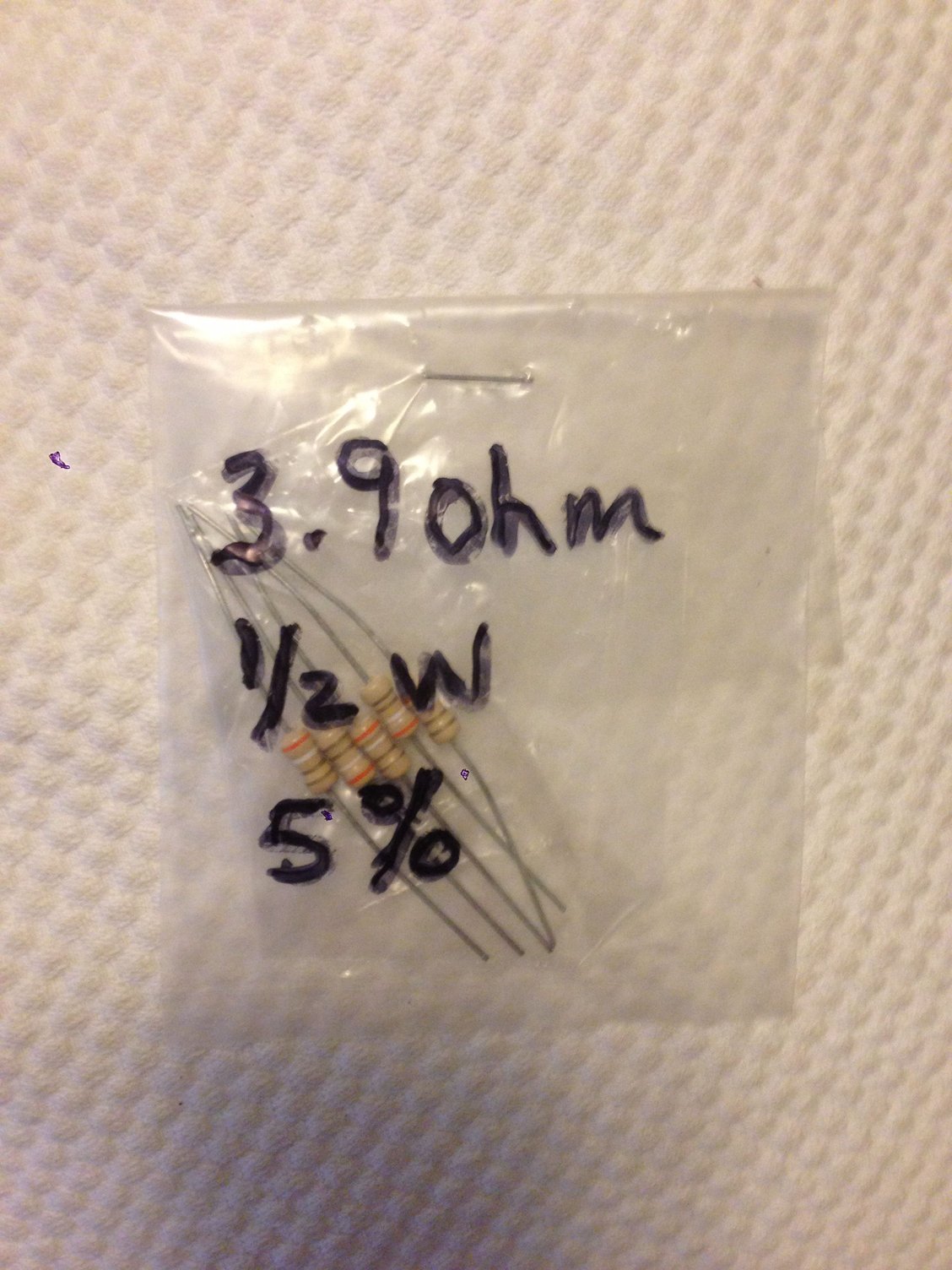

Old Jun 17, 2020 | 06:29 AM
MiniManAdam's Avatar
MiniManAdam
Community Builder
Joined: Jan 2020
Posts: 5,272
Likes: 709
From: OakCreek
Originally Posted by Hoon Motorsports
I made these pigtails for switching between my race seats for track and stock seats for street driving.
One for airbag One for Seatbelt. You will need pieces for each side of the car if you do both.
You can buy the pigtails from the MINI dealer or cut them out of a donor car and add the resistors inline.
I have had no problems with lights using these. Just remember not to run the key on when nothing is connected.
I thought I'm sapose to use 30ohm ???
Can you provide me links so I could just go and buy exactly what I need..I'm starting to regret buying these seats tgat have just been sitting outside of my car collecting dust.
