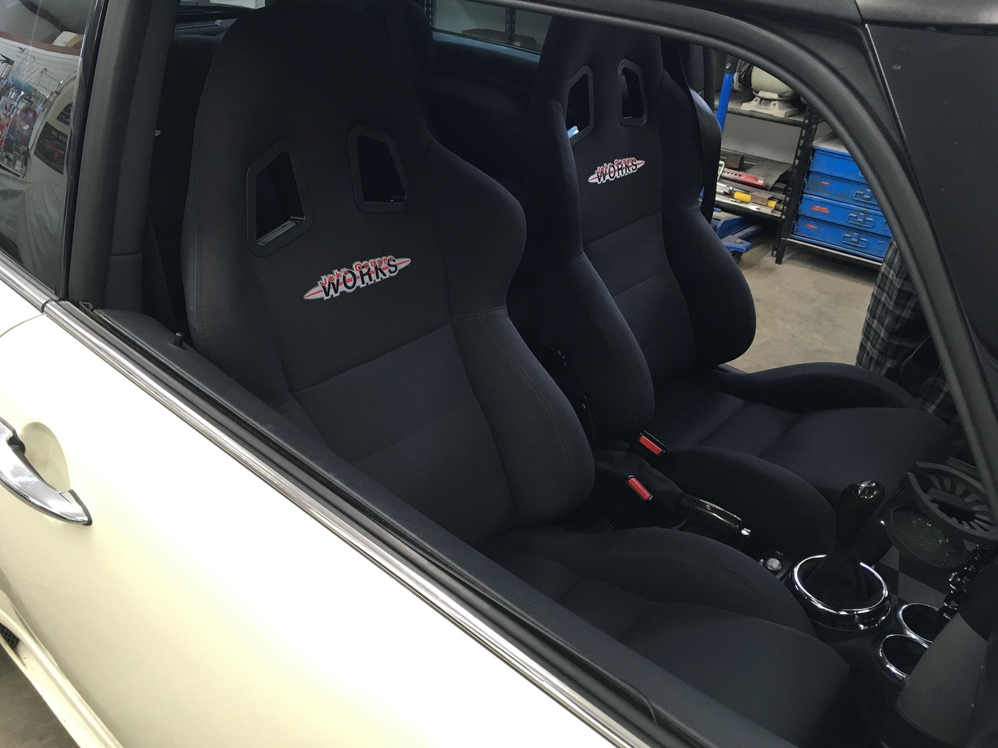

This week I'm going to get the seats fitted. Unfortunately, I only ordered one air bag resistor because I was feeling intellectually challenged when I placed the order, obviously forgetting I need one for each front seat. I ordered it quite some time ago and am expecting it to arrive at some point this week. In anticipation I've fitted the rear seat (but forgotten to take a picture, and I've removed the fronts. It's cool to have a side by side shot of the old vs the new (Standard OEM cloth vs Sparco OEM cloth).
I'm so incredibly happy with them, but there's a little bit of me that wishes I'd had them redone in some sort of red fabric. It wouldn't have matched OEM, but I think it could have really worked with the Pepper White paint. Ah well... what's done is done. Perhaps something to think about for a Post Covid world.

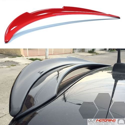

A while back I bought a leap spoiler extension but haven’t been able to commit to fitting it to the car. I’ve been contemplating other spoiler options and had considered a GP style but I kept coming back to wanting the shape of the leap spoiler extension. What I don’t love is the crease at the top and underneath, where it mates with the OEM piece. In particular, I really dislike the the top side edges. If not for these issues, I love the side-on silhouette it gives the car.
An example of the leap extension mounted to a white roof car.
It doesn’t quite span the width of the OEM spoiler and it’s immediately apparent that this is an after market attachment.

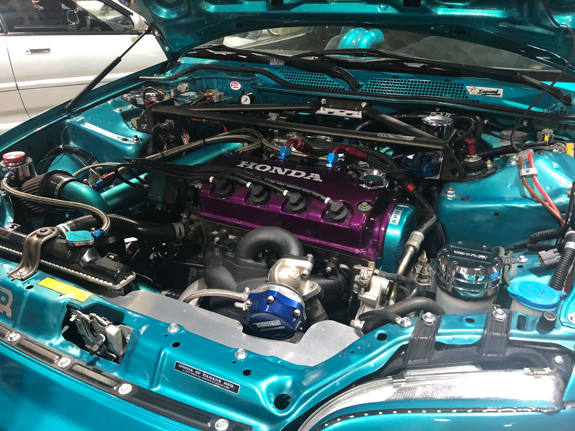

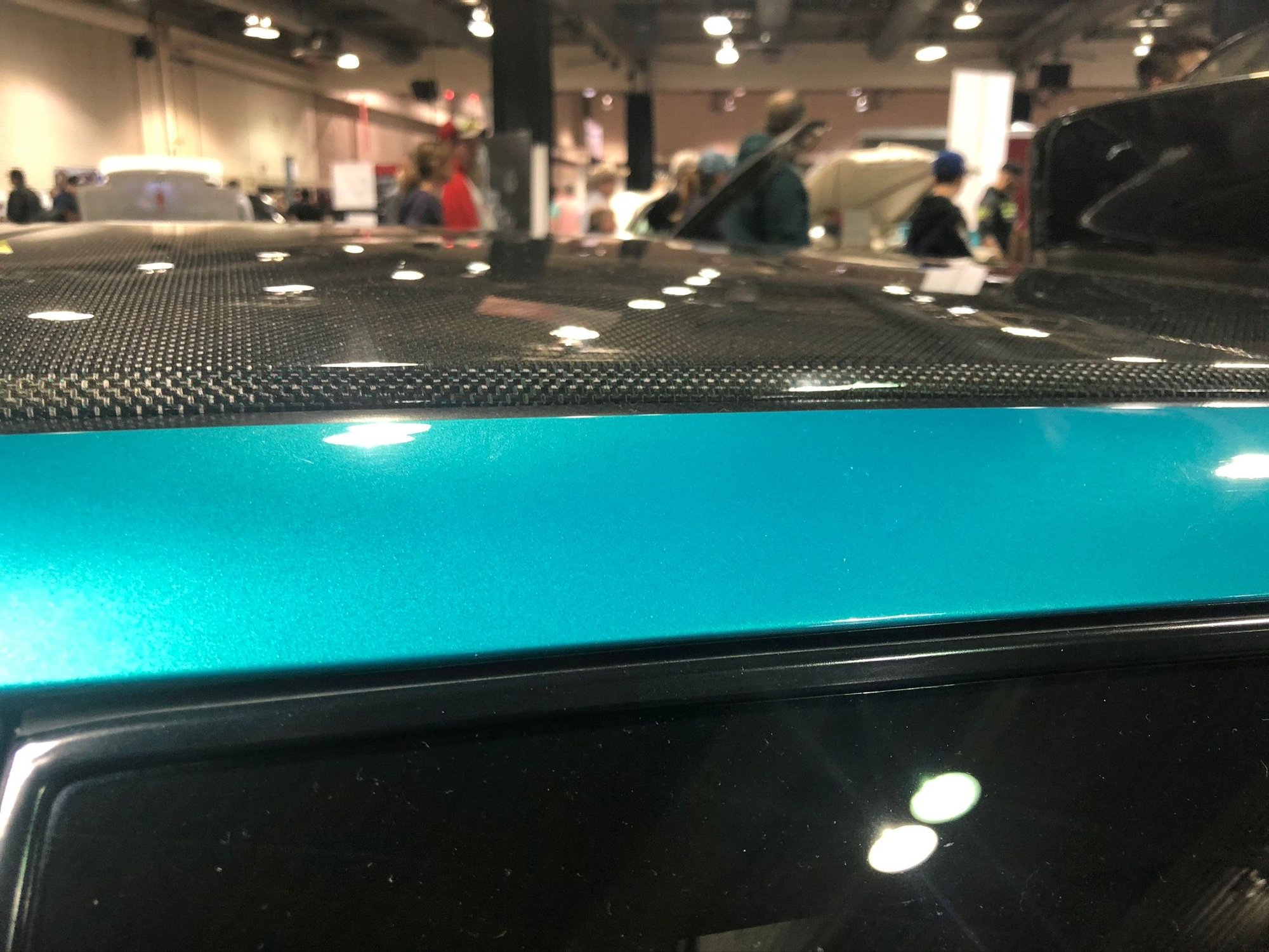

A while back, earlier in 2020 I was at a car show in Calgary where a small tuning and body shop called Compact Tuning Lab had some
of their classic projects on showcase. One of them was this stunning green civic pictured below. It had all sorts of period specific parts which had been fused, rather than simply stuck in place. When I asked, I learned that this civic had been built in 2004/2005 - I was in awe that this bodywork haven’t shrunk/split in all this time. They reassured me that as well as having great knowledge and experience, they use the best quality body filling material to achieve this beautiful and long-lasting work.
There’s so many amazing details on this car. You had to be a real Honda nut to truly get it (which I’m not) but this thing was incredible. Take a look at the rear bumper splitter - and even the rear mud flaps.
The roof is simply a beautifully installed carbon weave layer which has been clear coated with a gloss coating, containing a hint of the cars green pigment. They did this in 2004!
It’s not at all relevant for this post, but take a moment to gaze at this engine bay. I’ve rarely seen such attention and passion put in to anything Euro - these JDM kids know what it’s about!

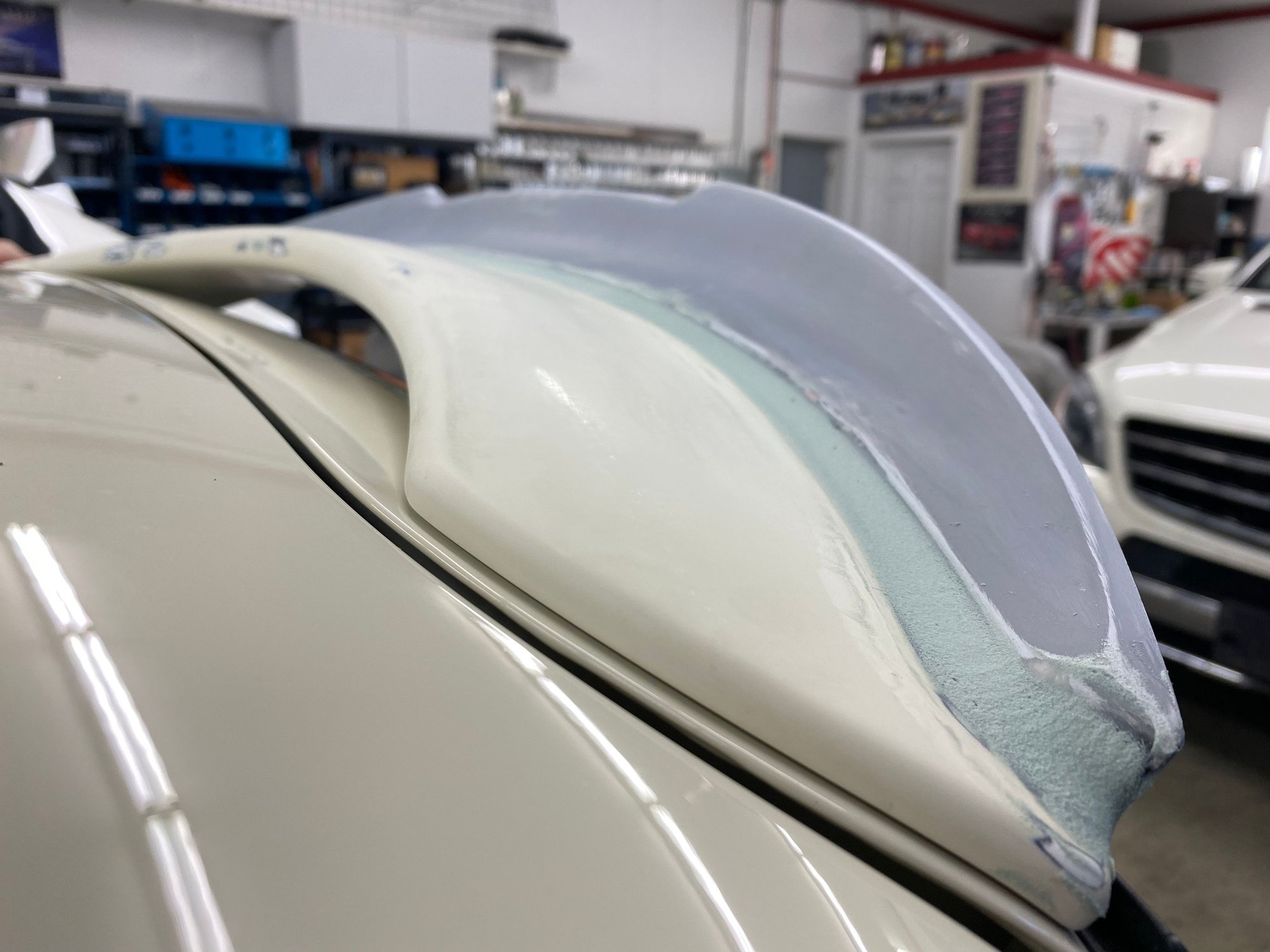

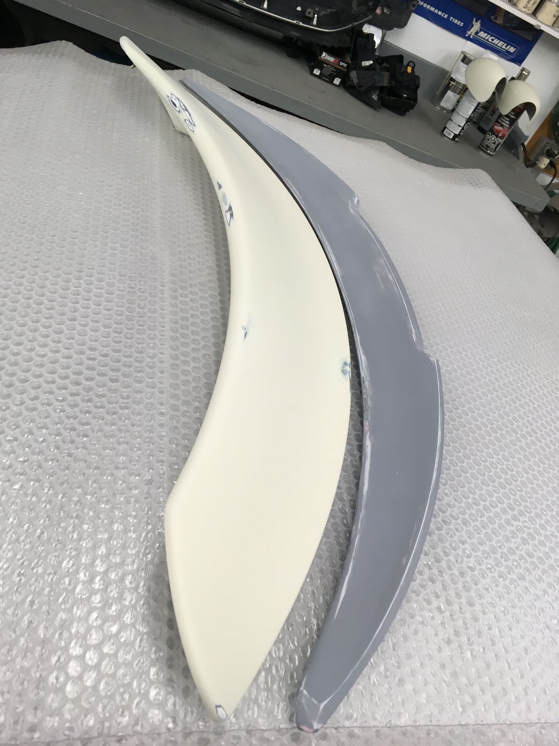

So by now you probably know where this is going. Compact Tuning lab (CTL) are going to fuse the OEM spoiler and the leap
extension so it feels like a one-piece. They haven’t made any promises as there are limits to what’s possible based on how products line up together - and how much filler is required.
Taking off the original spoiler isn’t very difficult but requires some clean-up from the EPoxy it’s attached with.
Here’s the OEM spoiler lined up with the Leap extension. CTL said they can work on this over the coming days.

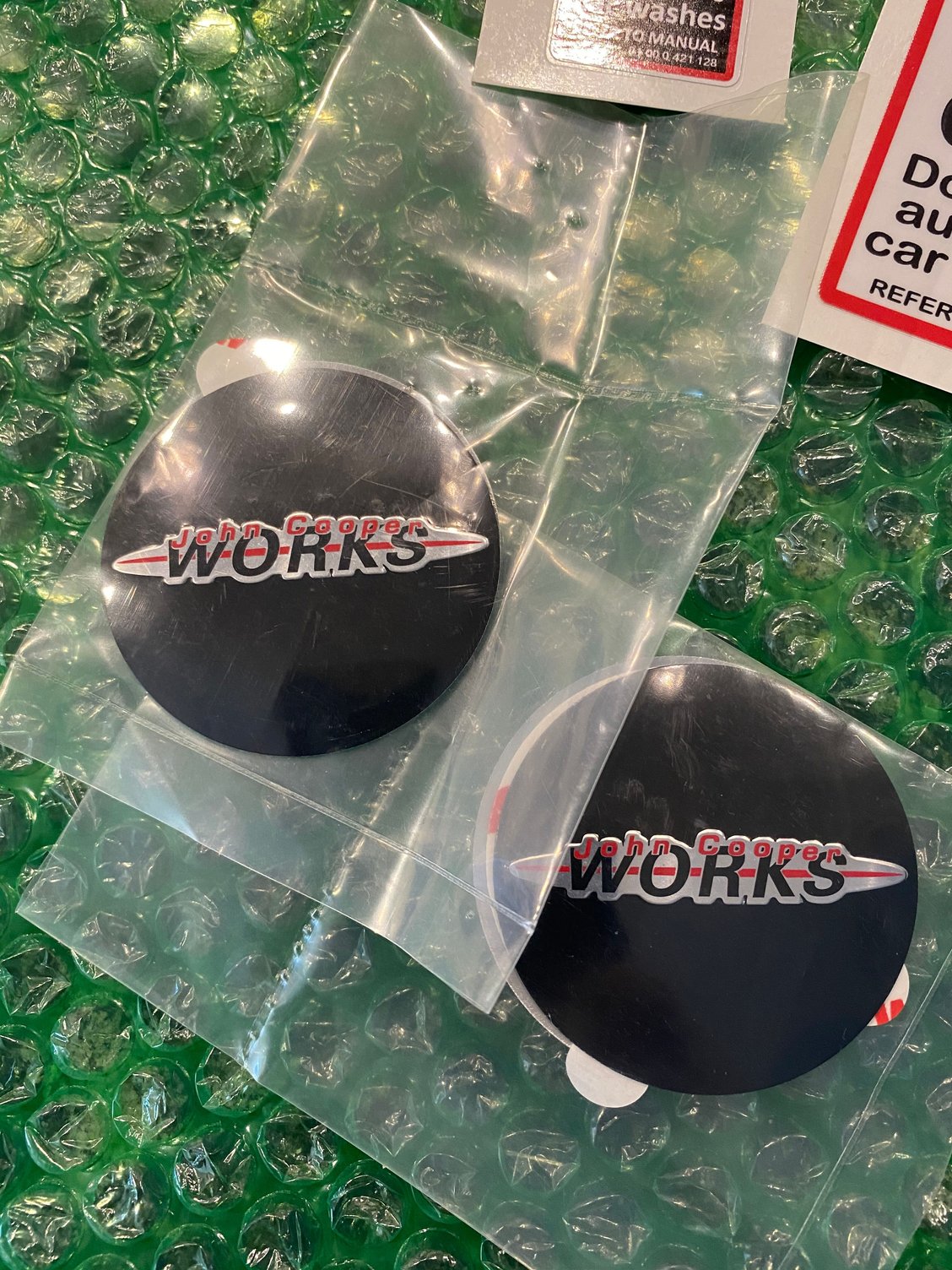

Thanks to @StuRat I received these awesome parts this morning. A (close to) new front grill JCW emblem, and 4 Original Logo centre caps for the R90s. Thanks for packing these so well Stu, and for including the fun stickers.
This badge is in fantastic condition, and if Stu had not told me it had been mounted for a short time, I'd never have been able to tell.
Love these. I'll be heating and removing the MINI centre caps from my R90s and using an epoxy to replace with these.

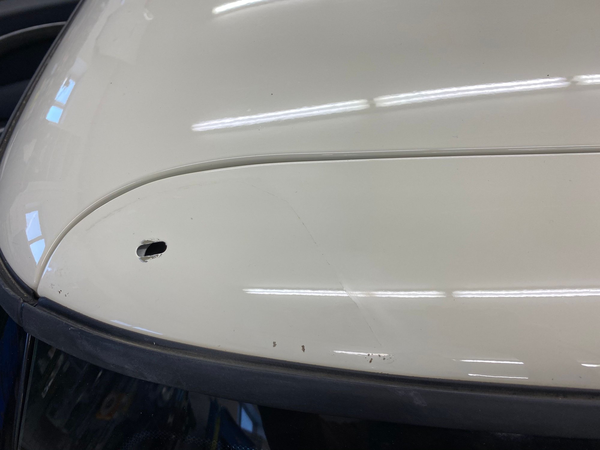

Got the top of the hatch cleaned off from the removal of the OEM spoiler.
Did a quick test fit of the unfinished single piece spoiler so adjustments could be made if necessary. More filling and sanding work is required.
CTL were able to bring the lip a little further of the end of the OEM spoiler than would be normal because of the filler.
Had to switch to this stubby antenna as the original won't fit when the trunk is open.

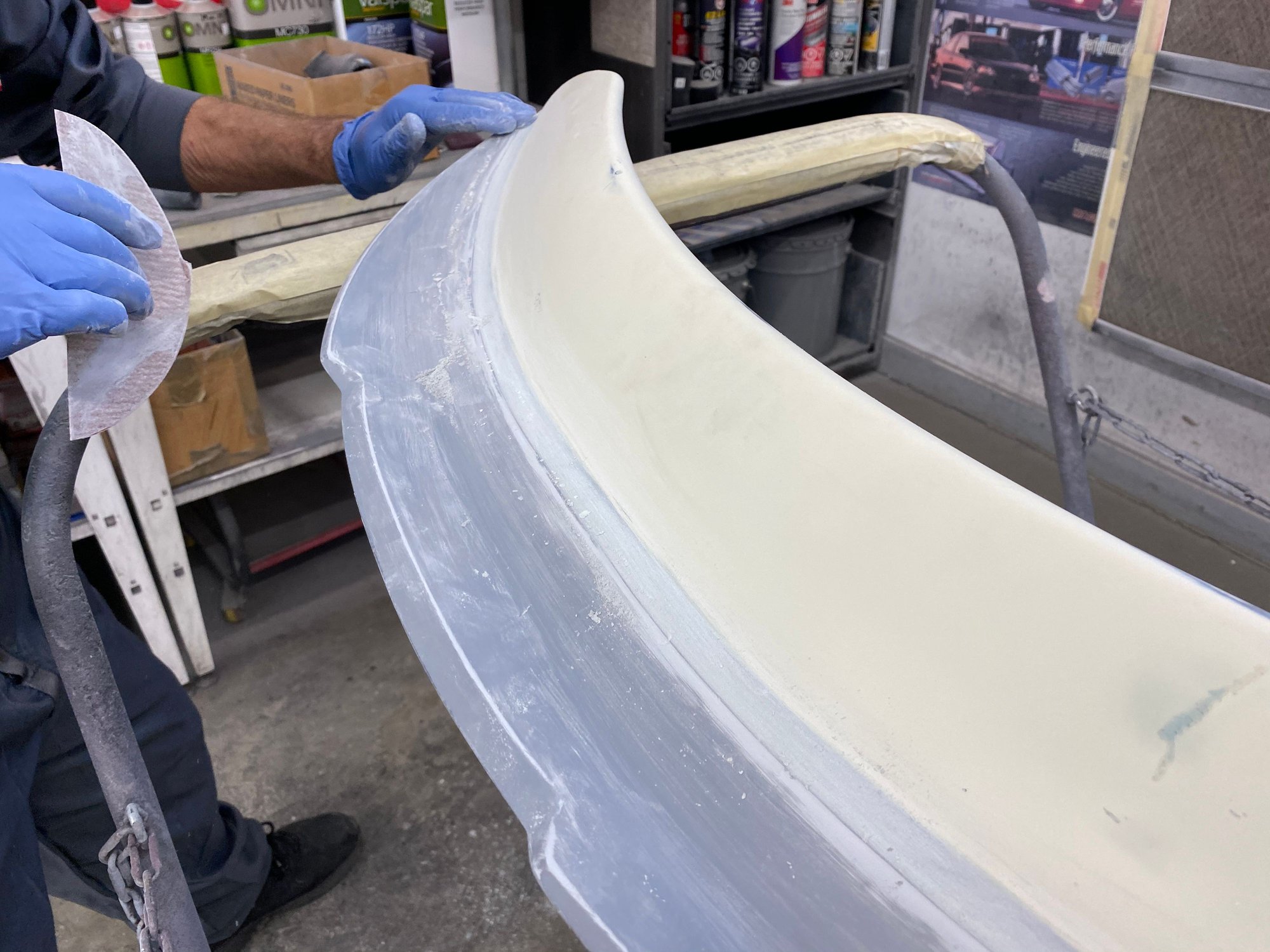

Spoiler continued to get more work after the test fit. It's not going to look like a true one piece as the extension just doesn't span enough width of the original spoiler, but it should look slick.

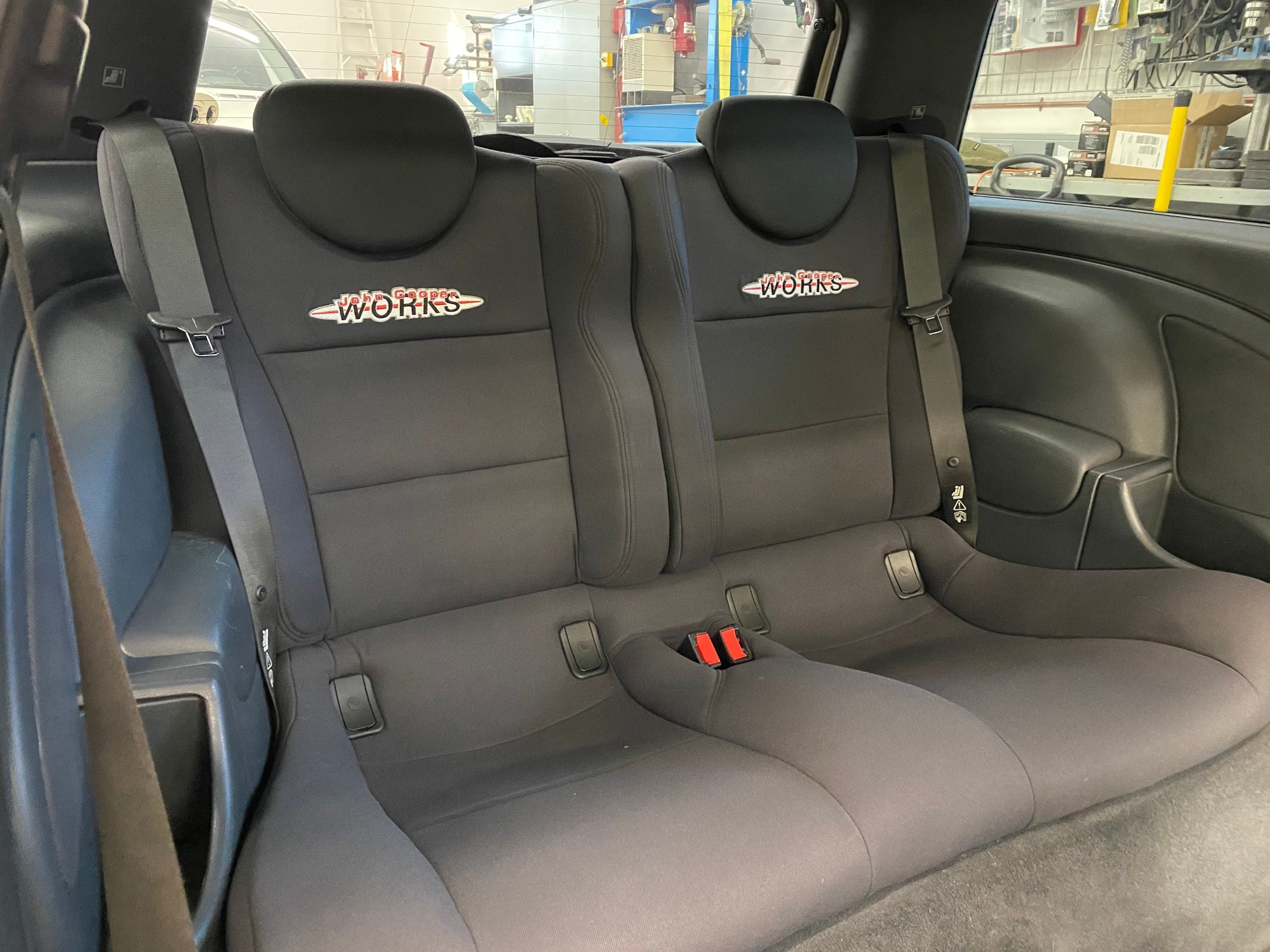

The rear seats are now installed.

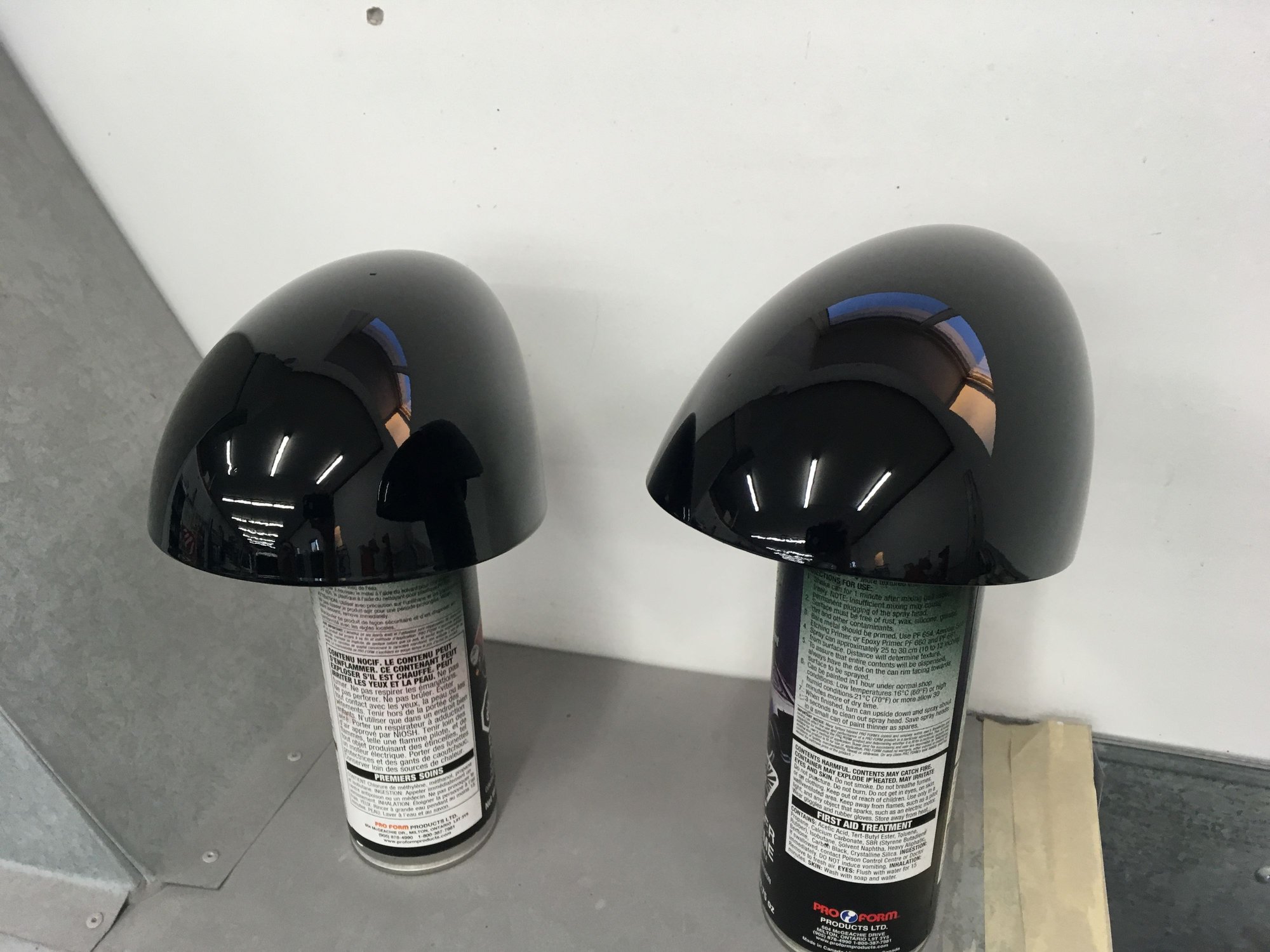

I'm going to paint the mirror caps black. Thanks @JackMac for giving me the inspiration to do this months ago!

This was the spoiler earlier today, getting really close to paint.
And here it is finished. CTL have done an incredible job.
I'm very happy with how it's turned out and can't wait to see the car in full attack mode!

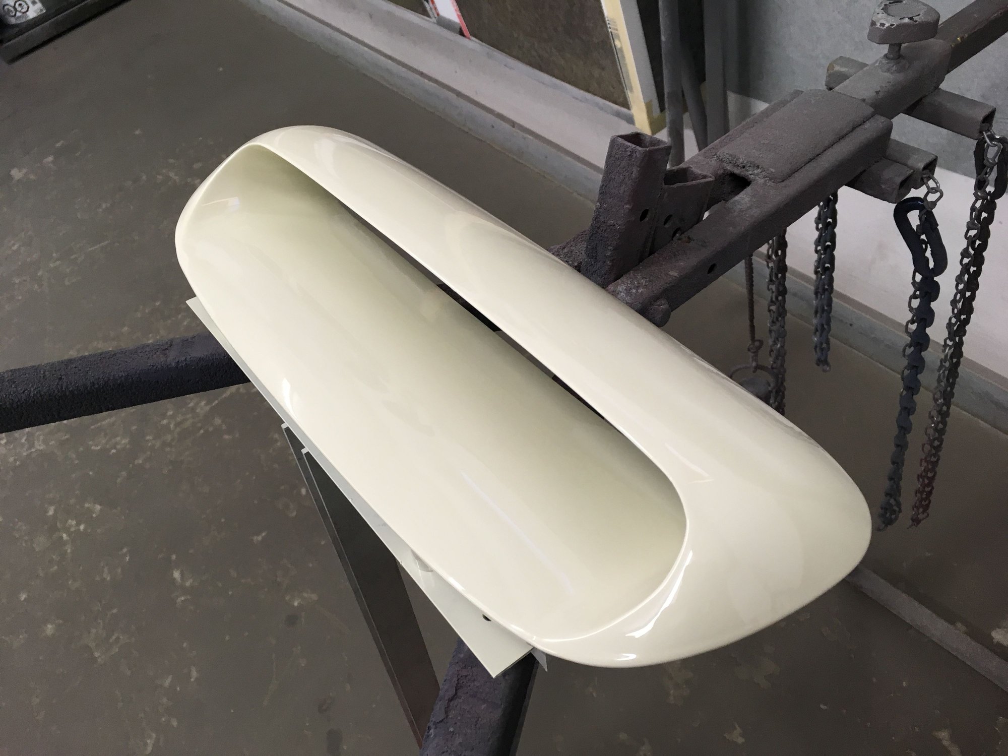

The Omicron scoop is looking even better with the professional paint job - I did ok with the rattle can but it wasn't in the same league as this.
As mentioned yesterday, decided to go gloss black for the mirror caps.

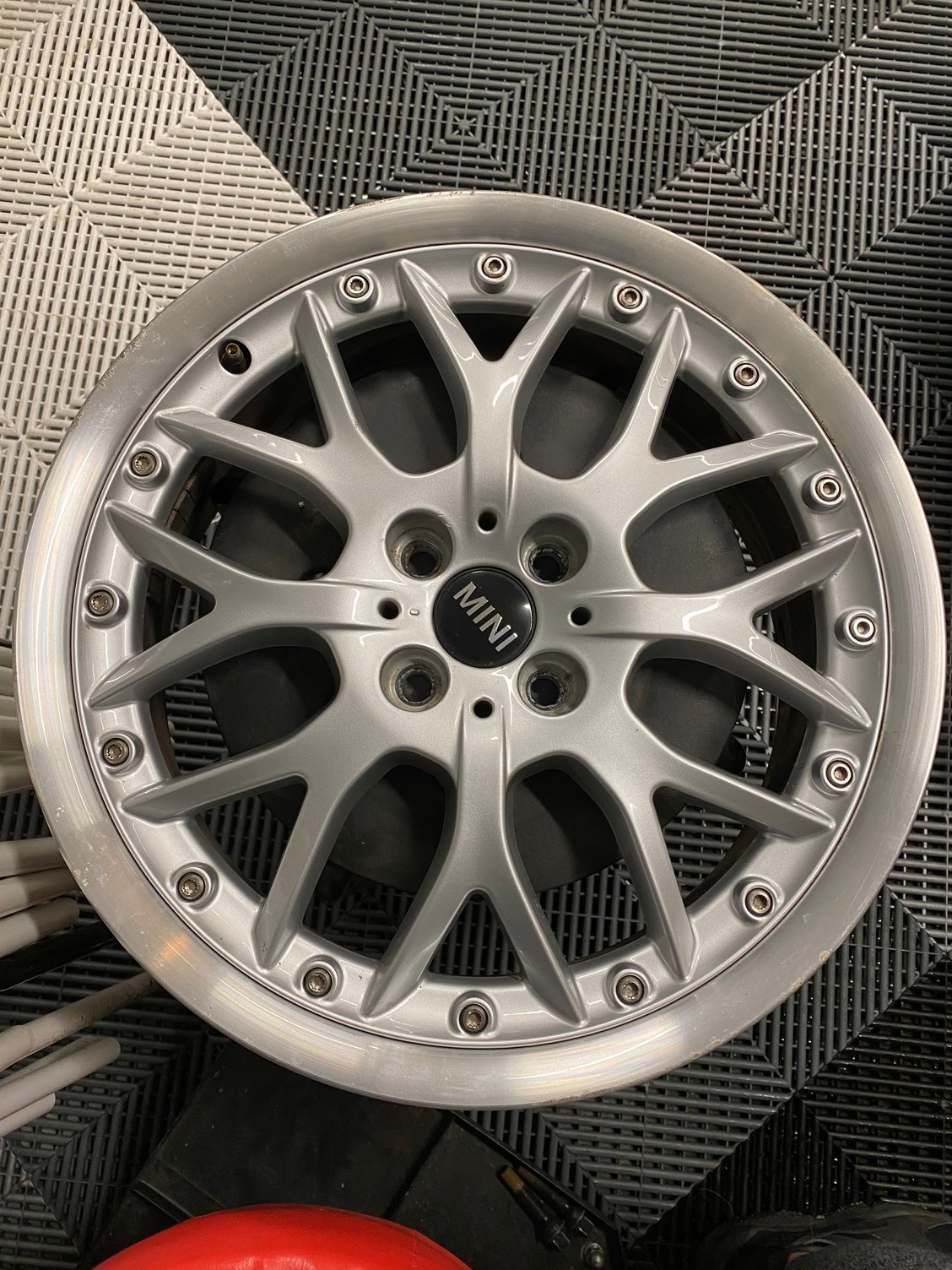

I began work on one of the R90 wheels tonight. The goal is to sand the clearcoat off the lips, evening out the curbing damage in the process with a 180. I'll go up to 1000 or so in stages, and once finished will polish the lip to a mirror finish. I plan to finish one wheel all the way so I can learn / master the process before starting on the others. It's my first time attempting to accomplish a mirror finish and I've got my doubts about being up to the task.
I only had an hour and by the time I was out of time I only managed one pass at 180 but I did get all the clear off. I don't want to dismantle them as I can't find new bolts for these wheels and don't want to reuse these originals. Working by hand it's possible to get right up to the edge of the faces, underlapping the paper between the face and the lip to achieve a perfect finish. I used a Dremel with a 180 pad to attack the curbing damage before beginning passes with paper, by hand. I could probably have done with something a little harsher to work on the curb damage which was deeper than I remembered.
Before - Most of the curbing damage was at 12, 10 and 8 o clock.
After - clear is removed and ready to smooth out to around a 1000 I guess?

Assuming you will use clear over the outer rim. Make sure you use an catalyzed paint as typical spray can clear will chip right off.
Reply 0
Jan 10, 2021 | 07:08 PM
  #166
Quote: Assuming you will use clear over the outer rim. Make sure you use an catalyzed paint as typical spray can clear will chip right off.
Hi Joe,
Is catalyzed the kind that has an adhesive agent in it too?
No I’m not planning to clearcoat the lips. They’ll be a raw aluminum mirror finish.

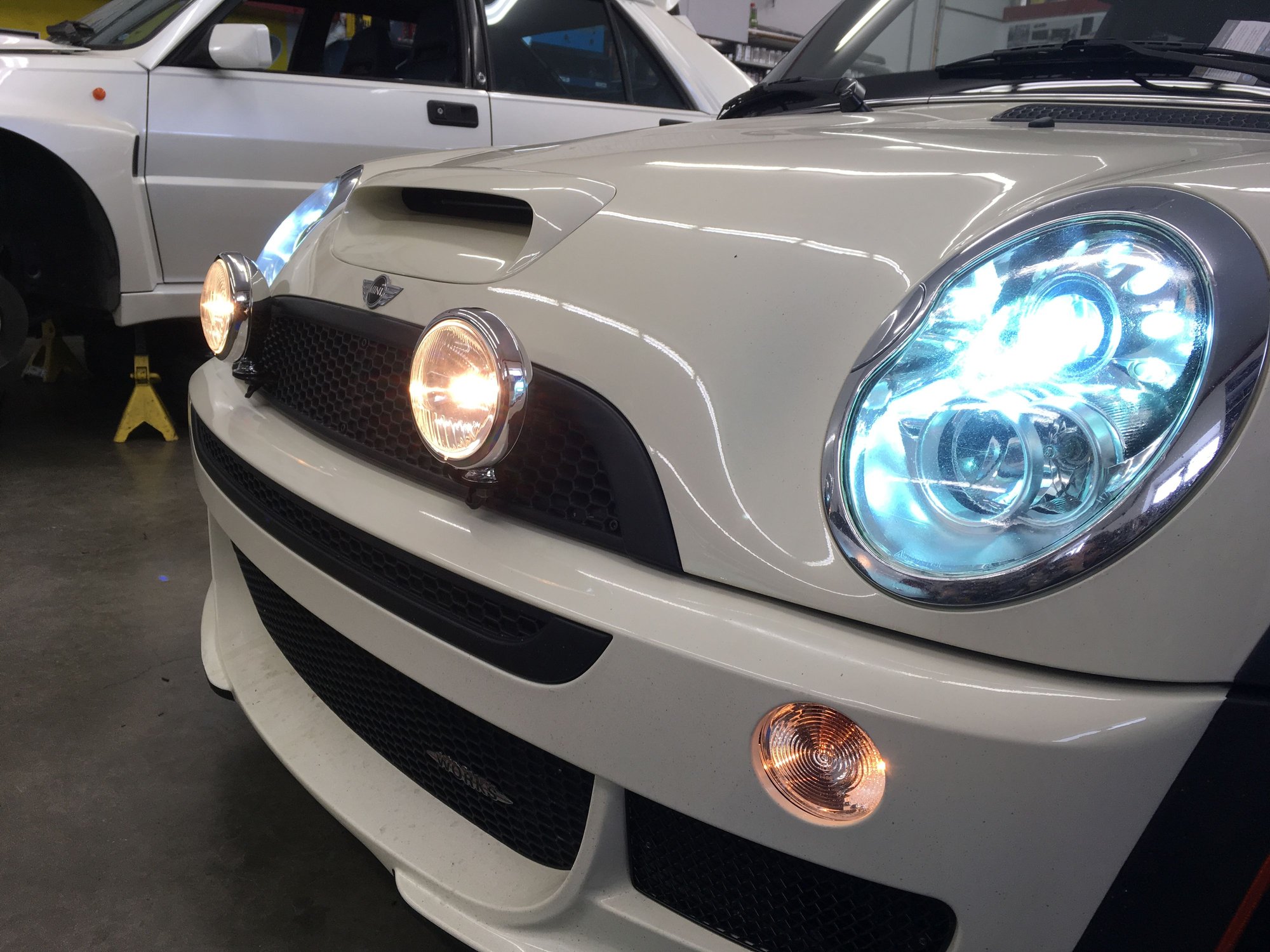

The rally driving lights, rear spoiler, front seats as well as the scoop and mirrors repaint are all done. I've made a couple of bold decisions here and there as it related to OEM/OEM+ so before I ware out my luck, I'm going to take a break from it for a few weeks, I'll come back with a fresh mind in February.
They are wired to the fog light switch in the centre stack and the trigger wire is off the ignition so they can be turned on without any limitations.

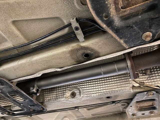

Installed a test pipe in place of the resonator. Had this done at the shop while they were modifying the spoiler. Pop Pop Pop!!!

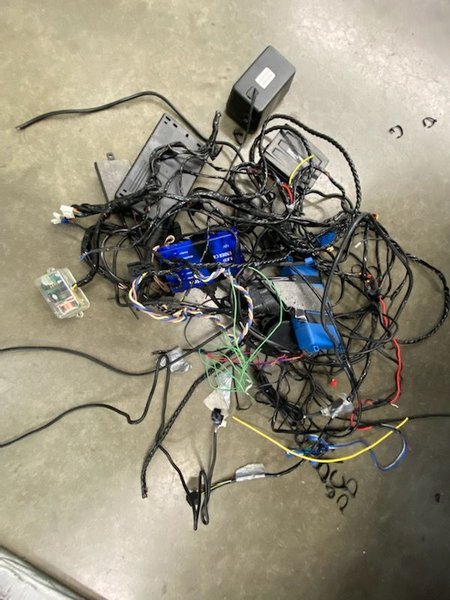

Pulled out all the garbage electrics related to the various aftermarket electrical items installed in the car back when it was new. Alarm / remote start / Bluetooth / navigation etc. There’s about 20lbs of crap in this pile!

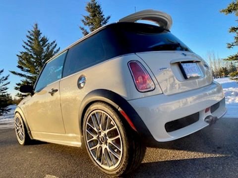

Jan 15, 2021 | 05:27 PM
  #175
A couple of pics as she stands today.
