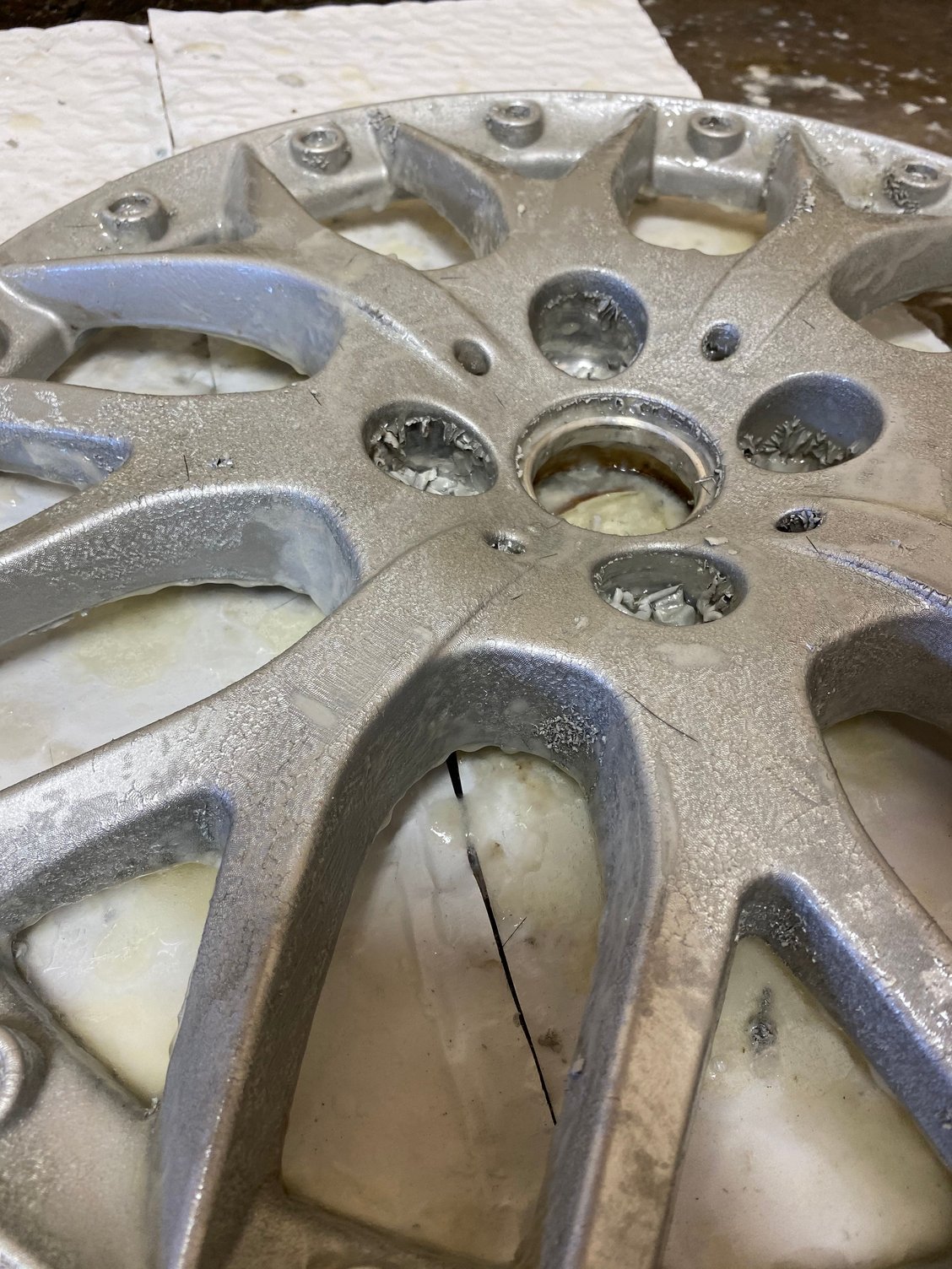

Heres a post from another thread (source for fasteners at bottom)
Only meant to have a good conversation and in with good intent/spirit among fellow enthusiasts.
For recoating ... I recommend paint over powdercoating unless you have a specialist in low-temp powder coating in your area with experience in high-tech alloys. Typical Pow-coat temperatures can 'over age' aluminum and remove the heat treatment often times.
Also... In technical/critical assemblies like these Ti bolts into the aluminum barrels ... I'm liking the Loctite/Permatex Orange high-strength Gel (it IS removable, without heat)... Seals the threads from galvanic corrosion as well if applied correctly. I prefer to use it without primer on chased/clean/degreased/dry threads (with no coating/paint inside threads) ... Using primer does not give enough time to run them all down and follow up with Torque wrench.
The blue thread locker used by BBS should not be confused with the Blue (242) Loctite... The BBS blue is high strength... the 242 is medium strength.
Originally Posted by mountainhorse
I've taken about 3 sets of these apart....
The machine screws are Titanium with mid strength LocTite type product holding them.
Better galvanic corrosion resistance than say plated steel or even A4/316 stainless... and lighter to reduce rotating mass.. though these wheels are pretty heavy to start with
I can see why they say only one time use... but many have done this and reused them.
I had best luck by soaking the rim-split area and the fastener-recess with penetrating oil for multiple days and re-applying each day. Then, using a hand 'hammer-strike" type of impact driver to 'shock' them loose... then I used a normal socket wrench and followed up with a small, low-torque cordless impact gun to get them out...Tedious YES... but ZERO broken fasteners and no stripped holes.... I soaked the screws in a cup of lacquer-thinne for a couple of days... and the thread compound fell off... and gave me a chance to inspect them well... cleaned them up with a nylon bristle wheel in my bench grinder... I don't suggest aggressive cleaning nor using a die on the threads to 'chase the threads' ... I did however chase the threads in the aluminum with a chasing (not cutting) tap.
After that... I used a good magnifier hood to visually inspect the screws... and saw no 'trouble spots'... though often fastener issue can't bee seen by 'eyeballing'
As an alternative.. you could go with a good stainless fastener with a small head like the ARP's which are a super high spec screw... but would also be expensive and weigh a bit more.
The wheels came apart easily... I marked them all so that the same faces went back on the same barrels.
Used a good urethane paint in Aston Martin "Arizona Bronze" color and a really high end clear coat that my buddy sprayed in his booth.
I did the polish lips as that was something that I could DIY... but the next set... I'm looking for a good shop that can machine them... they look the best that way compared to Polished IMO.
I'm not a fan of powdercoating high tech alloys like wheels... as I've seen many instances where the heat treat is changed from temps over 380˚ used in some ovens (AKA, 'over-aging") but many a wheel has been powder coated. Just make sure that the powder coater uses a low temp powder... Isn't doing many cycles or soak times... DEFINATELY NOT 'burning' them clean at high temps to prep them.... AND... Not coating your wheels with a bunch of steel fence posts for the local fabricator in the same batch... and you probably will be OK.
Source for TI wheel screws for the BBS/MINI wheels.
Singles or multiples of 2/4/8/16
https://www.ebay.com/itm/113279422177

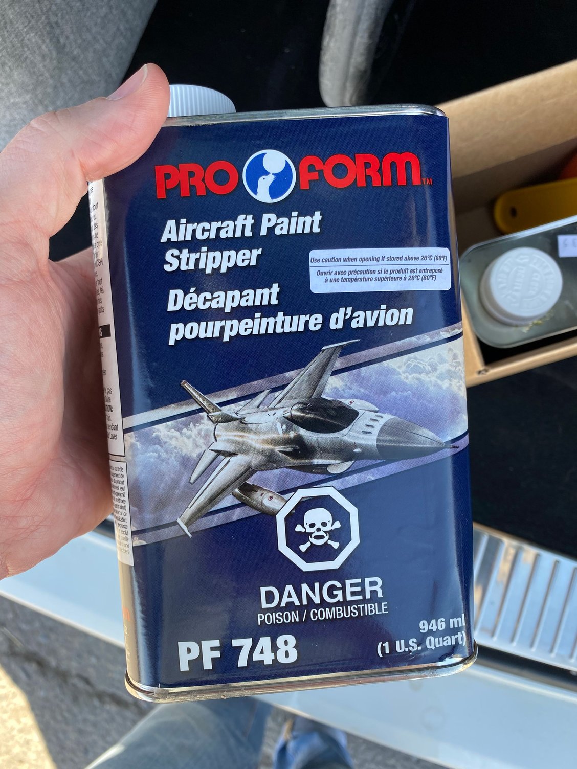

Originally Posted by jacktown
Yeah I changed my mind because I because really focused on the idea of clear coating directly over a clean, well prepped raw aluminum. I think it’ll be quite challenging but with the right technique I’m hopeful to achieve a really great result.
Non Meth-Chloride remover... which is most commonly avail today.... is a bit 'weak sauce' for the coating that has been on there for years and baked by the heat of some hard braking downhills I'm sure...
Your local body shop supply should have full Meth-Chlor stripper available that will make short work of that... Temps 80˚ to 90˚F (26-32˚C) makes a big difference from just 10 degrees cooler... paint and coatings just fall right off.
I've seen some people bake-off the finish at 500˚F... but that would absolutely ruin the aluminum structurally.

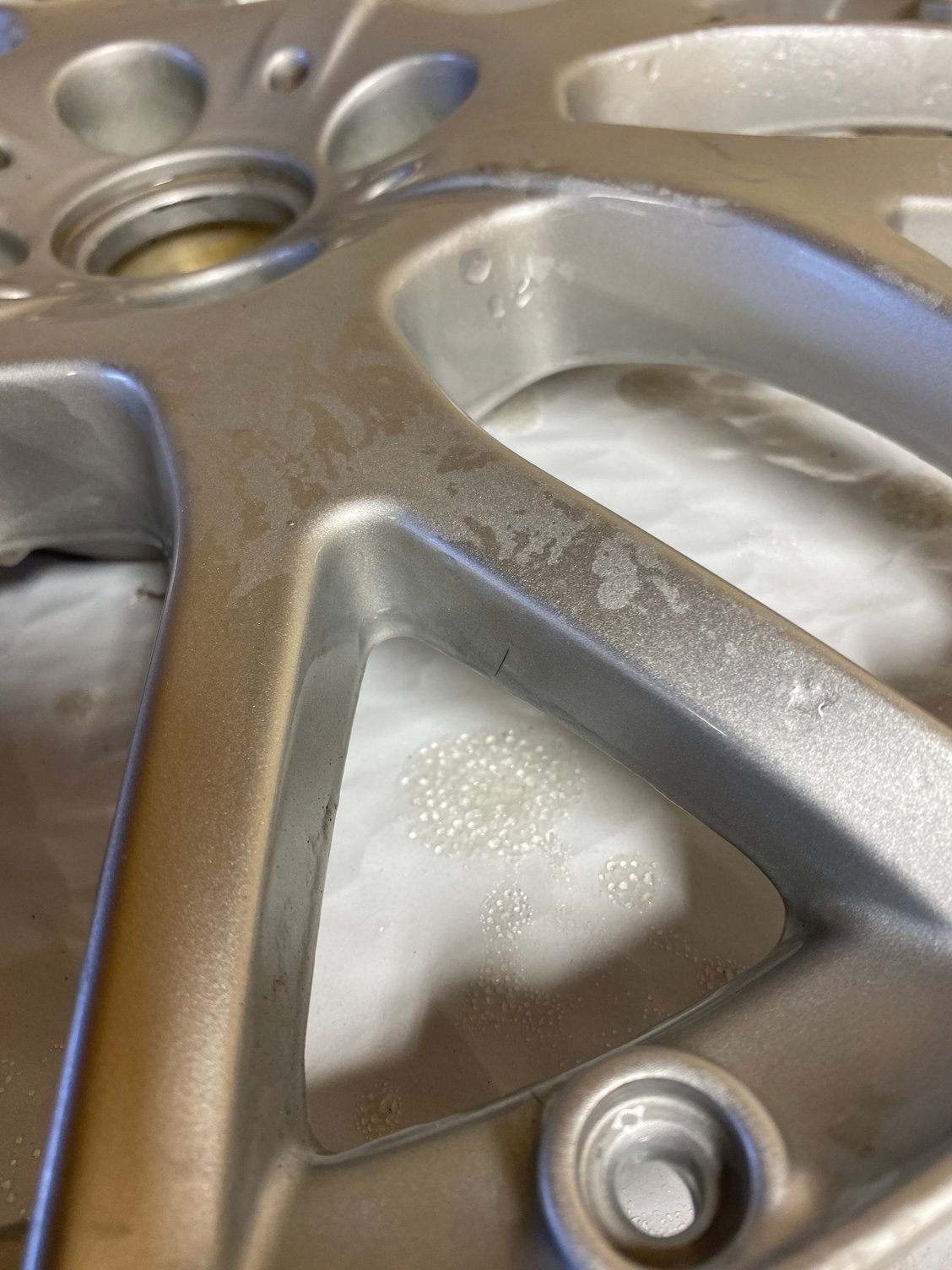

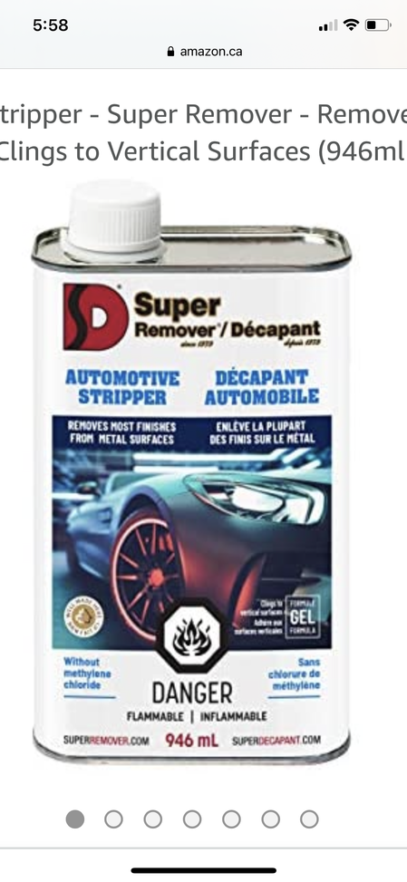

this is great advice. Everything I found on Amazon was the method chloride free stuff. I was starting to think that maybe the “meth” stuff isn’t approved for use in Canada. It’s been a long time since I was able to hit up my local body shop supplies store but I think I’ll try to make a trip down there tonight.
to prove your theory - look at the weak sauce job this meth chloride free stuff did after a full 24 hours when I rinsed it off this evening.
Thanks for the other posts too. Good to know I can source those bolts if needed. QQ - is that orange thread locker in your message the best stuff for me to use?

Update: Thanks to @mountainhorse I bought this nasty stuff! Look what it did with one coat and 10minutes of dwell time.
public service announcement: If anyone reads this and is planning to do the same, I recommend you wear goggles, a very good breathing mask, as well as a full face shield. Make sure to use extra full sleeve protective rubber gloves and make sure all your skin is covered)

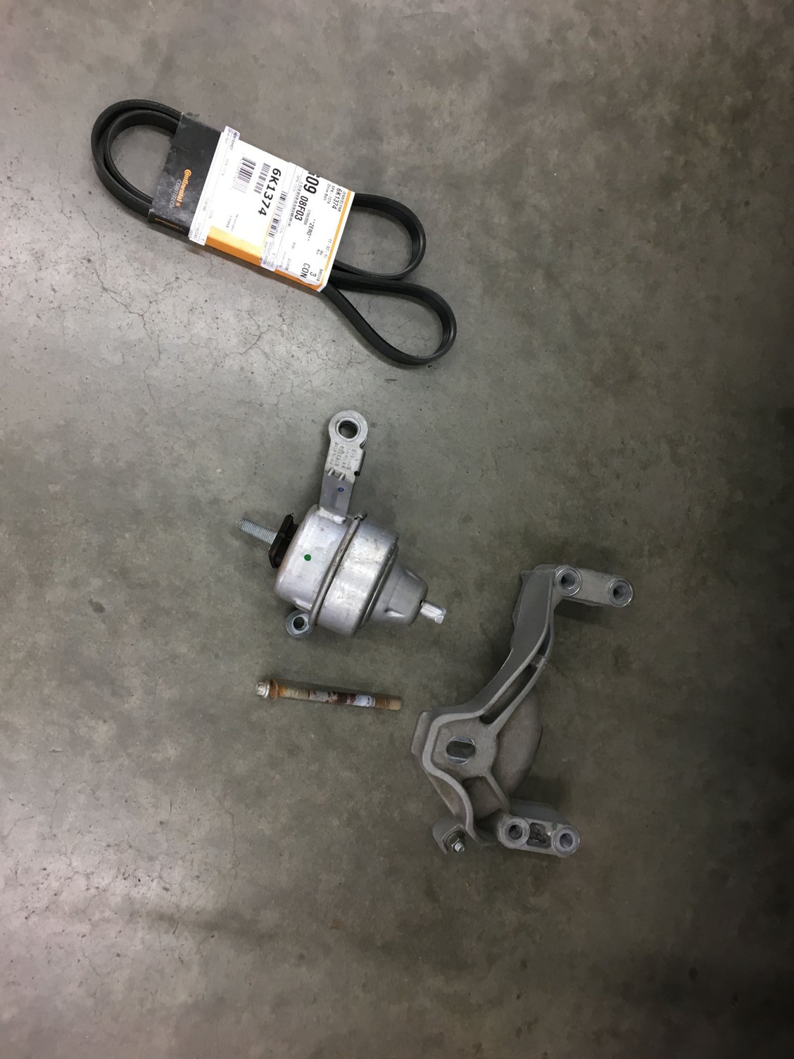

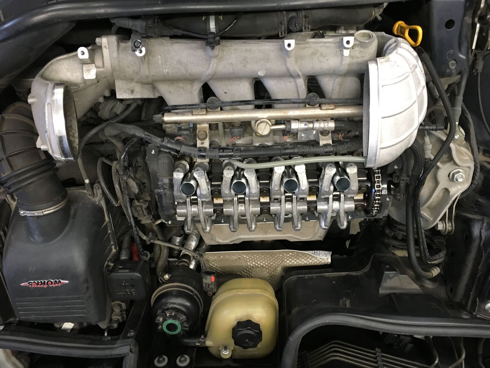

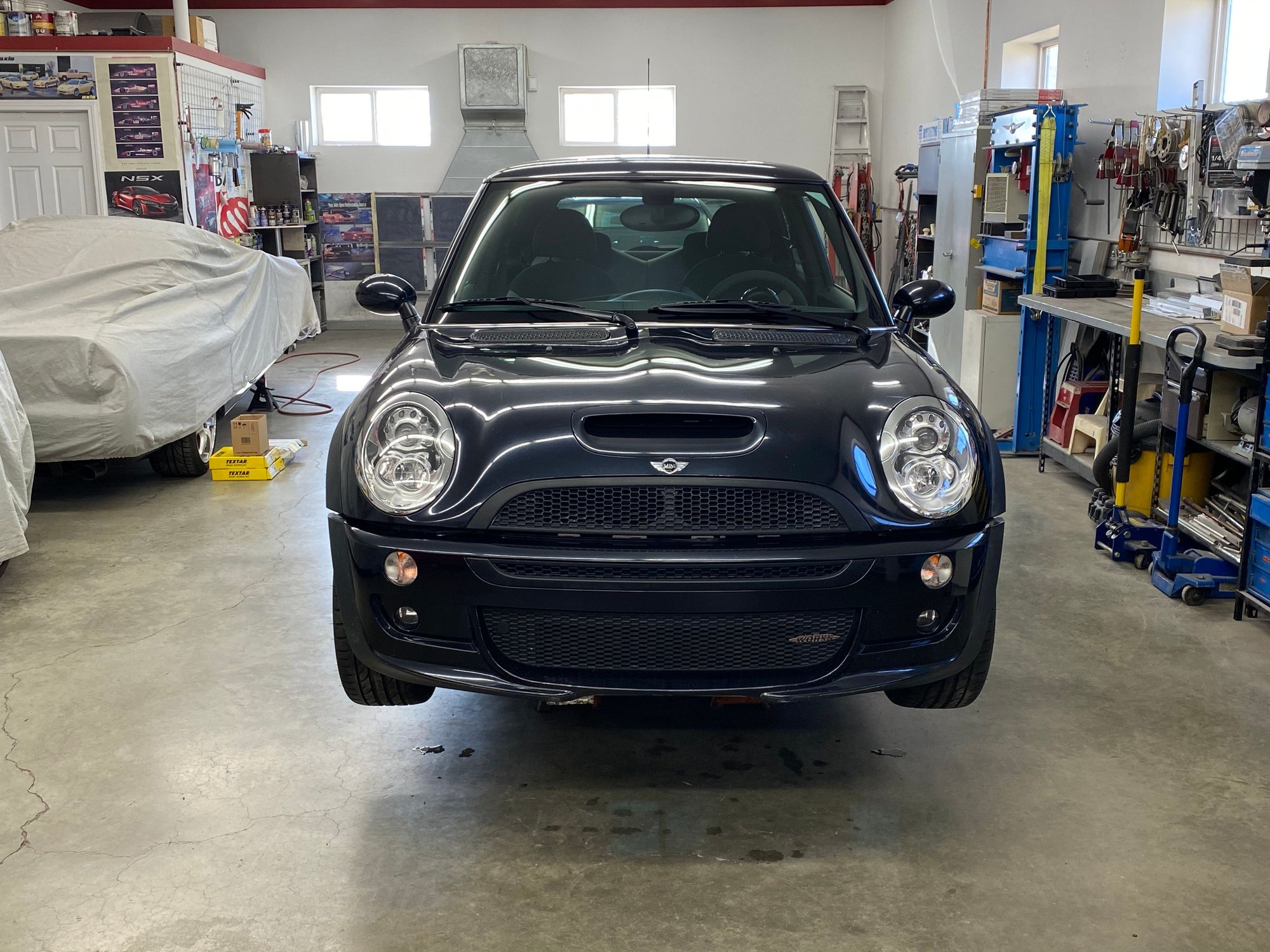

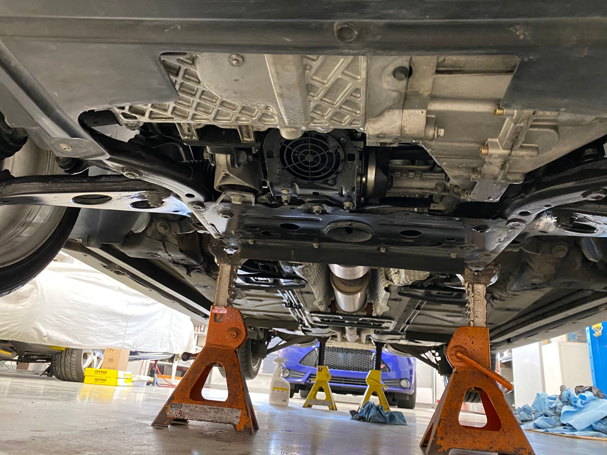

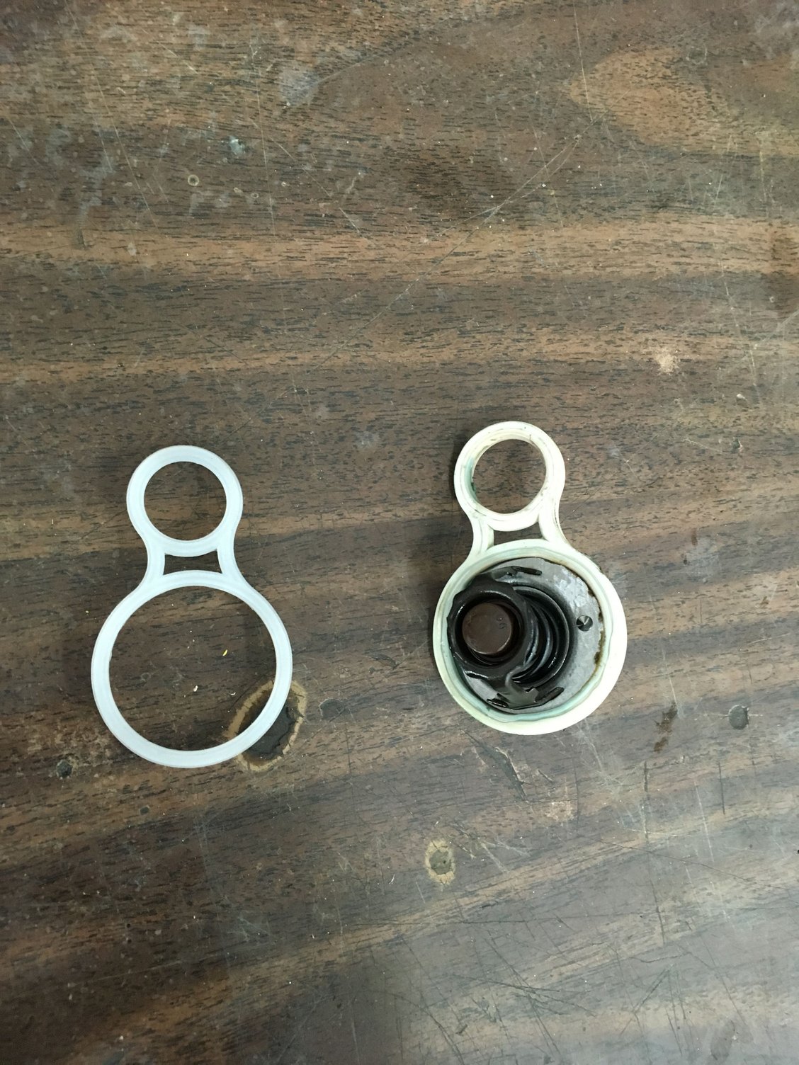

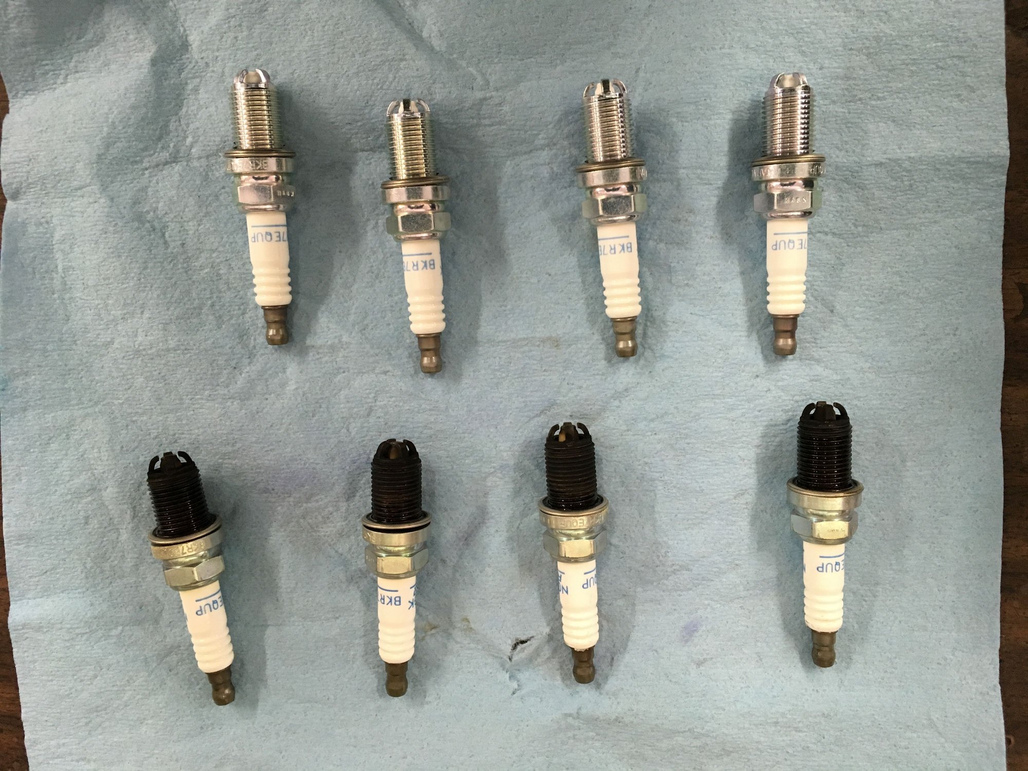

Still working on the Competition Edition - from here on dubbed sixty-four.
Head looks great
New valve cover gasket
New serpentine belt and passenger side engine mount

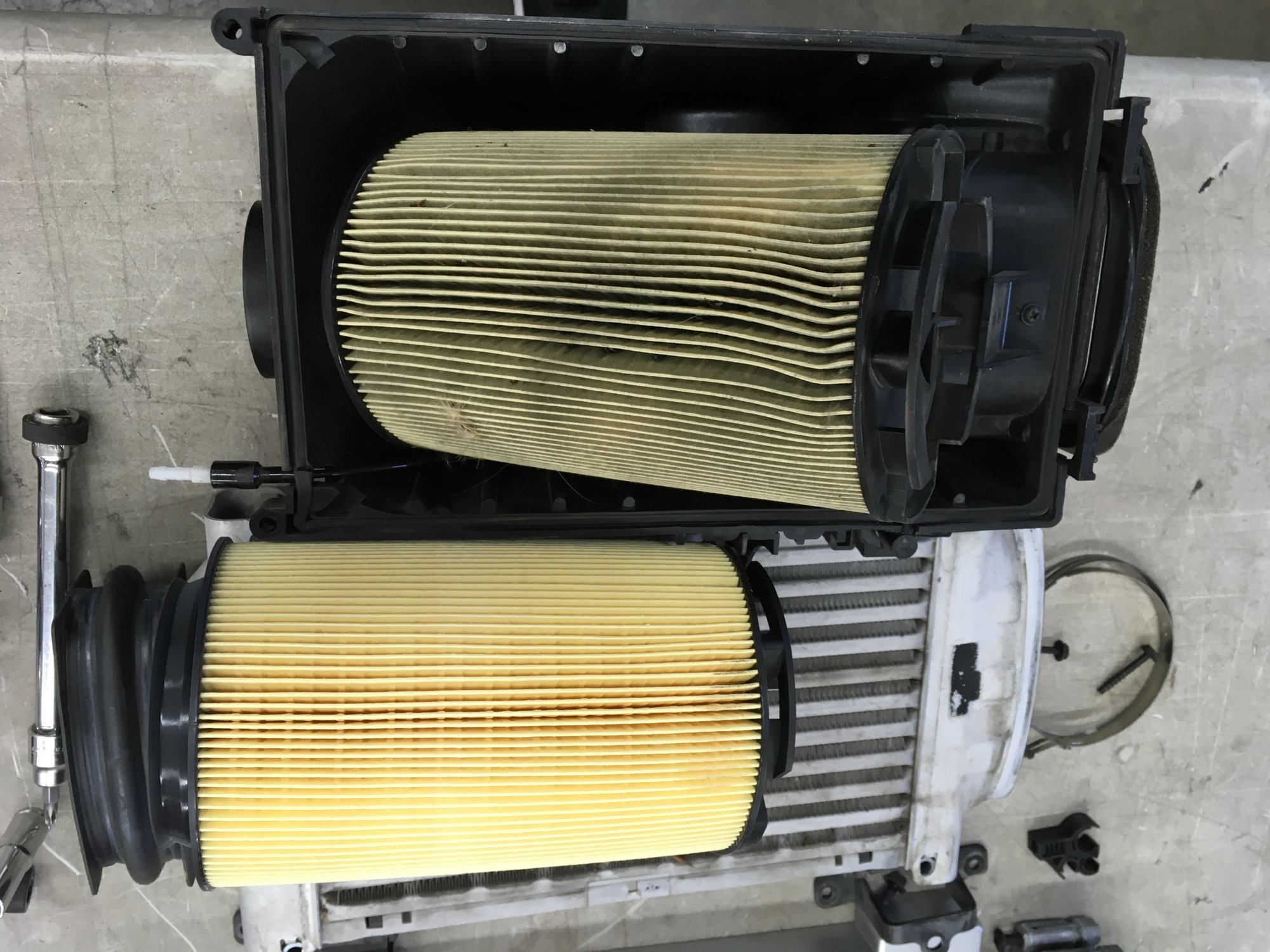

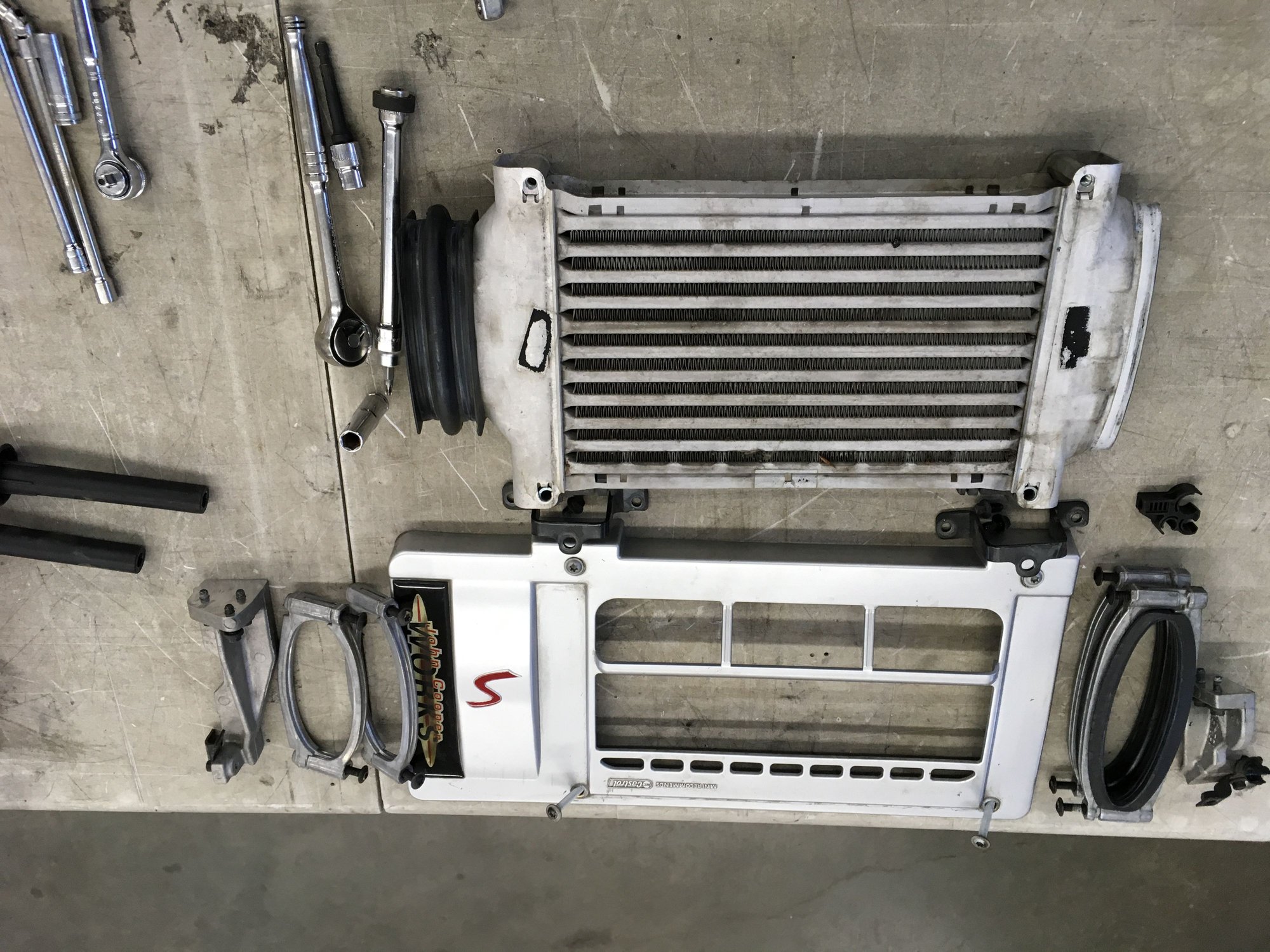

I’ll give the intercooler a good clean before it goes back on. Is there anyway to get a new JCW sticker for the intercooler cover without buying a whole new replacement cover?
New air filter. Will also be doing the cabin filter.
New plugs

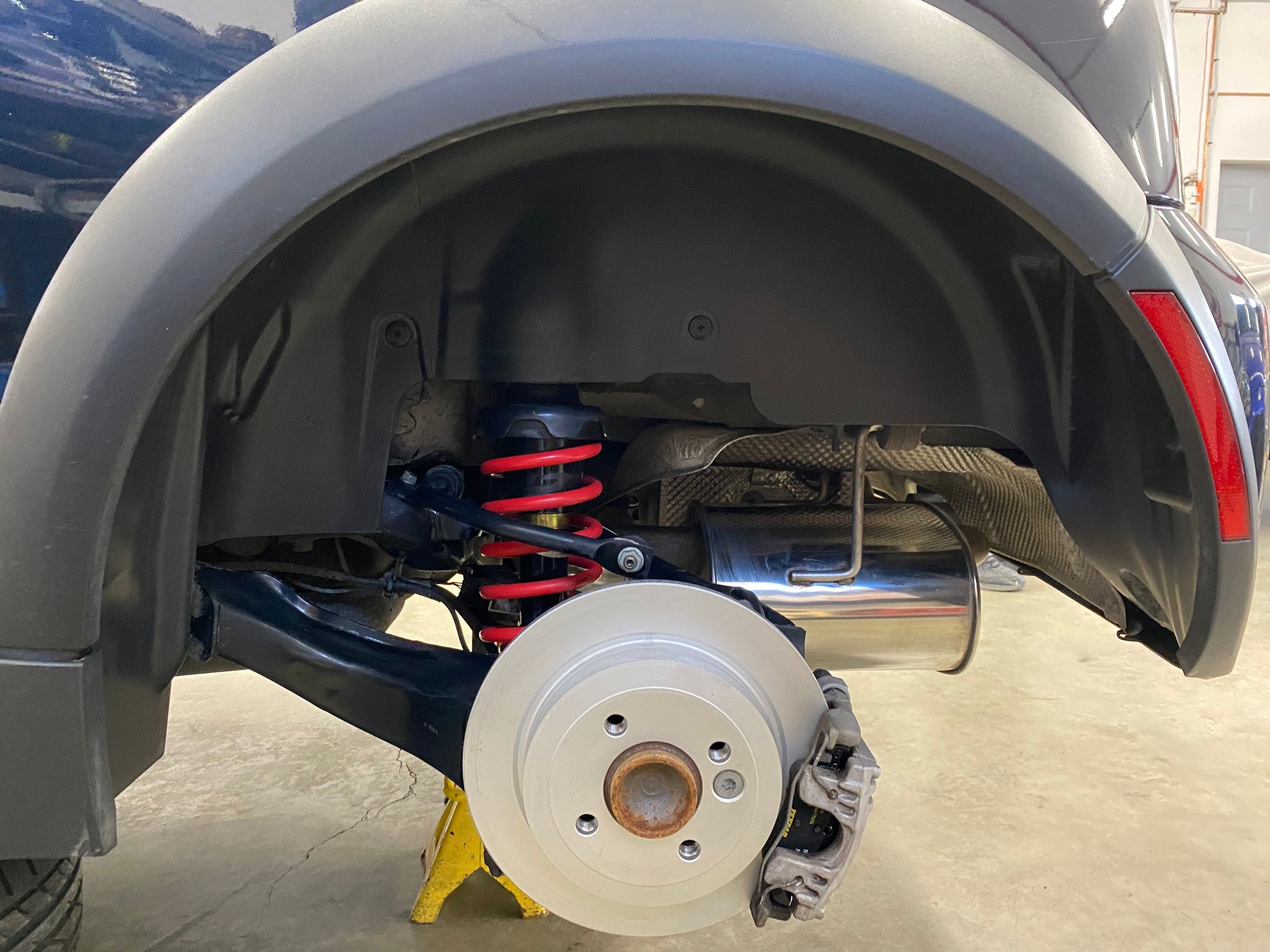

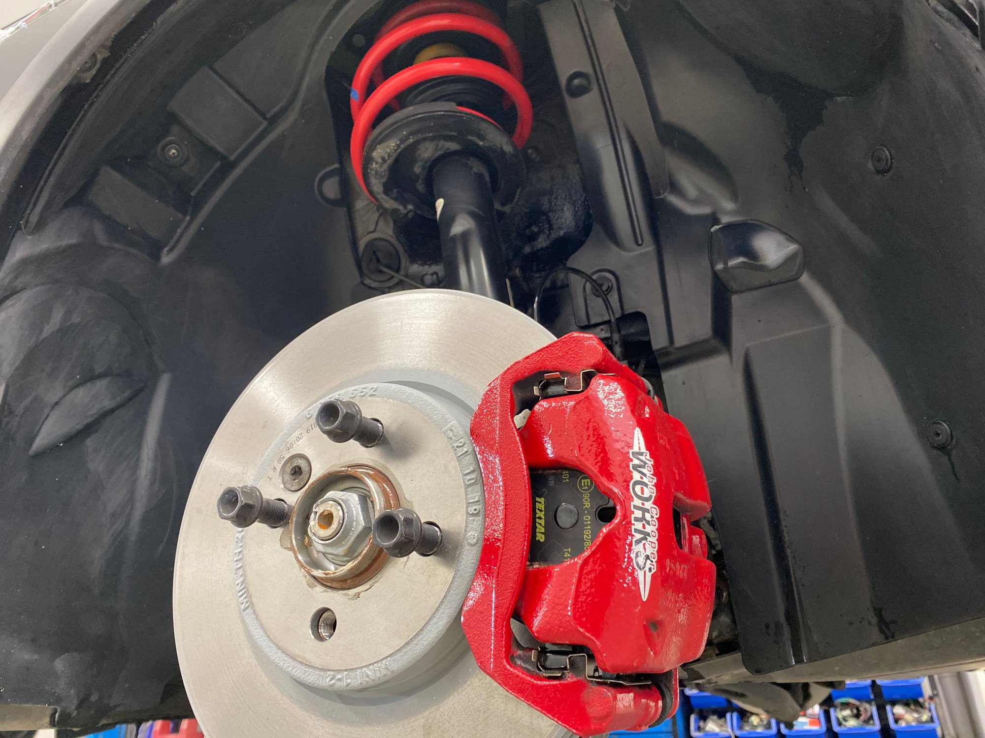

New brake rotors and degrease, wash and wax of all wheel well components and fender liners
Polished the exhaust cans. I have a little more work to do under the car which I’ll cover off this weekend
But overall this thing looks amazing from underneath. As close to a time capsule as I’ve seen
Soon I’ll get to work on a paint correction but first - the 3M film needs to come off.

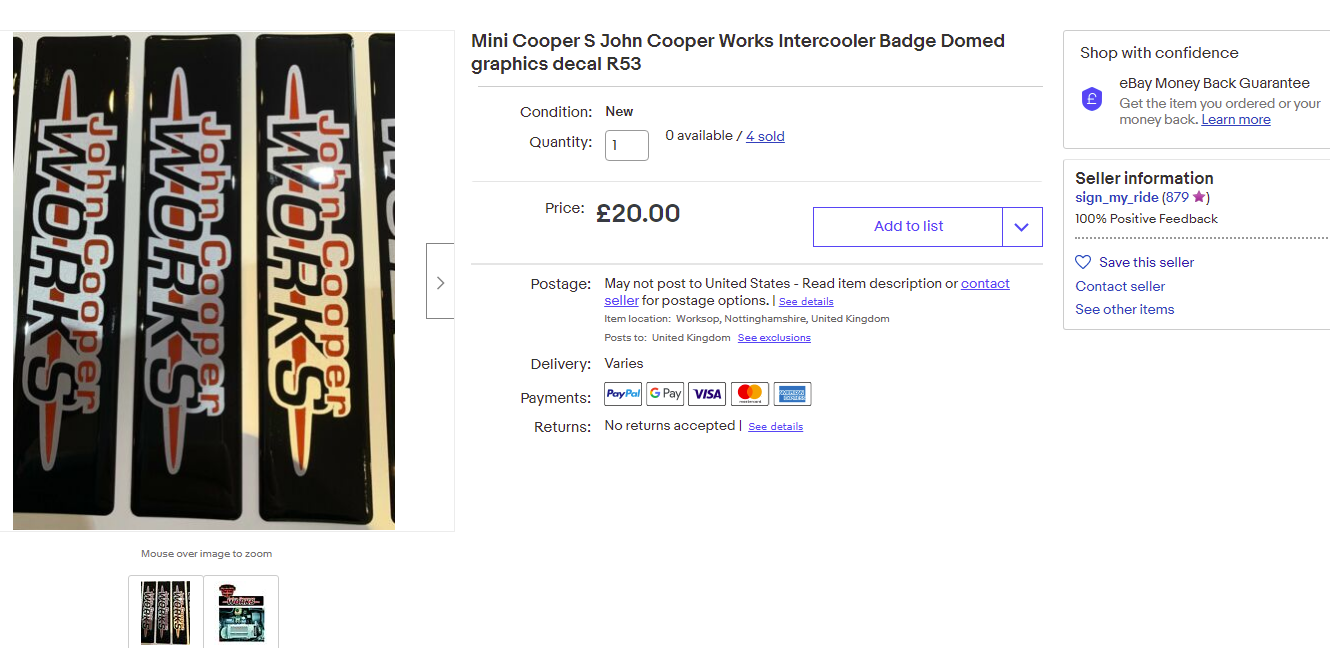

As for the JCW sticker on i/c cover, there was a seller who had repops recently and they appeared to be of somewhat good quality,
but may have been a limited run as I notice they're not listed any more.
If interested, perhaps contact the seller?
https://www.ebay.co.uk/usr/sign_my_ride

Originally Posted by Oldboy Speedwell
Love this thread!
thanks so much for the tip! I’ve reached out! While floating around on eBay.co.uk I purchased a nice JCW brochure too. A little addition to the binder for this car. I’ll report back for anyone who’s interested in the status of the above stickers.

It’s great see the attention to detail you put into your builds and someone is going to end up with one of the best Competition Editions once you’re done with it.
The JCW IC cover decal above looks like the only option out there right now, but the logo is a little off in terms of accuracy. Hopefully you’ll be able to find a clean factory cover or a domed re-pop with the correct logo in the future.

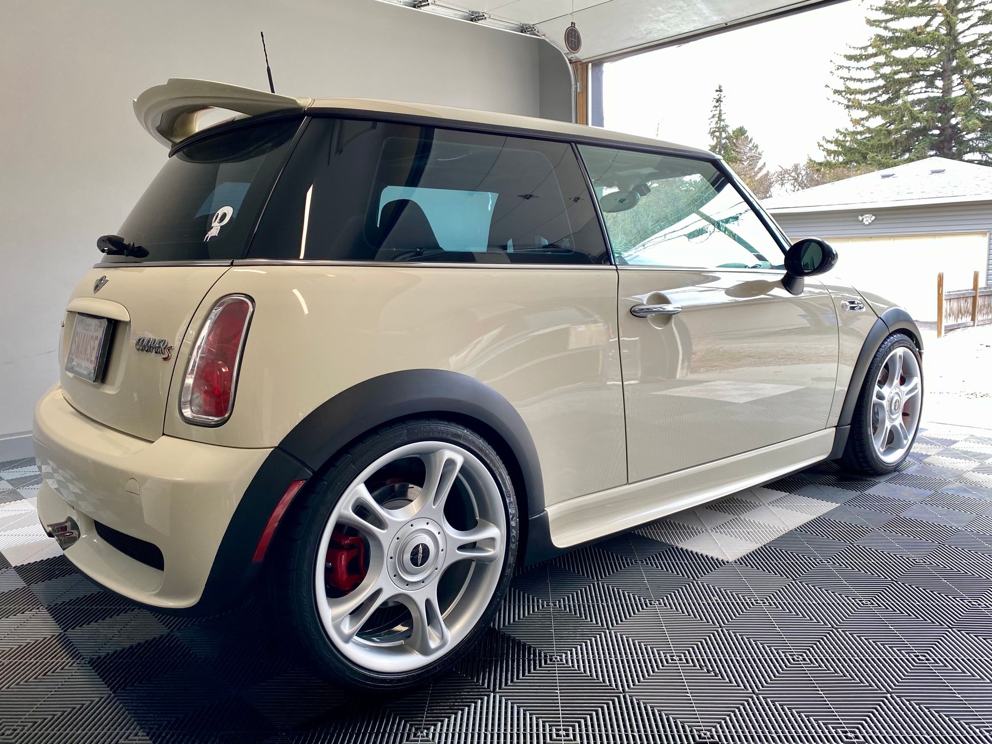

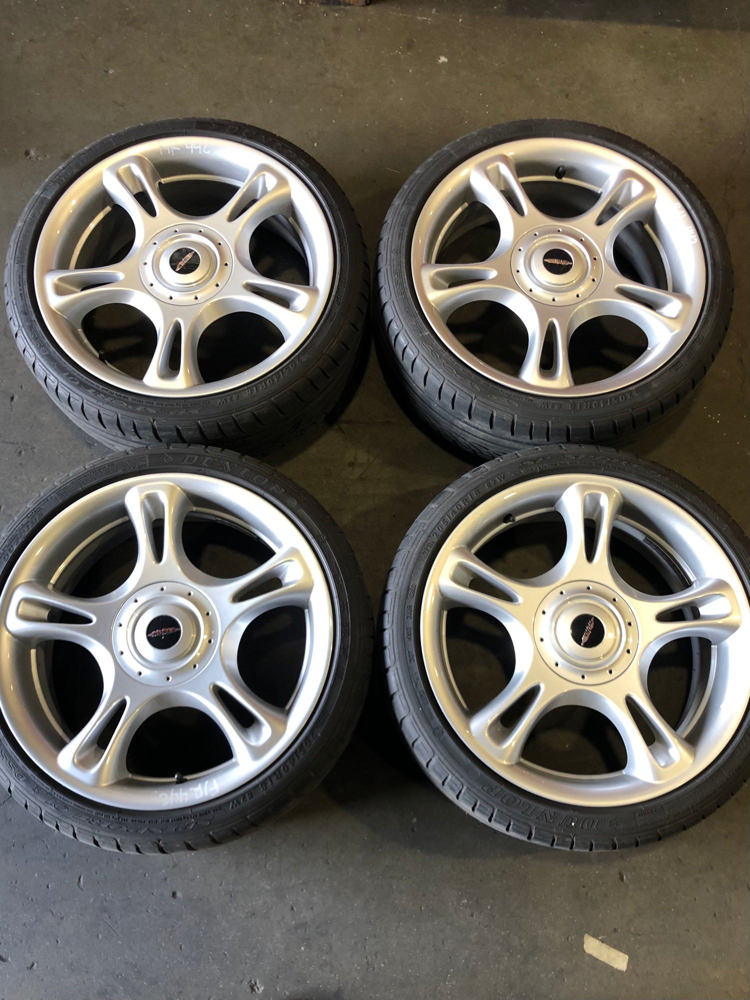

I couldn’t wait. A quick test for of the R95 wheels turned in to a test drive. I really love them!
I must re-logo the front callipers soon.

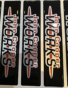

jacktown's Avatar
jacktown
Joined: Aug 2013
Posts: 179
Likes: 165
Originally Posted by RB-MINI
They look great!
Where did you have those made?
autom.accessori on Instagram. He was advertising the JCW logo and I asked if he wouldn’t mind also making a few different colour cars for me. He was nice enough to mock up some designs. I ended up buying quite a few different colours and don’t need them all so if anyone wants a white, black or green version I’d be happy to sell them to you. DM me.
