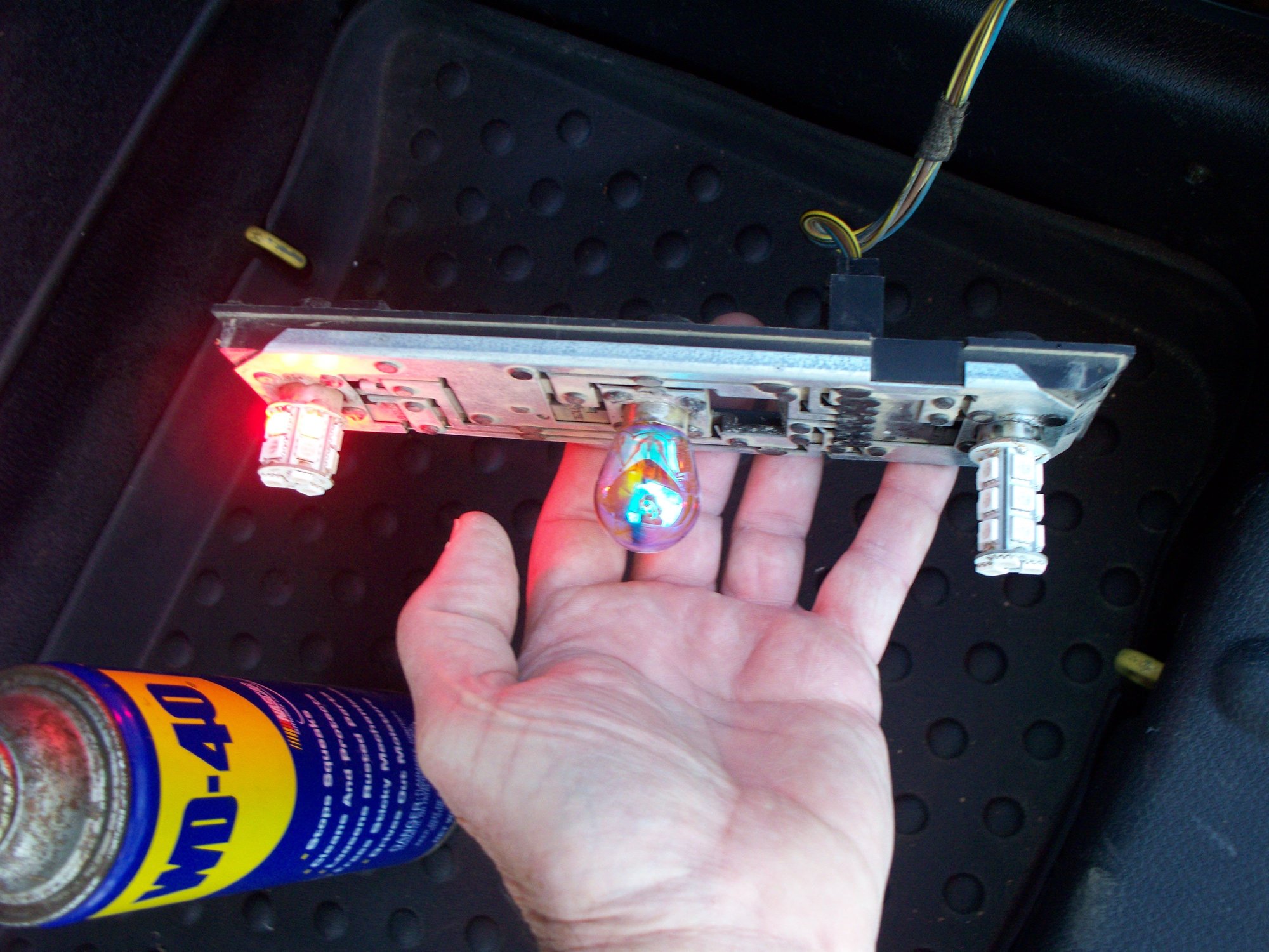

I am guessing my white lights were not factory installed because the rear fog lights did not work. The rear fog light toggle switch lights up yellow on the tip with the running lights on, but the rear tail light upper parts did not come on in any of the front fog, running light, or headlight combinations. I removed the fog LED and checked it with a 12V source and it lit up fine. I cleaned the contacts in the fog position with emery cloth and cleaned the main connector with contact cleaner, and the rear fog lights still did not light up with the switch on. I checked the voltage at the fog lamp center contact and it was only 5.2 volts. Folks on the mini forum said the rear fog circuit(s) come directly from the General Module Control Unit behind the right side passenger panel with no fuse or relay in the circuit. I took the left side lamp holder inside and measured 0 ohms between the main connector rear fog pin and the fog center contact, and applying 12V to the pin with the lamp in place lit the lamp brightly. So… why are the fog lamps getting just 5 volts? I checked resistance between the fog center contact and lamp holder ground with the main connector connected and it was infinite. I measured 0.5 ohm between the lamp holder ground and a body stud. I never did figure out why the rear fog lights were only getting 5 volts with the switch on, so I did the brake/fog light modification using two radio shack diodes bent to push into the #1 and #4 wiring spaces in the tail light connector. The diode allows current to pass from the brake light circuit to the fog lamp bulb but not the other way (in case I ever figure out why the fog lights are getting only 5 volts and not voltage enough to light the LED lamps). The diode leads pushed a lot farther into the connector than I had expected and there was no need to shorten the diode leads at all. I wrapped the diodes and the end of the connectors with electrical tape after they were pushed in and the operation checked. It helped to have a 12 foot pole to push the brake peddle from the back of the car to test the operation at all stages. Now I have two sets of brake lights in the lower and upper positions and I try not to drive in heavy fog.

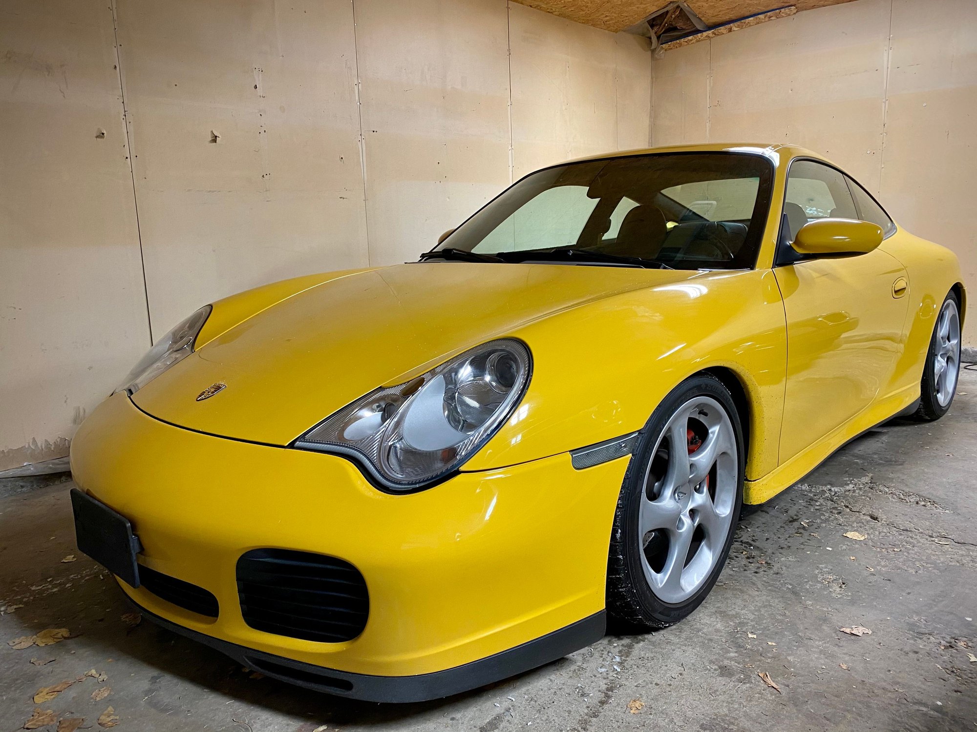

The yellow car is a 996 C4S and it’s going to be my winter weekend warrior. It’s seen both coasts and everything between a few times and has the scars to prove it. I plan to get her back to a better standard and see how many miles she can take.

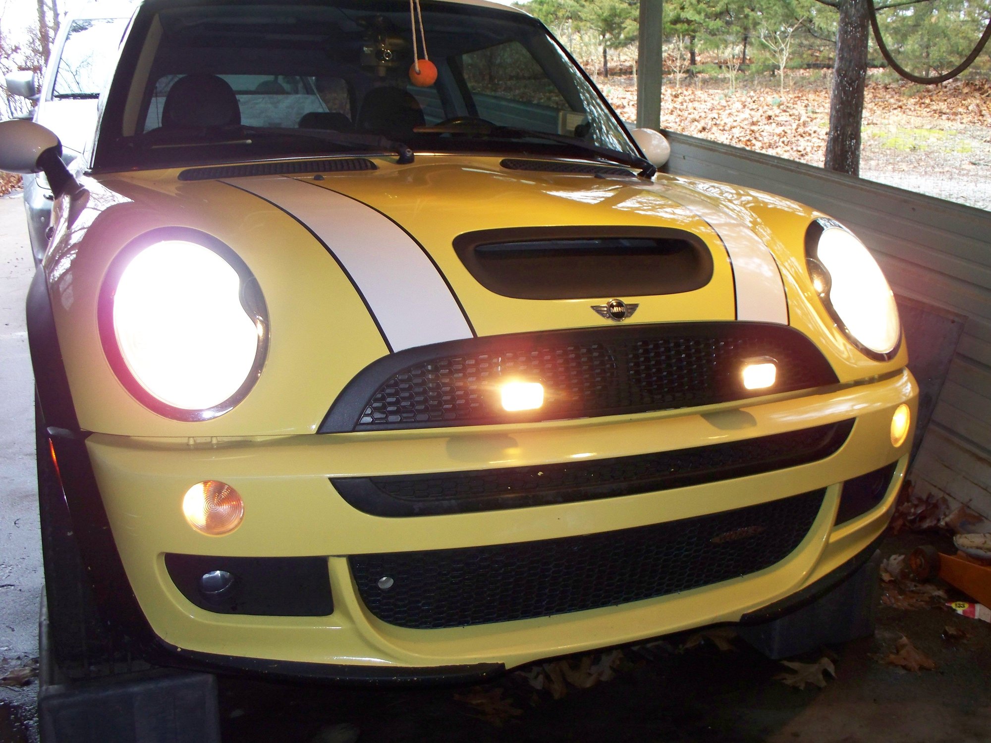

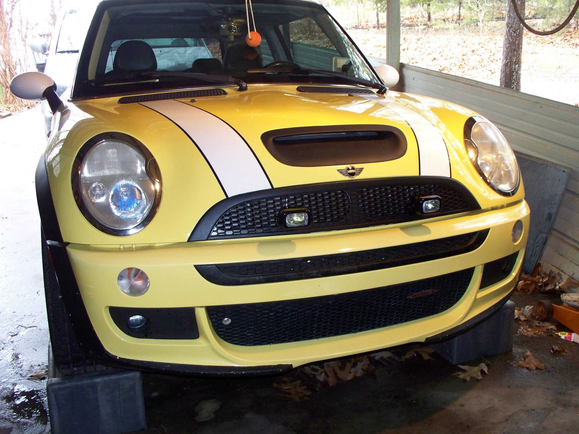

"The yellow car is a 996 C4S..." Sweet ride! A Tweety Bird on steroids!

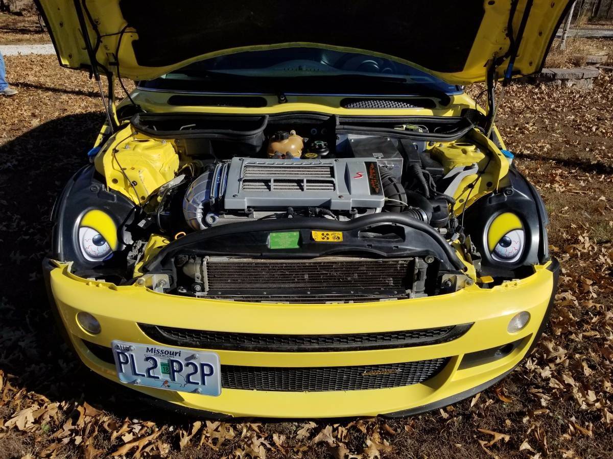

One of our British Car Club members named mine when he asked if I was going to be driving that Tweety Bird on a club drive. The name stuck.
Oh, and this photo from the PO's Craig's List ad with the eyes caught the fancy of my bitter half when she agreed to "let" me buy it.
Well, that and a promise to upgrade her 99 Dodge Grand Caravan to a 2010 Odyssey Touring.

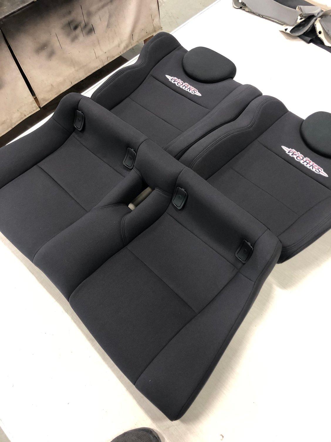

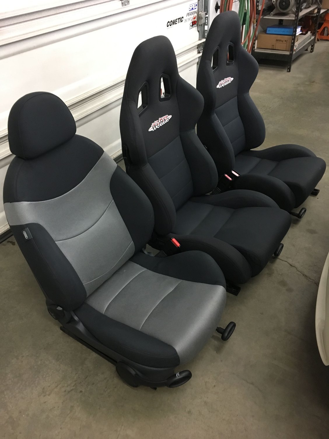

Ok back on track with the Pepper White content!

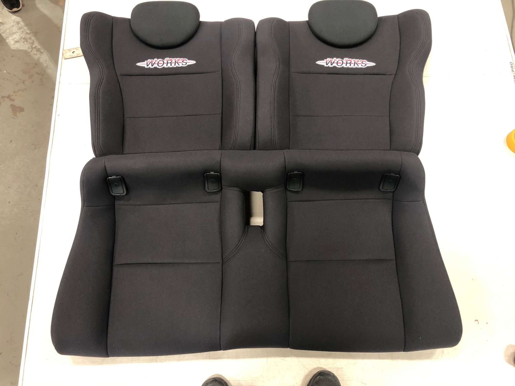

The last couple of days I picked up some neat things. Gen 1 JCW caps for the R90 wheels, a new front JCW badge as mine is road-rashed and in the wrong position from the previous owner. The bolts on the back are seized and try as I might, I can’t try any harder without risking breaking them so I figured it’s a great opportunity for new. I also have a set of cabrio braces on the way.
All of these are really neat finds but they can’t beat my excitement for the job that got done on my old 2 tone rear seat.
I’m so happy with these from top to bottom. I’ve never ever seen a set of the black cloth rear Sparco seats so this is the first time in this project where I’ve taken an OEM item and replicated it because realistically, I’m never going to find a set for sale - and even if I do, there’s a strong likelihood they’d need repair in any case. There was a lot of custom foam work required and so pound for pound, they cost more than they’re worth considering they’ll
likely never be sat in...but I’m sure there’ll be a day where my little girl tosses her school bag on them 😂
The originals didn’t have ISO Fix adapters (I guess one of the reasons many didn’t option the rear Sparcos with the front Sparcos) so I thought it would be a fun design choice to maintain them in the new design.

Great looking seats! Is there any JCW option that you don't have yet? Folks will know it is a JCW from every angle, inside and out.

Those rear seats - I’m speechless. Wow.

I look forward to hearing the backside review of the seats once installed. Backseat reminds me of the backseat found in a 190e 16V. They definitely look the business.

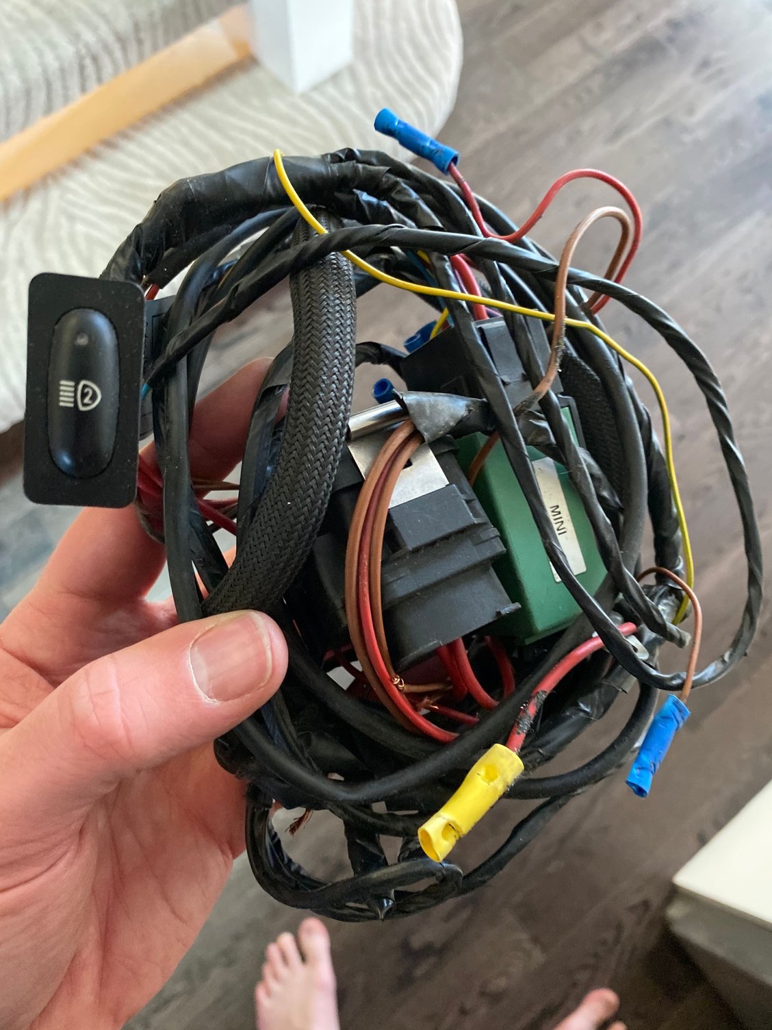

I've also received this used electrical harness for OEM driving/rally lights. I already had a brand new harness and I bought this (here on NAM) purely so I could get my hands on the switch (which is no longer available) I'm going to try to find time to install the driving lights this week too.

I've never understood the stock placement of the rally light switch putting it down by your knee where You can't see it and have to find it by feel while driving. And then you can't see if it is lit.
Whoever installed mine did not leave enough slack in the wires so every time I drop the under scuttle it comes unplugged. I hope yours has enough wire to let you drop the under scuttle.

Funny you should say that. I've deleted the fogs as mentioned earlier in the thread. I never replaced them with anything so for now they are 'unfinished' brake coolers. Before I came across this switch I had planned to wire the rally lights to the fog light switch which is mounted in the centre dash. I think I'm still going to do that, and I'll just use the OEM rally light switch as a dummy. If I'm very adventurous I might wire it up so both switches work.

Alternately, you can mount the rally light switch in the center console, just opposite of the TPMS sensor. That’s how I have installed. There is an OEM cable available which extends from the dash down to the center console.
Using the fog light toggle is an interesting idea too, and will allow you to run the spotlights without the high beams. Easy to set that up with a relay.

I picked up the factory extension harness mentioned above here for $2.50, but it's now on back order.
https://www.ecstuning.com/b-genuine-...s/61120412968/
Were you planning on using the front fog toggle or the rear? Using the wire/signal from the front toggle will make the rally lights work with the parking lights or low beams, but turn off with the high beams. Not sure if the rear fog also turns off with the high beams though.

I think I’ll order one of those just to have it! (I don’t plan to wire it to that location however but who knows - I might be working in another car in the future and fancy wiring them in an alternate configuration) Never knew about that part and appreciate you pointing it out.
You raise an interesting subject. I’d like to control my rally lights from the fog switch and I’d like to be able to control them independently of any other lights.
My order of priority would be:
1. They must function with low beams
2. It’d be nice if they functioned with high beams too
3. I’d get a kick out if it if they could function without the headlights because I prefer when switches aren’t reliant in other functions to operate.
When I removed my Fog lights I preserved all of their wiring in the engine bay. I think I’ll splice the used wiring harness I bought and connect directly to the old fog lights to get the desired functionality.
