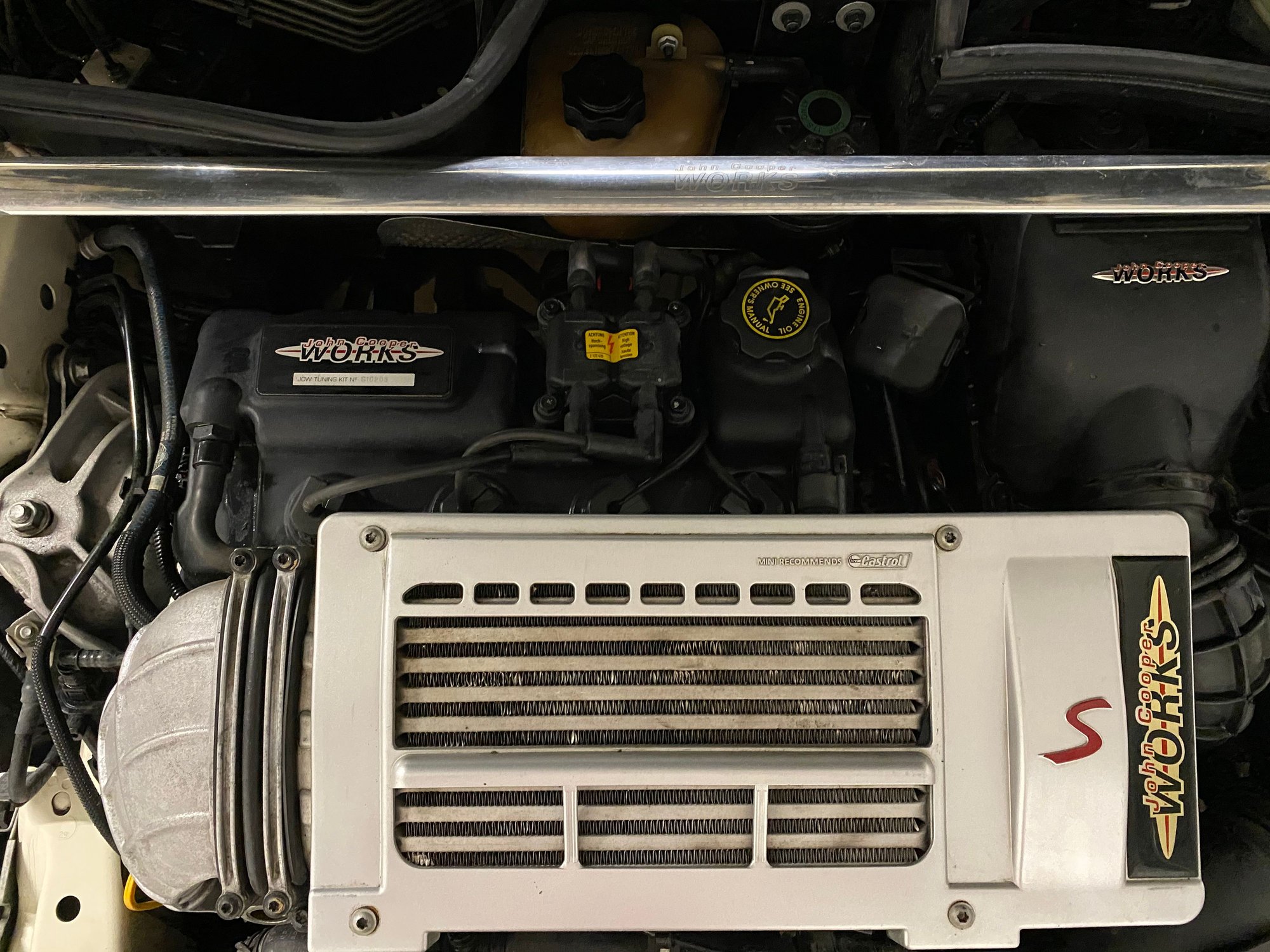

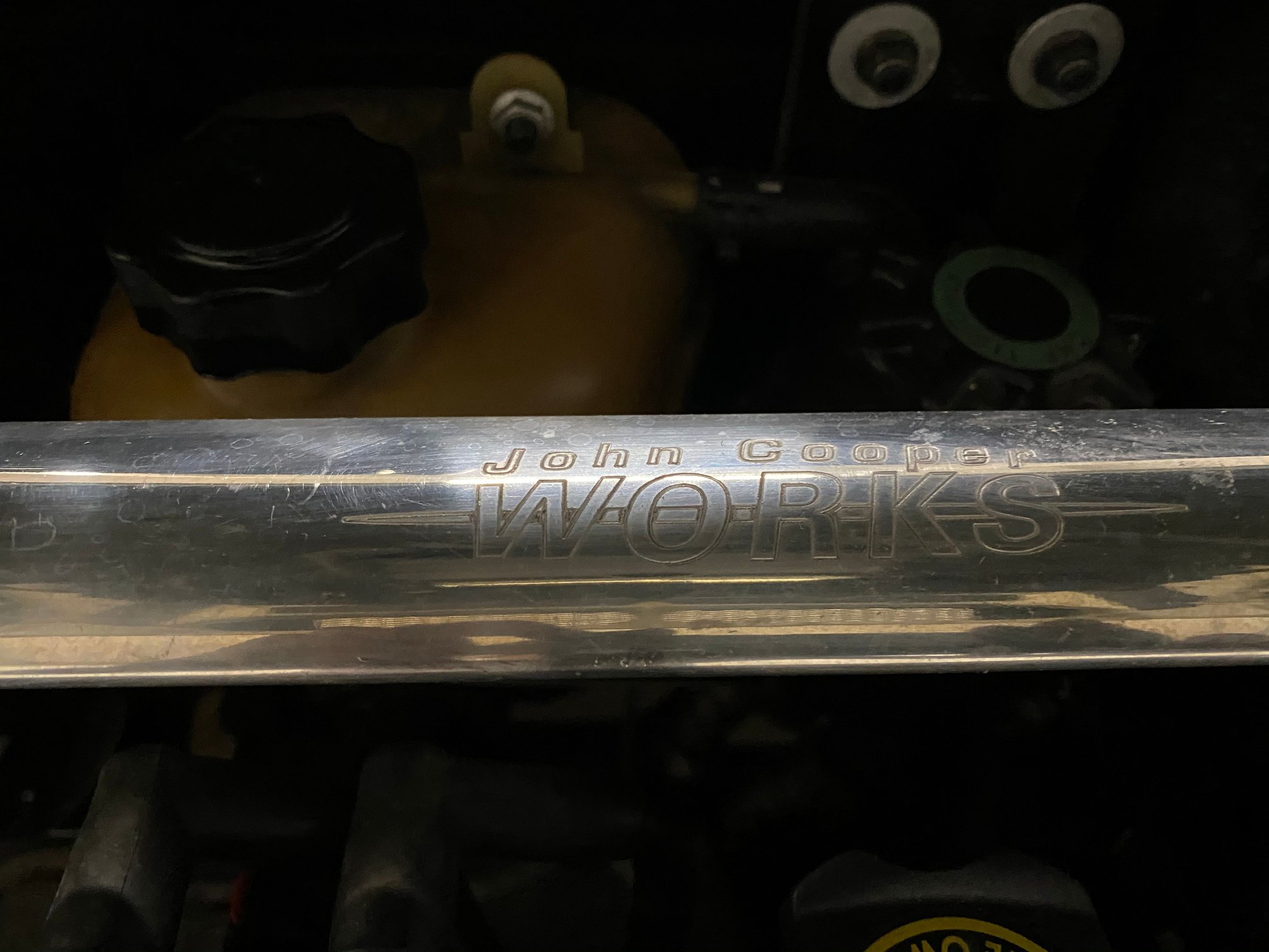

Originally Posted by Hartz
Is that strut brace "a thing?" I had a similar one on mine, but it was kind of pitted and stained, and frankly, a PITA to work around when doing any kind of maintenance. I swapped it out for a set of reinforcement plates. But if it's some kind of rare JCW part or something, I might get to work on polishing it up and rethinking things.
Yes, it looks like an actual JCW strut brace, but the pic isn’t clear and the bar is really dirty so I can’t see the logo in the middle of the brace. If you have one and don’t like it you could probably sell it easily here on NAM.
Jacktown, do you have pics of the interior? Curious to see if it has any rare JCW items in there.

Originally Posted by RB-MINI
Yes, it looks like an actual JCW strut brace, but the pic isn’t clear and the bar is really dirty so I can’t see the logo in the middle of the brace. If you have one and don’t like it you could probably sell it easily here on NAM. Jacktown, do you have pics of the interior? Curious to see if it has any rare JCW items in there.
please forgive the dirty engine bay. It was filthy when I got it and I’ve only given it a quick rinse with a water spray bottle and some shop rags. Yes it does indeed seem to be the official John Cooper Works strut brace. I thought that was stock with factory works kits, no?

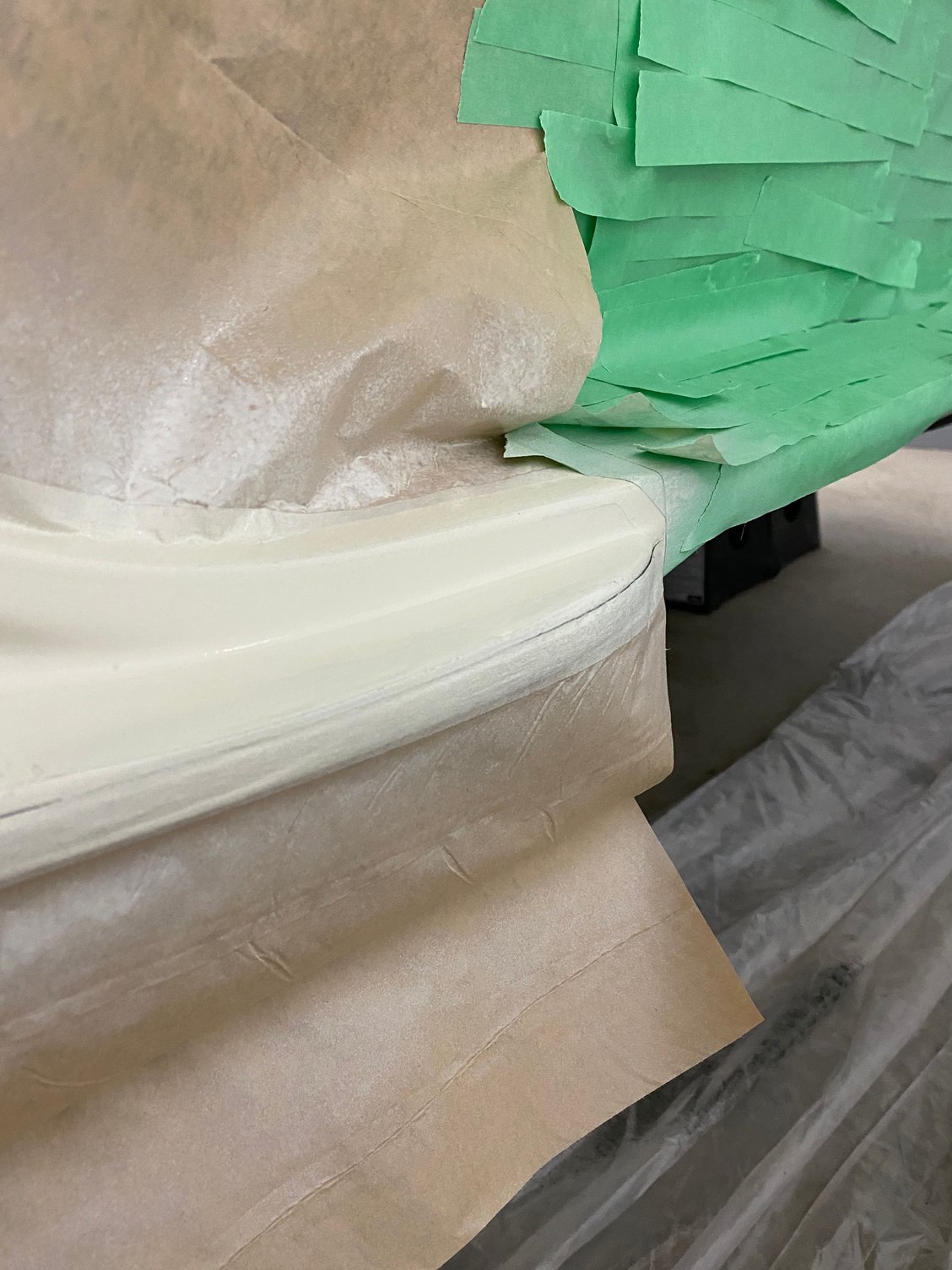

Today I continued work on various visual imperfections. I decided to repaint all four corners of the aerokit and finished off the rear bumper this morning. I taped off and sanded down 3 stress cracks in the front aero bumper. Once they were properly prepped I gave them a couple of coats of paint. I’m going to add one more tonight and I’m hoping that’ll be done. If not, I may have to sand down one of the areas and prime before restarting. I’m an amateur painter at best so I’ll be happy if I can get it 9/10. During some gaps in the paint work I sanded down the headlights with a 4000/3000/2000 grit and followed it with a polish, to get rid of many years of built up hazing. My wife was missing me as I’ve spent the last few days in the garage, so I removed the exhaust tips and brought them inside for a good cleaning with a wire brush and some acetone. I got them 90% but they could do with some wire wool to finish them off.
Tomorrow I might take a rest day as my back is a little sore, but I’d like to remove each wheel and examine the suspension. I’ve got some red caliper paint so I’ll probably sand them down and repaint before fitting the new wheels on Monday.
The more time I spend with this car, the more I love it. I’m so excited for my wife to drive it when i’m done this first wave of work.

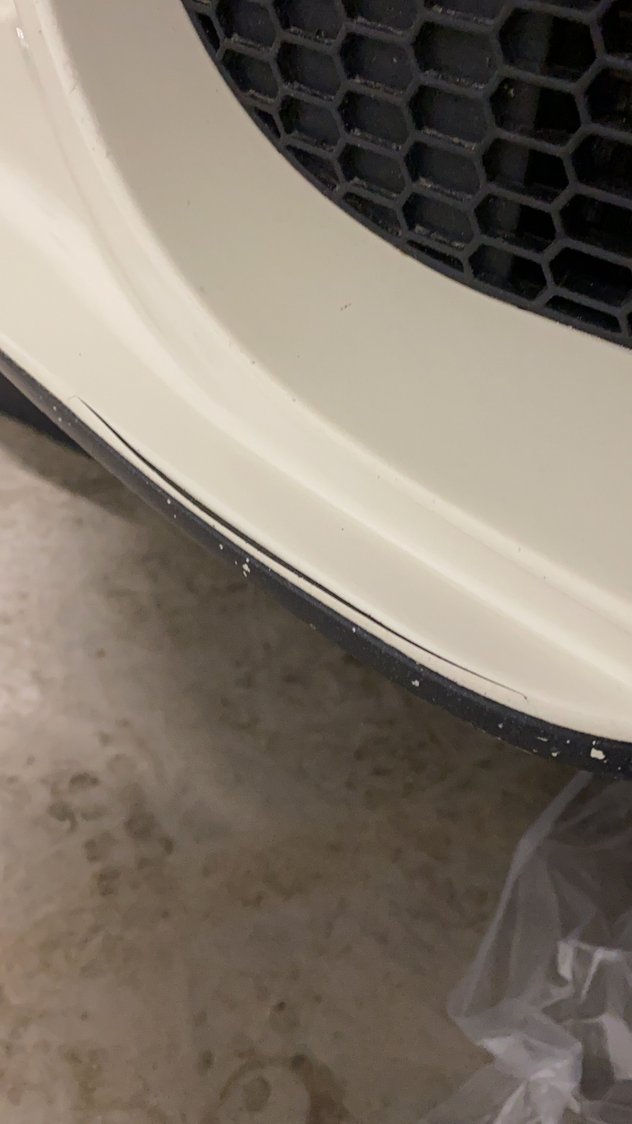

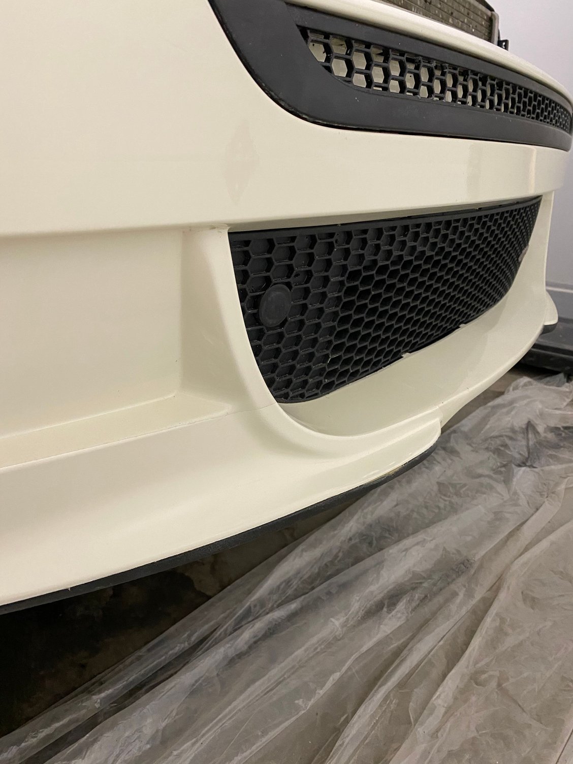

Before and after of the crack in the lip of my aero kit. (The discoloration on the black trim wipes right off) so pleased with how this came out! If you look carefully you’ll see the seam where I masked off. I’ll wet sand this once the paint has had a few day’s to cure.
There didn’t seem to be any cause for the cracks other than age. I think it’s a high stress point where the plastic has shrunk. I assume this is probably a common issue.

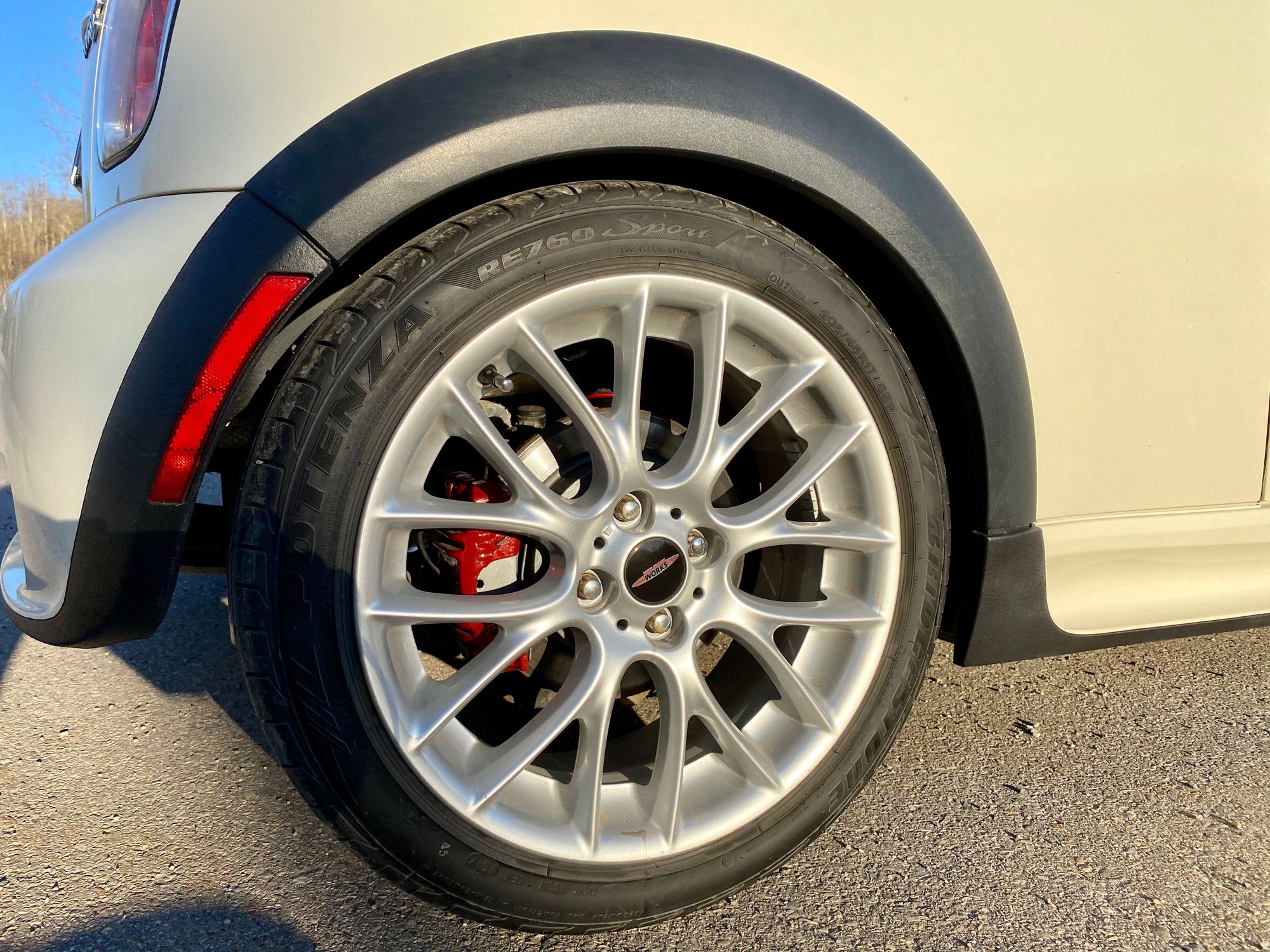

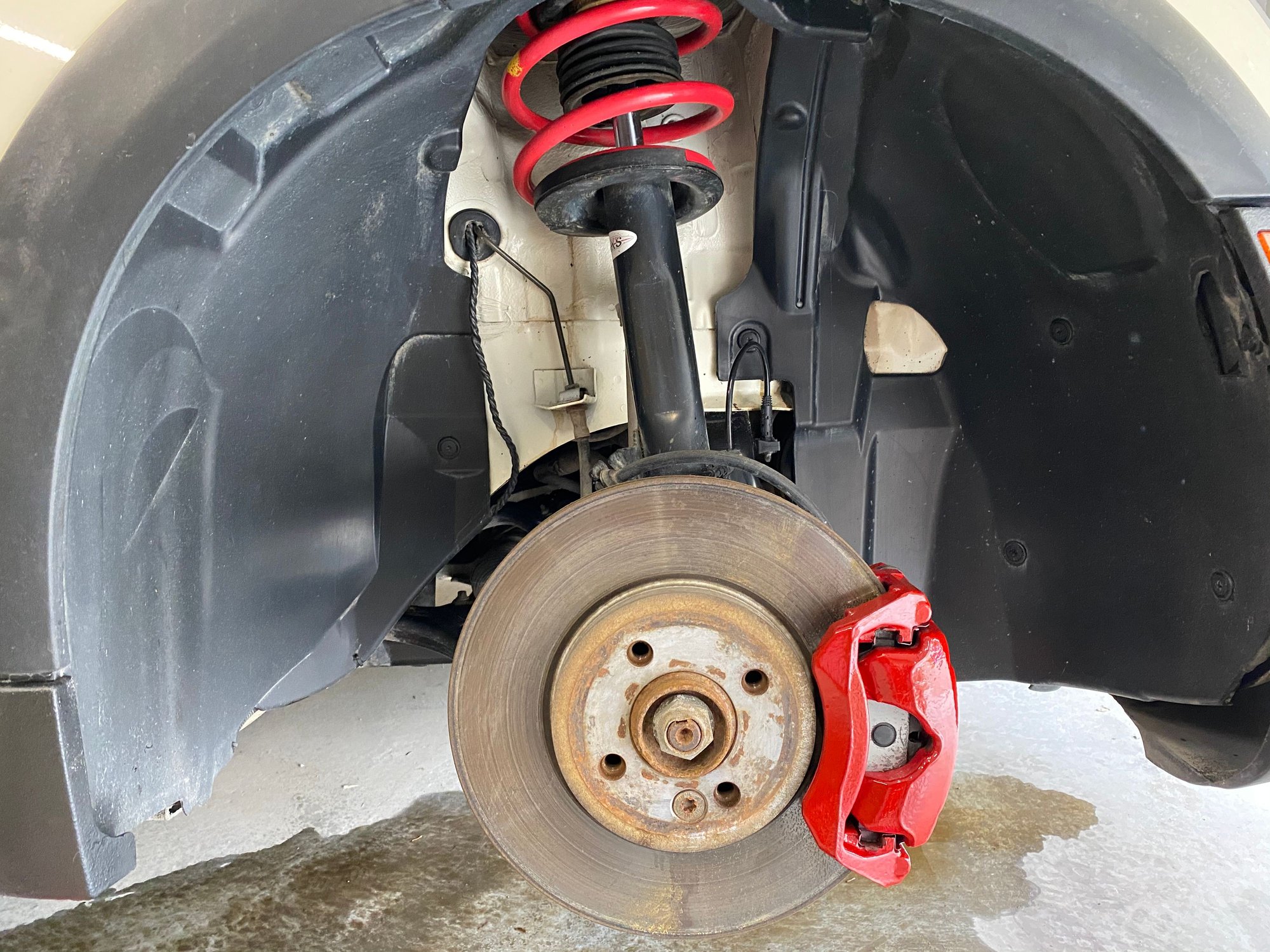

Looks like you got the JCW suspension too.
Those weren’t Factory installed so either the dealer loaded the car up, or one of the previous owners wanted all of the JCW performance items that were available.
There are references for decal sources in some of the Poor mans JCW brake threads. Make sure you get the correct 1st gen JCW logo with “John Cooper” overlapping “Works”. Also, they should be silver, not white.

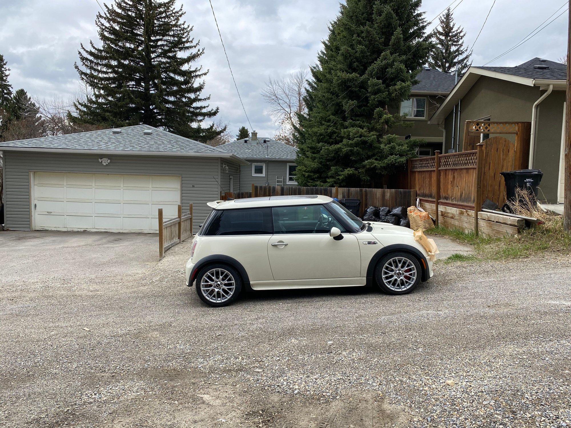

Had to spin the car around in my garage so quick preview. Still need to go back and paint the rear callipers.

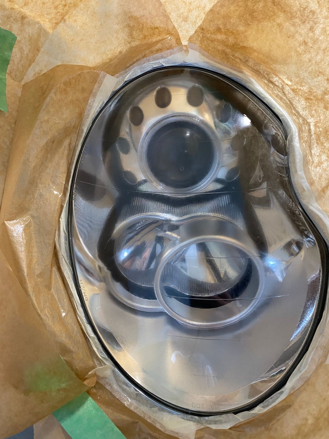

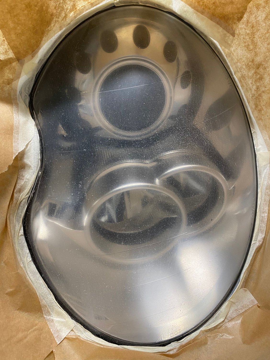

I sanded and clear coated the headlights today as they were very hazy.
I went 800/2000/3000/4000 grit with a water spray bottle followed by a clear primer and then 2 coats of clear. I’m happy with the results.
After this I finished cleaning all of the wheel wells and went back around them all to give the fender liners and suspension components a coat of wax. I was a bad boy yesterday and didn’t clean my brush, so although I’ve prepped the remaining 3 calipers for paint, they’ll have to wait until tomorrow to get the treatment. I’ve ordered the correct Gen1 JCW caliper stickers from Acromann and can’t wait for them to arrive!
I also lightly sanded the seam in my bumper patch paintwork with a 320 grit, then blended the paint with some white spirit before clear coating over. I won’t see the final results of that until tomorrow but the initial results were promising.

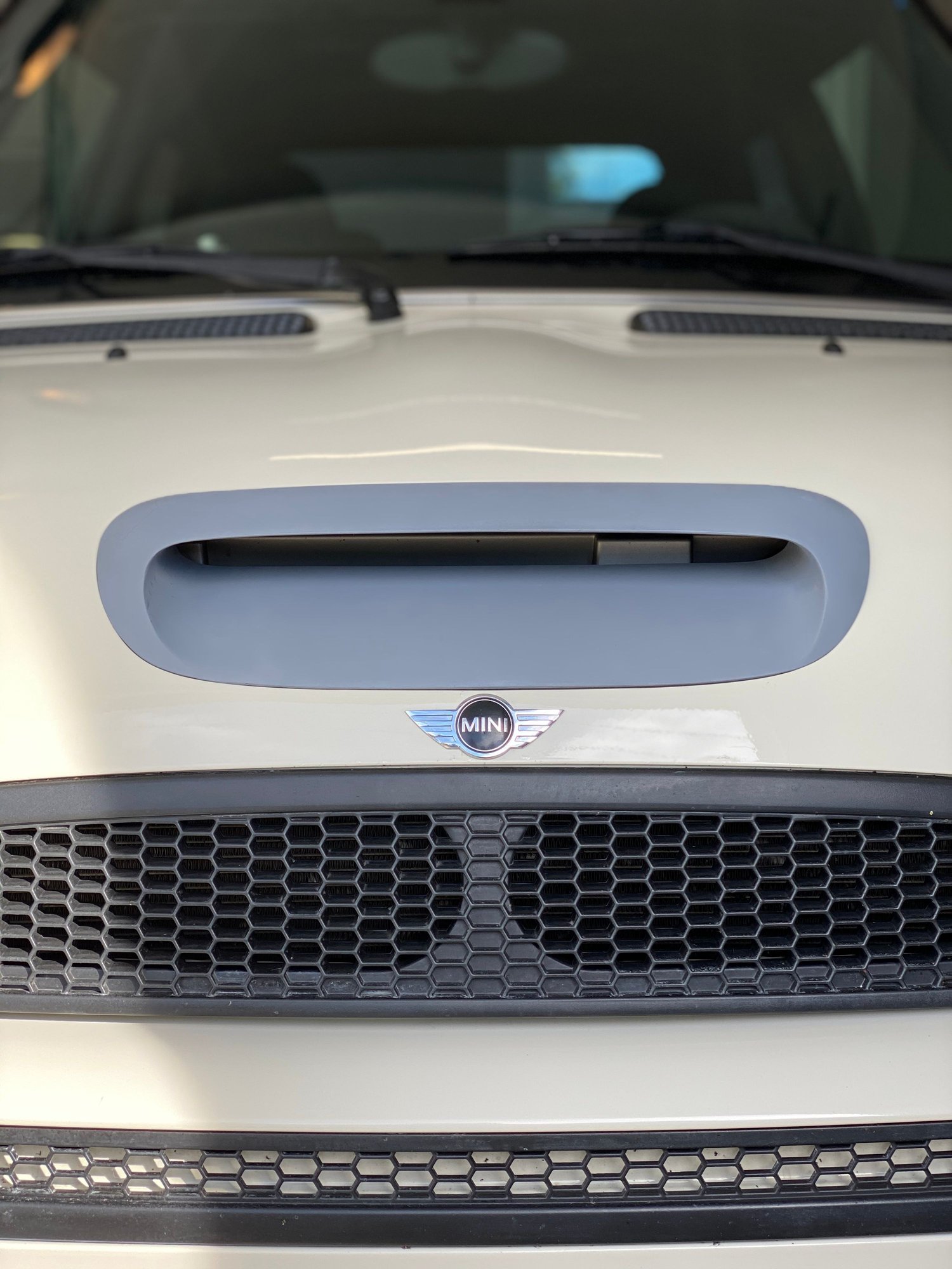

- prepped, painted and installed Omicron scoop. (Love this mod. I went with pepper white rather than a contrasting colour and I’m glad with the decision. It really does seem
tomgrab a lot more air and feeds the intercooler enough to stave off heat soak in moderate driving, during some 20c weather we’ve been having here. I feel like it’s relatively OEM+ looking which was my hope)

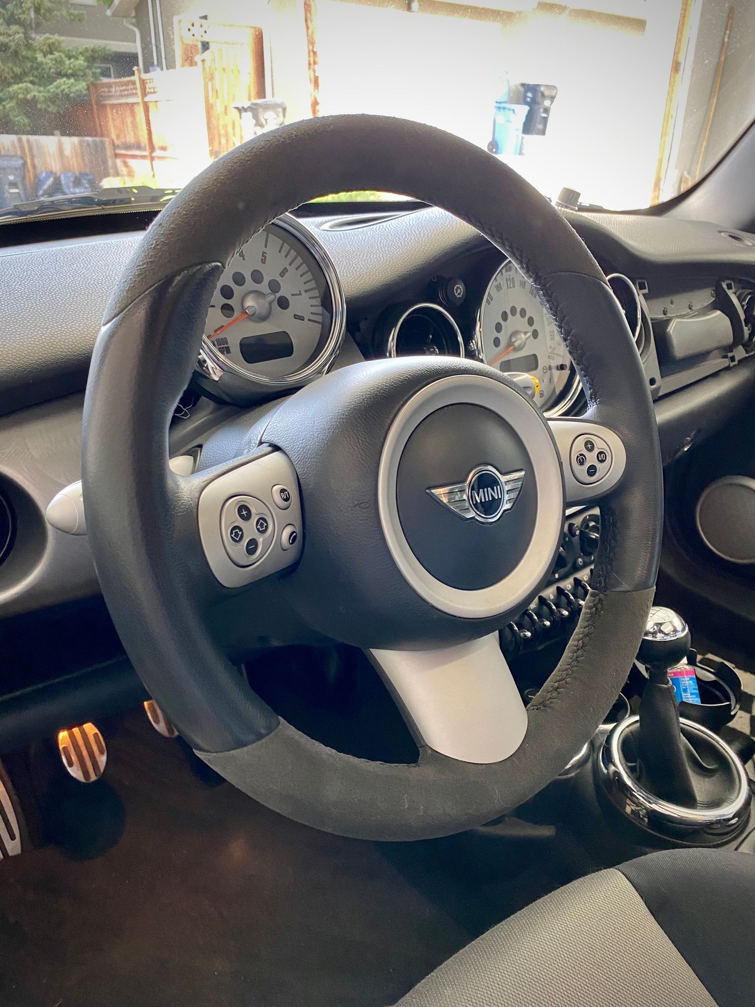

- Installed the JCW Alcantara / Leather wheel. (Yay! Used to have this in the Checkmate 10 years ago and had to have it again)
