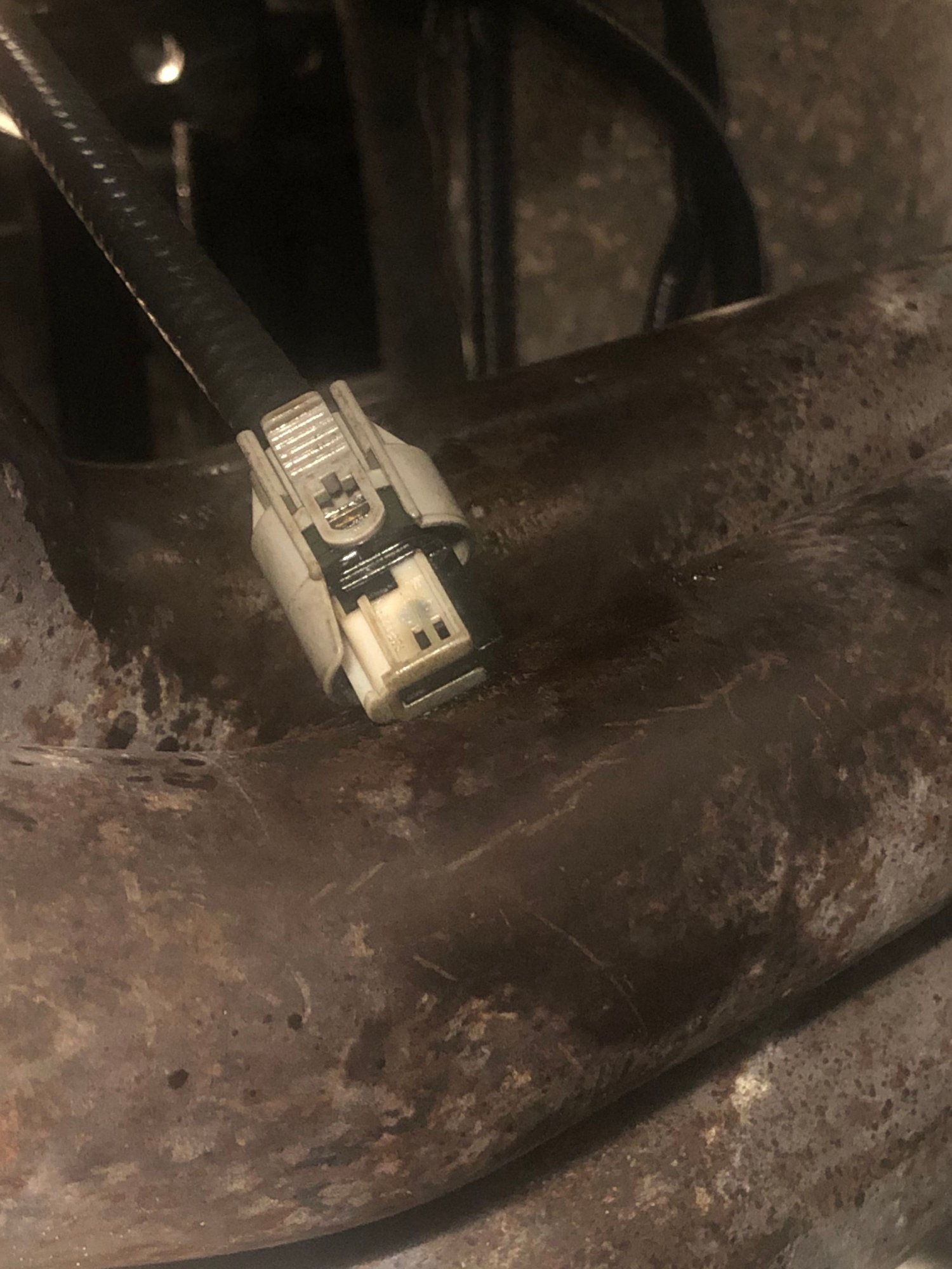

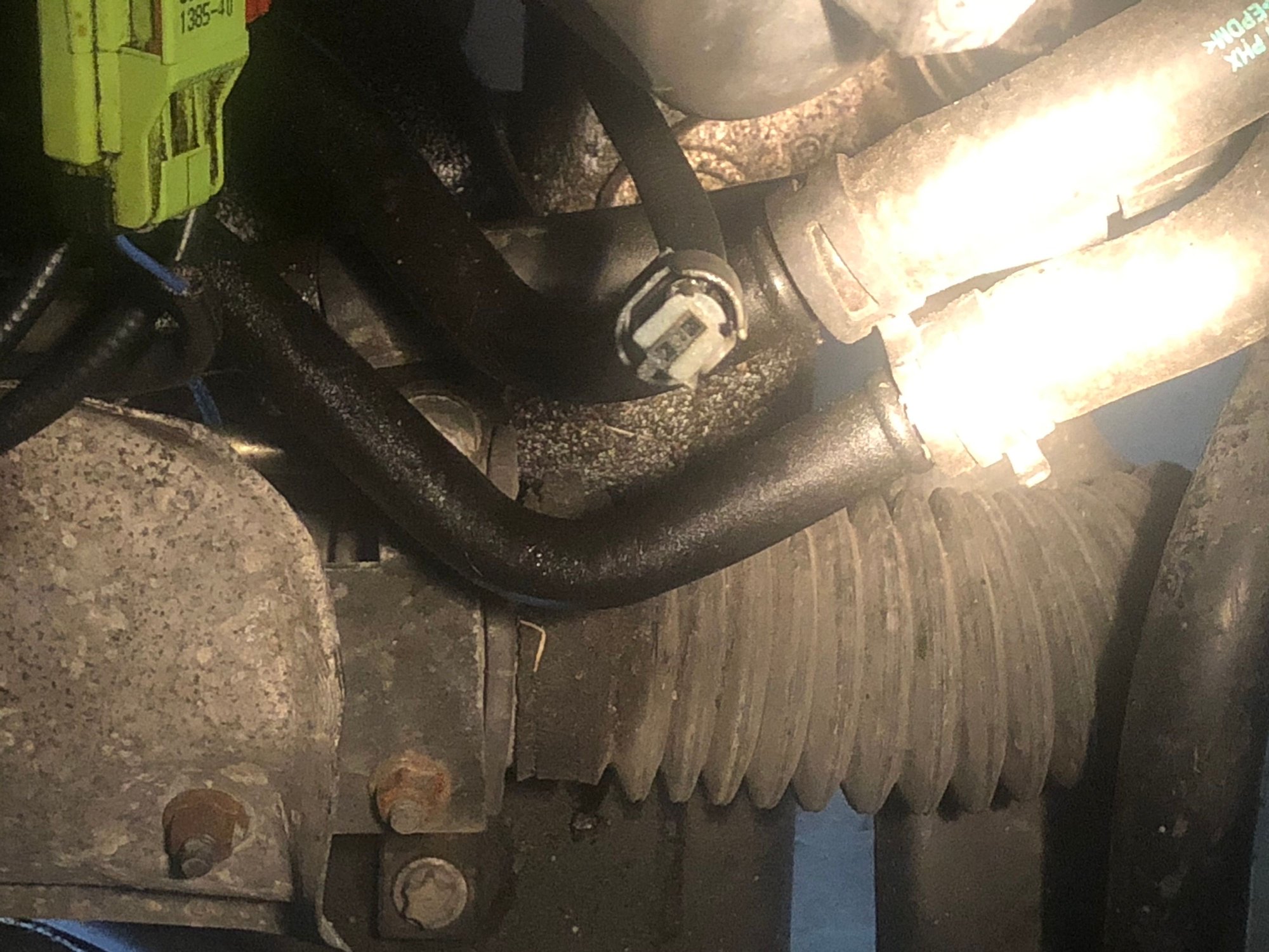

I was cleaning things up and getting ready to replace the oil pressure switch and discovered this connector hanging down...unconnected. It looks to be bundled with another connector that goes to the EHPS just above the steering pump cooling fan. Here are a few pics. Please let me know if anyone can help id this and where it goes.

Long shot but it could be off of one of the side marker lights , like one built into the fender arch ...

Power steering pump cooling fan under the car? Oil pressure switch? Steering angle sensor?

Yes, it was the power steering pump fan...thank you!
