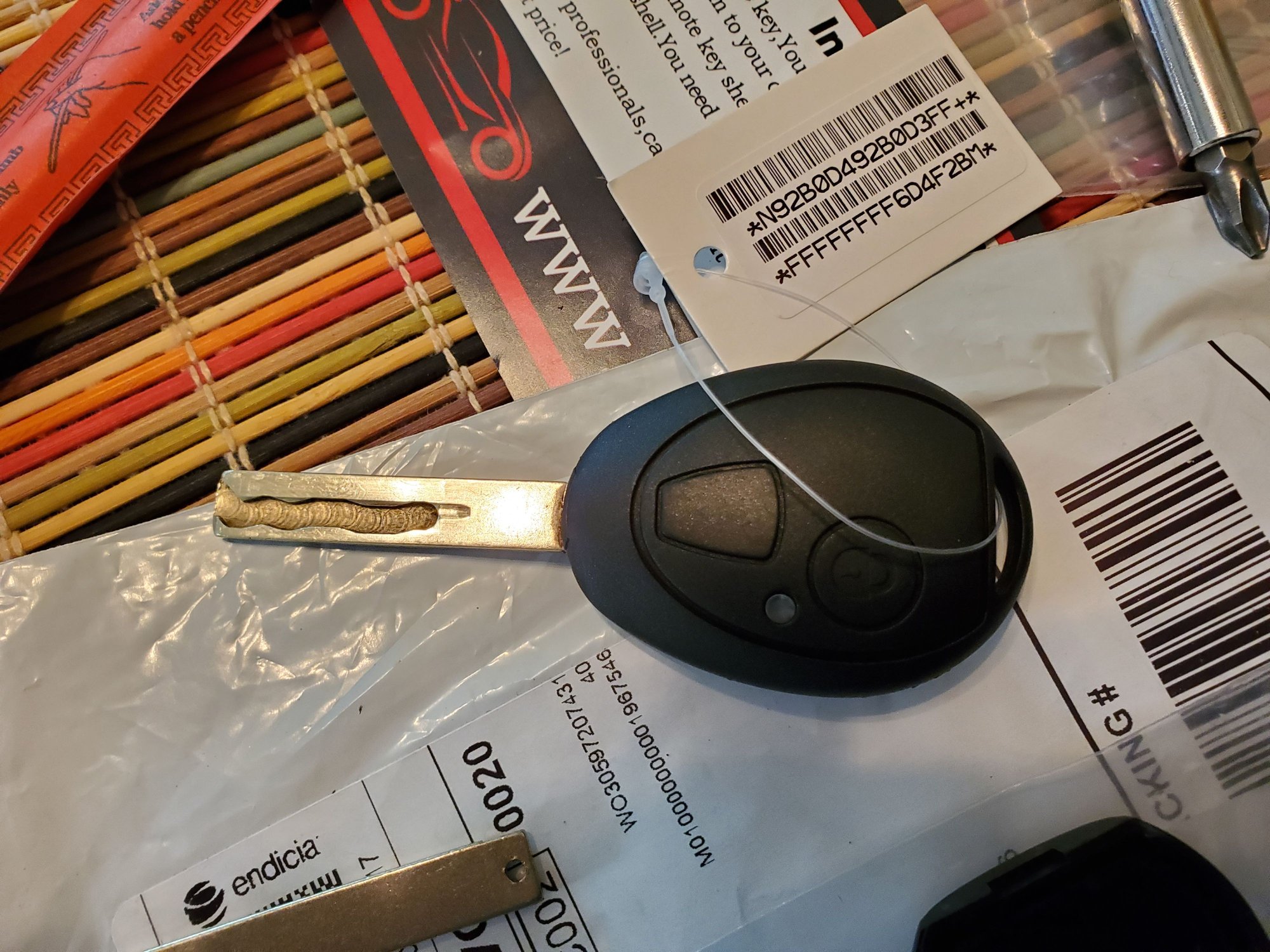

My Ebay key arrived today. A little disappointed as I ordered a key that showed a Mini logo shaped button and I recieved a key with Land Rover style buttons. It's not enough of an issue to make a fuss over, though I will make a note of it when I leave feedback. The construction is a bit different than the OE key, but it only took me about 30 min to get the key blade and EWS chipped swapped over to the new key assembly. I still need to program the fob to the car, but at least I have something I can work with.
New key disassembled. Slightly different construction, but the blade is still held in with a roll pin.
The original key with its missing rubber buttons and broken and corroded circuit board.
To remove the blade from the original key I used a 1/16" drill bit through the center of the roll pin to center a hole for the blind side.
I then drilled that pilot out to 1/8" and used the drill to start pushing the roll pin out. Then I used a pair of needle nose pliers to pull the roll pin out.
The end result. The new key wasn't a blind hole for the roll pin and I tapped it out with a tiny phillips screw driver from a glasses repair kit.
There is a slight difference in the end of the key blade where it attaches to the key. The thicker one is the original key.
A quick trip to the bench grinder took care of that. The new key blade was installed in a small piece of plastic and used a smaller roll pin. I drilled out that little piece of plastic to accept the 1/8" roll pin that matches the original key blade.
The EWS chips pop right out with a pocket knife or tiny flat screwdriver. Be careful not to mix them up! Here's the key all assembled and tested. Grumpy starts and runs just fine!

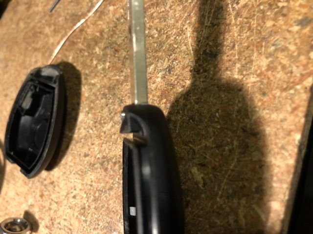

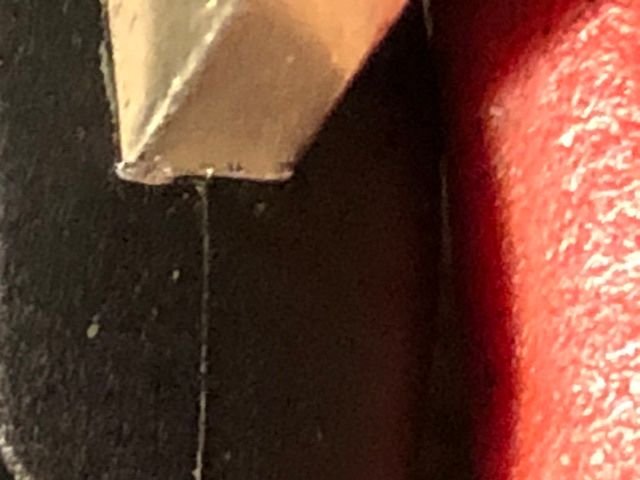

My problem with getting the key blade to fit in the case was just the opposite; it moved side to side too much. In all fairness, there was some movement even in the original case.
I used a pair of calipers and found a difference of +0.008” between the width of the case slot and the width of the key blade.
To fill this gap I folded over a small piece of aluminum foil 3 times, and trimmed it to be the same thickness as the key blade.
The photo gives an idea of what I mean, though it shows only one strip of the foil.
The final piece of foil was folded over on itself 3 times, this was still too loose.
Once I pushed the stack of foil and key blade into the key fob slot, there was little side-to-side movement. It fit better than the original case did. I trimmed the excess foil with a new utility knife blade, as shown below.
This is a close up after trimming the foil. Unnoticeable when looking at the key.
One more thing to mention, when I pushed in the roll pin to lock the key blade in, the hole in the case wasn’t quite deep enough and the roll pin stuck up above the case as shown below.
The pin is sticking up far enough to prevent the case from fully snapping closed.
I had to grind the pin down with a Dremel tool. I should have compared the hole depth to the pin length, it would have been easier to drill the hole a little deeper.
Live and learn. Hopefully this will help the next person who tries this!

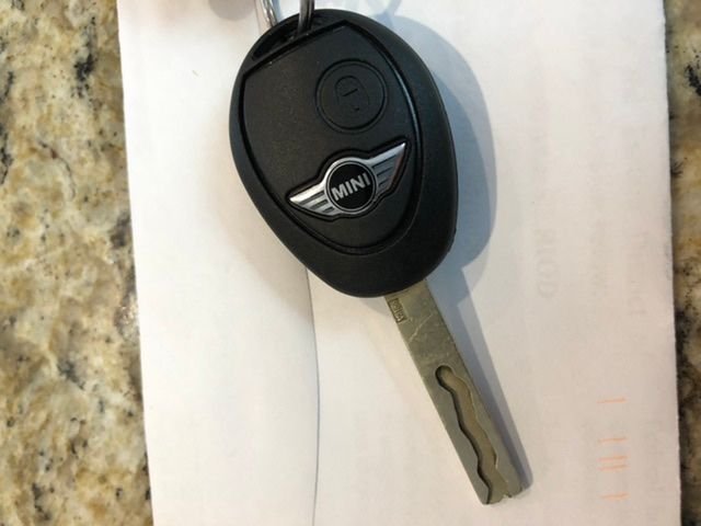

Here’s the final result:
Looks like a factory key! Works like it too. The switches I ordered perform perfectly.
