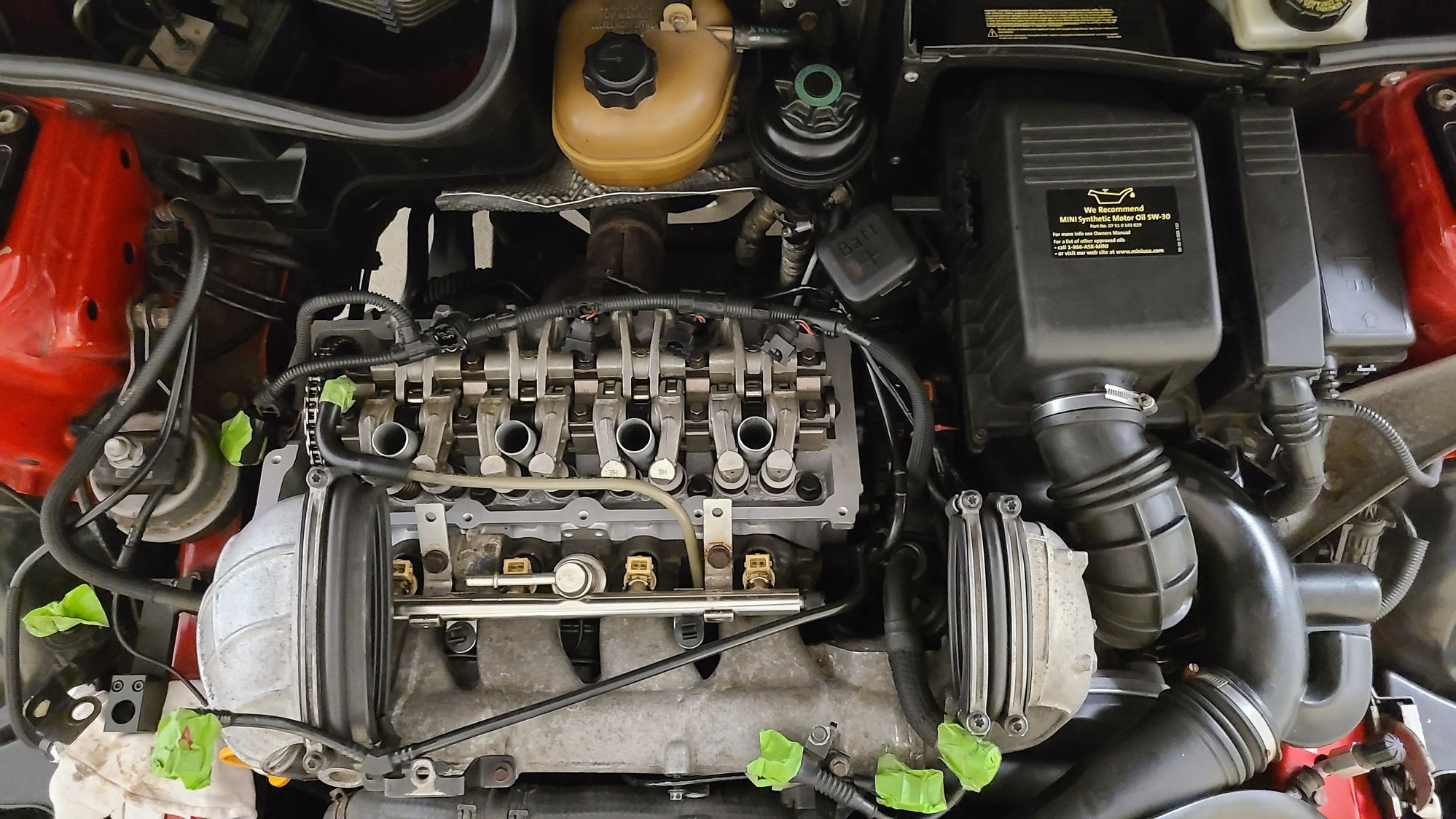

Likes: 49
Cam...Cam sprocket and rockers installed

It's ready for a coolant flush and fill......Fill it with some oil...crank the motor a few times....then give it some spark...

That looks clean!
