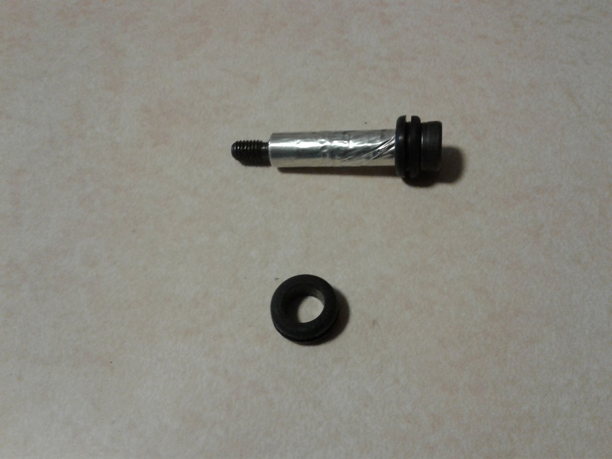

But on the way to tracking down P0302 I started at the electrical side...New plugs/wires/coil pack...Car had an MSD coil pack on when I got it so the bolts were not gonna work with the OEM (Beru).....
I found these shoulder bolts at McMaster/Carr......
It's a Alloy Steel Shoulder Screws, 8 mm Shoulder Diameter, 40 mm Shoulder Length, M6 x 1 mm Thread...Part# 92981A206....
They were a smidge too small in diameter ..but two wraps of metal tape and they fit perfect....
Found some rubber washers that would crush down about 1/3 of there thickness...
I"m pretty happy with the end results....But unfortunately it wasn't the cure....But maybe this will help someone out...I thought the OEM bolts were pricey....
