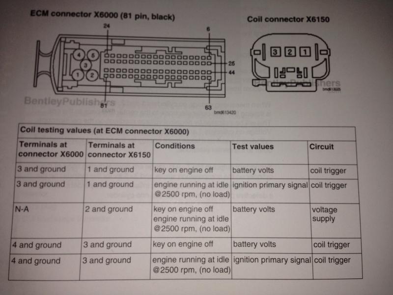

I'm going to double check all the grounds, and I found fuses F02, F03 and F04 are related.
Any other ideas?
I also found the coil terminal (x6150), it's a table that says stuff like "Pin 1 and Ground" "Condition: key on engine off" "Value: battery volts"
I also have a similar table for ECM Connector (x6000)
Sorry to sound like such a newb., but I should just set my multi-meter to volts and check all of those, right?
Also, I was thinking of unplugging battery, disconnecting ECM, and testing Ohms between the Coil Connector and ECM Connector. Would that be a good idea to tell me if I have a wire shorted or broken somewhere??

I've pulled the plug off the coil, and measuring for battery voltage with key on engine off condition.
I have 12v between terminal 2 and ground, but 0 between 1 & ground, also 0 between 3 and ground.
Power at terminal 1 on fuse panel, and fuse #2 are also good.
I haven't tested the terminals at ECU yet, I want to disco the battery and let it rest before I unplug that one.
I'm confused on my next step though,.. Do I measure the ECU, or the cord that plugs into the ECU? Or do I have to pull the back off the plug so I can measure when it is plugged into ECU???

Old Mar 1, 2014 | 05:59 PM
AlexQS's Avatar
AlexQS
Joined: Apr 2013
Posts: 731
From: Near Portland, OR, USA
Okay, so I see how it works now. (And it still does not work)
On the plug with the 3 wires that go to the coil pack, I can back probe all 3 of them with an Ohm meter. No broken wires unfortunately,.. because that would have been an easy fix.
The center wire goes to the fuse box. Wires 1 & 3 go to the plug for the ECU.
The reason that I didn't see power on 1 & 3 earlier is because it was not pluged in to the coil. Power goes in to the coil on wire 2, then comes out of the coil on 1&3 and goes to the ECU. I do measure power from the coil at the ECU terminal.
