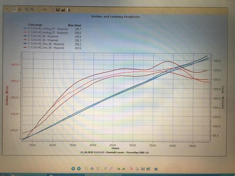

Hey @adriancl
Yes, I do know this guy too. And I´m happy about. Because he is the onliest who was able finding the solution in ECU to let all hardware modifications works as they should!
My short story:
I´m from germany (sorry for my bad english) and renewed the engine by Dr Krumm near cologne.
Head with big valves, ported head, cam made by schrick with krumm datas, competition clutch, woessner pistons, 380 injectors, JCW Pulley and SC, ATI +2% Crank in Hardware.
But the car only delieverd on Dyno 200hp, because the PFL-ECU (EMS2K) with the appropiate JCW Software was ne Neck.
After lond sarching in Internet and Forums, I found Adrian.
And thanks to Adrian, now I do have the FL-ECU MS5150 with GP-Software, where he has changed some settings special for my Hardware.
And since this moment I do have a beasty MINI.
fun fun fun
Take a look on my 1st Gear: push me smart
I´ve did a few flashs from Adrian here in Germany and all are really happy.
At least, I´ve logged a few Versions on my setup with PowerDYN. And it looks really intresting.
It´s incredible. So that I´m wanting more.
And we do have plans:
Next step is installing the TVS on the Miststück.
And than, Adrian has to create a special modded File.
How do we realizing this? I´ve installed 4x EGT an AFR with Innovate Probes, and additonal I´m able to logg with a costum made software all engine Parameters in common.
I´m so exciting on March.
I´ll keep you informed.
Keep on Tuning!
