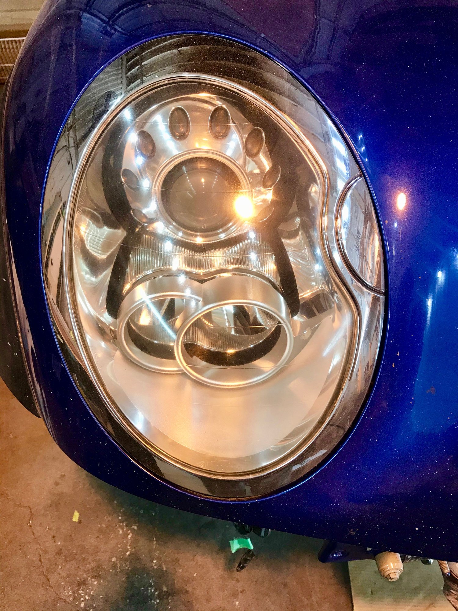

So in getting everyting back together I forgot to instal the headlight adjusting sensor that goes under front the inner ball joint, to the lower control arm. I'll be darn if I'm taking the brakes off and pulling the axle out to get there so I cut a slot in the positioning sensor bracket so I can slide it under the bolt.
I think that will work, but that being said, do I really need headlights that self-adjust if I put an elephant in the back seat and am I incapable of wiping off my headlights?
What I would like to do is ditch the self-leveling headlights and ditch the headlight washers. Talk about over engineering!
Any recommendations for replacement headlights and if I did this would it require any reprograming?
I was looking at these, but are there cheaper alternatives out there? $400+ seems a little steep to shed crap that was overkill in the first place! And would there be any codes thrown or reprograming involved?

You can just leave the levelers off and manually adjust the headlights. They just won't move with the suspension movement if you add weight and such. Basically like a car from the 90s.
Those Xenons are brighter than the aftermarket so I would stick with them.
You won't get an error or anything, but if you were to read out the data in the BC1 you may see codes for the levelers but it won't hurt anything.

Thanks so much for that information, definitely helpful. I cut a slot in the mounting bracket for the leveler so it will slip under the ball joint bolt so I'll probably put it back together the way it's supposed to be.
But again thanks for the info, it's good to know.
