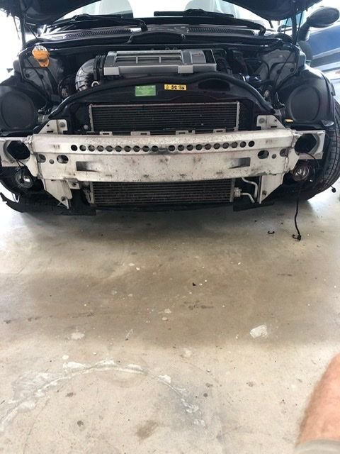

I thought I would do another thread on horn replacement rather than add to some other threads that got worn out. I started searching other threads and got a lot of useful in formation. Such as what horns people where buying and how to install them. The one thing i found out is that for my car it was very easy and I did not have to remove as many fasteners as posted in previous threads . Maybe it was because my car had the Aero kit. For me no need to remove the inner fender fastners...only needed to remove 8 fastners and the front fascia came off. A10 minute job.

How did you handle the electrical connections?

I just cut off the MINI connectors, then butt spliced marine spade connectors and heat shrink...Easy and clean.
