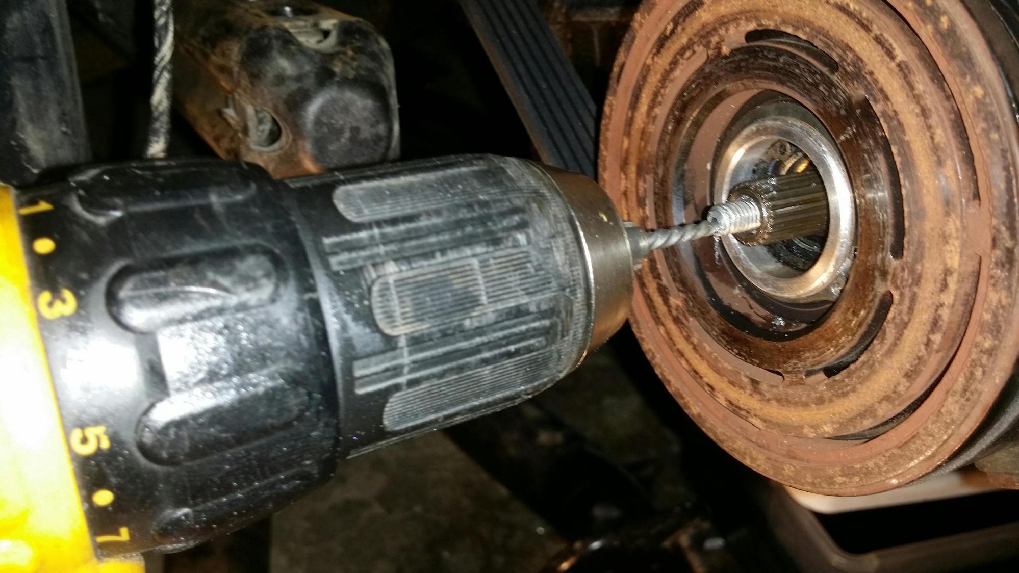

Well, I drilled about a quarter inch into the bolt with the left-turn 5/32" bit, and the bolt nub looked like it was starting to turn, so threaded in a #1 bolt remover, and out it came. Was a little worried that I did not manage to get my hole started dead center, but was done in 10 minutes Was tough going for the first 5 minutes or so until the bit started to really bite, but kept cleaning the threads of the bit and dipping it in some cutting oil. Phew - that stress is relieved. Now just need to know the thread pitch so I can find a replacement. If no one chimes in, I will just stop in to home dumpster or menards tomorrow and use their metric screw hole thingy to figure out the threads. Delayed, but not as delayed as it could have been. Honestly, if it had been replacing the A/C compressor, I would have seriously thought about an A/C delete.

Got it! Had a few extra bolts laying around from my recent rear suspension work and tried the closest looking size and it was perfect. The pitch of the A/C compressor clutch bolt if anyone else ever needs one is M6x1.0 and the length is 1.5 cm. I think there may be space in there for a flange head bolt, so will check my local parts places tomorrow.

And what started out as a heartbreaker of a evening with the breaking of that bolt ends in success - replaced the driver's side power door lock module just a few minutes ago. A bit more difficult that the passenger side because you have to line up the sort of gigantic phillips head door lock backside with its mating part on the door lock module. Took 3 tries to get that lined up. Then I had to finagle one difficult cable back into place. Overall, not a tough job, but definitely a lot of stuff to keep track of routing on and get back into the correct places.Happy to report that all of my power locks are now completely functional!

Nicely done with drilling out the bolt.
I have never tried it with left-twist drill. Interesting that these exist.

Left-hand bits are the way to go when drilling out bolts. I've had pretty good luck with them and extractors in the past.

I did the same thing when I replaced my A/C clutch last fall. And had the same luck with left handed drill bits. I bought mine on amazon and they have saved my bacon a few times. I've had bad luck with extractors, but I've never tried them with left handed drill bits.

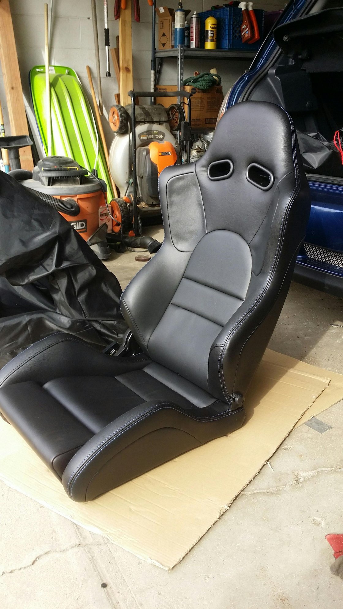

Wow, so what a day was today.
First thing this morning, I grab my keys and lock the door behind me. I realize by the second step down that I have the Mini Keys. Which don't have a house key. Quick - think... first lecture in 22 minutes. Call my buddy up the street that has a spare key when we travel. Nope, he's 30 miles away on a job. Tried the back window. I had locked it. Wife is driving to the southland to pick up another R53, so couldn't call her at work... Ugh... so walk to work, and send an email to our admin assistant telling the students to just go that I wouldn't be there in time. 20 minutes late for my first lecture, students are all there, waiting. I explained what happened and asked if the admin asst had come by - no. So, great start to the day.
Around 3, my buddy got home so I walked the 30 minute walk from campus up to his house - he had a voice lesson with someone (he's a musician), and grab the keys and walk to my place. Nope, my spare isn't on the set. So I did the credit card trick. Took a long time, but I did get the front door to open! (I have a deadbolt as well, but you can't lock that without the key from the outside). Anyhow, did a little dance when I got in.
Ran a package up to Fedex, and then started to work on the MINI. Got the front bumper cover on and mostly buttoned up from my water pump change-back-over, and Fedex shows up. They open up the back end and I see a really big box come out. Braum told me on Tuesday that my brackets shipped and that my seats would probably ship on Friday, so I expected the Planted brackets today, but not the seats! So, of course, I unboxed them! Box was a bit beat, but what was inside was just fine.
Surprise box that showed up. Hmm... wonder what it could be?
Was a bit worried when I took these out of the box and there was some broken plastic rattling around the bottom of the box and a couple small springs. When I looked, it looked as if it was a bit of broken toggle. These seats were in drawstring bags over the big, thick, robust protective plastic inner bags, so they were packaged pretty well and they had extra layers of cardboard all around the sides.
One had a broken draw sting toggle.
Color is a bit darker than the sample that they sent me, but they look good...
The stitching color is not what I would call cobalt blue, which is what the color in the photo they sent for thread matching looked like, but it is pretty close to the blue on my other trim piece items. But these seats look really, really nice. They are a good fit for my man sized butt as well. I have a 38" waist and sitting on these outside the car, they are stiff, but comfortable. I am kinda digging the shoulder wings. They are in a nice place and I think those will be supportive on longer drives.

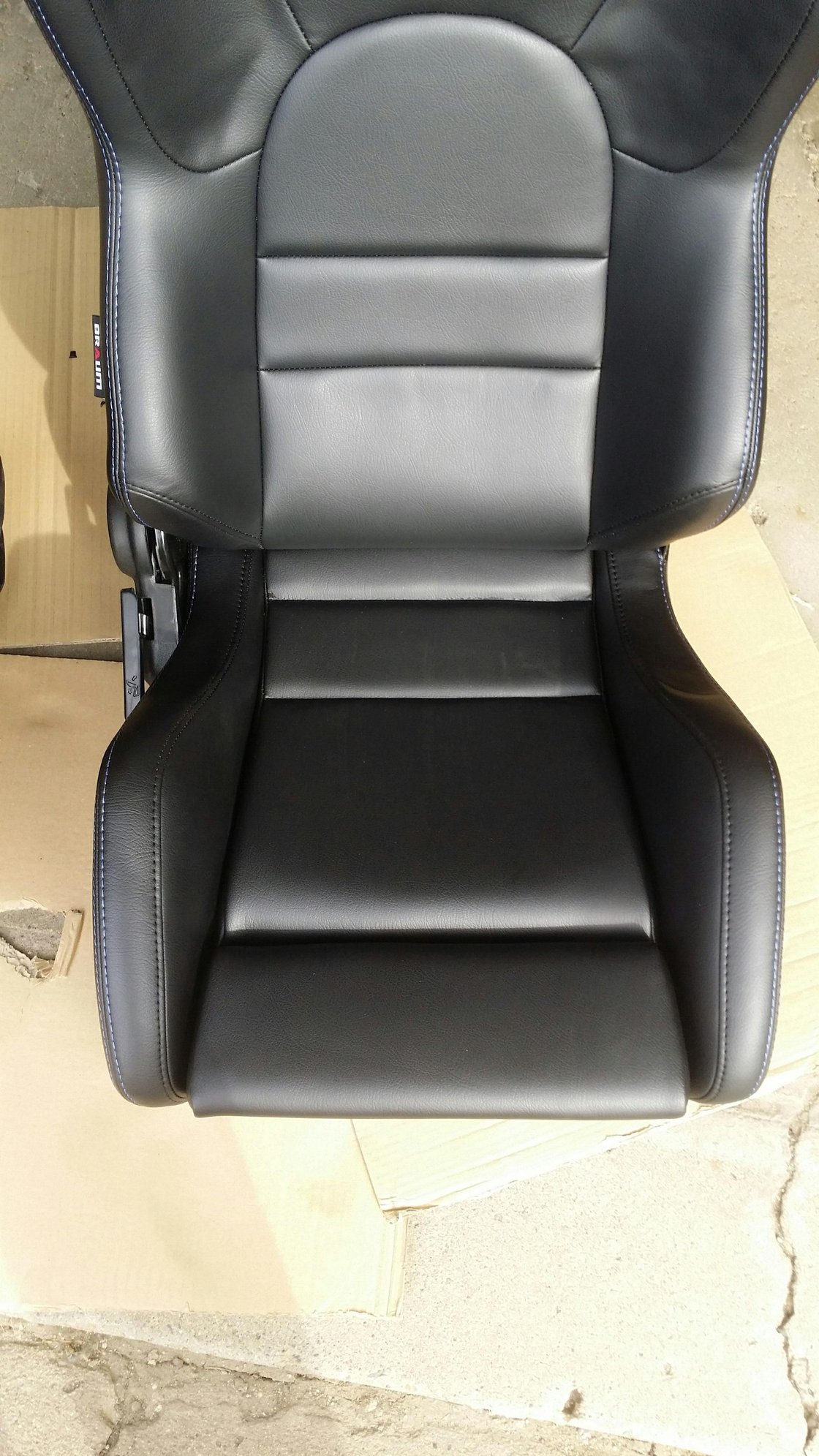

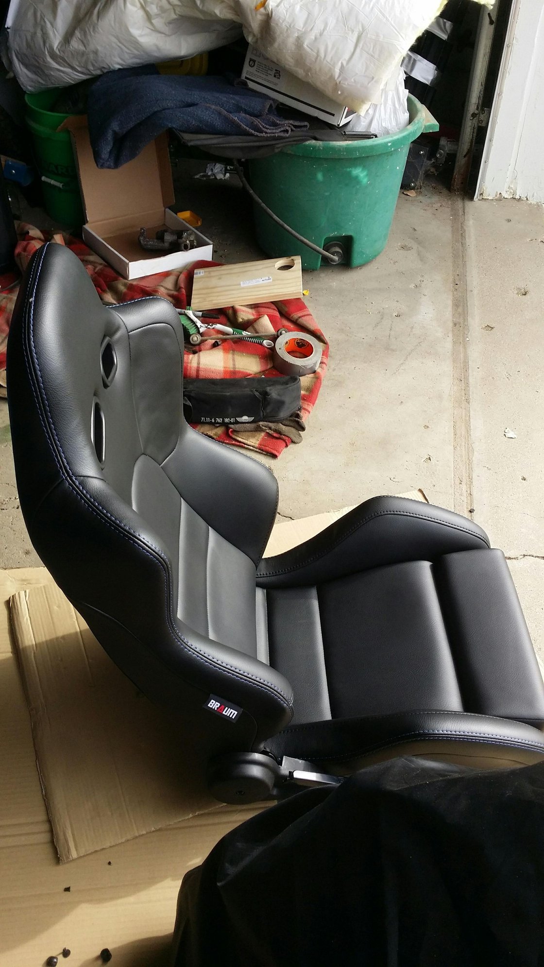

Couple more detail shots a bit closer in.
Seat base.
Seat back.
3/4 view.
