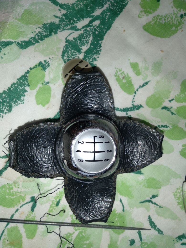

R53 MINI COOPER S SHIFT **** RESTORATION - PART 1: Disassembly.
So I have been looking at shift ***** recently. Most of the ***** available for the R53 are hideous, although I think I could adapt pretty much anything to work, although I have been looking at the Raceseng ***** which I think look pretty good. A few things about them bother me though - I don't care for the stylized R, and I don't care for the outward bent outer gates of the shift pattern engraving that look like parens ( | ). I also *REALLY* like my stock **** - call me silly, but I think it fits the look of the interior perfectly, it looks great, and it feels good in the hand. It also has some heft. At least mine does.
I know that there are multiple versions of the R53 shift ****. The part that came in mine is a solid ball of metal. Others have a metal insert surrounded with plastic and resin (I know, I took the wife's old one apart). A magnet is weakly attracted to the upper part of the **** but not so anywhere else, so it's mostly aluminum - and appears to be one piece, which is really weird that a magnet is attracted to the upper bit - perhaps something to do with the plating process? Dunno. But I do know that it has some heft to it - IIRC, the assembled **** weighs in at over 8oz. But, my **** has seen better days. The leather is matted and gross, I can't even see the stitching anymore on most of it (the leather one I just bought the wife has the stitching on the inside, hidden), and the chrome plating is pitting and crazing.
So, instead of buying a Racesng **** knowing that I will never be happy with the engraving, I am going to restore my original **** to new condition, recover it and restitch the leather.
I first snipped the center thread holding the double stitches together and then carefully removed that thread. Leather on shift ***** is most commonly 'butt joined' with a row of double stitching on either side of the seam, and then a diagonal ladder stitch that snakes its way through these side stitches used to pull the leather together and join the pieces. I first removed these diagonal ladder stitches and then opened the leather flaps up. I wanted to be exceptionally careful in this step as the old leather is going to be my pattern for cutting my new piece of leather.
Ladder stitch removed; leather can be peeled back at this point.
I was pretty sure the leather used to cover the ball was all one piece and that it fit in a small rabbet or groove between the upper smooth chrome piece of the ball and the lower piece, and when I opened up the 'flower' shaped piece of leather I could see that the hole in the leather was cut in such a way that it tightly fits into this rabbet and that is all that hold the leather on toward the top. This also gives the upper transition between metal and leather a nice finished edge.
I gradually and very carefully worked the leather out of that rabbet or groove, and it pretty easily came out all in one piece. I'll use this piece as a pattern to cut whatever kind of leather I use to recover the ****. I would like to use some sort of invasive species leather - animals that are not raised specifically or harvested only for their hides as I think this is a waste. I know ostriches and camels are invasives in Australia; certain alligator species, iguanas, and boas and pythons are invasives in the US. Perhaps one of these, I don't know. I do know that I will not need much leather though - a 6x6" piece will be more than enough. Here is what the leather piece looks like when completely off of the ****.
The ****, as you can see, is just a solid ball of metal in the early leather covered ***** (probably only the ***** in pre-facelift cars) with the hole for the center insert. I found a company in Illinois that will do the replating in chrome for me with a 4 week turnaround time. So the bare **** is leaving today for a replate in nice shiny, unpitted, uncrazed chrome.
That turnaround time gives me plenty of time to decide on what leather I want to use for the cover. Black is the only definite right now, and I have a few different black leathers on hand from looking for matches to the interior vinyl, so I may end up using one of those. I like the idea of an exotic, but I don't want to contribute to demand for exotic hides. I have a hard time with culling, even of invasives, but those animals are reaking havoc with the natural ecosystems into which they have escaped, so if I can find leather from an invasive exotic, that might be the ticket.
Anyhow, should be a really fun little project. Off to pack up the metal **** and ship it out to the plater. Stay tuned for part II some time later this summer.
