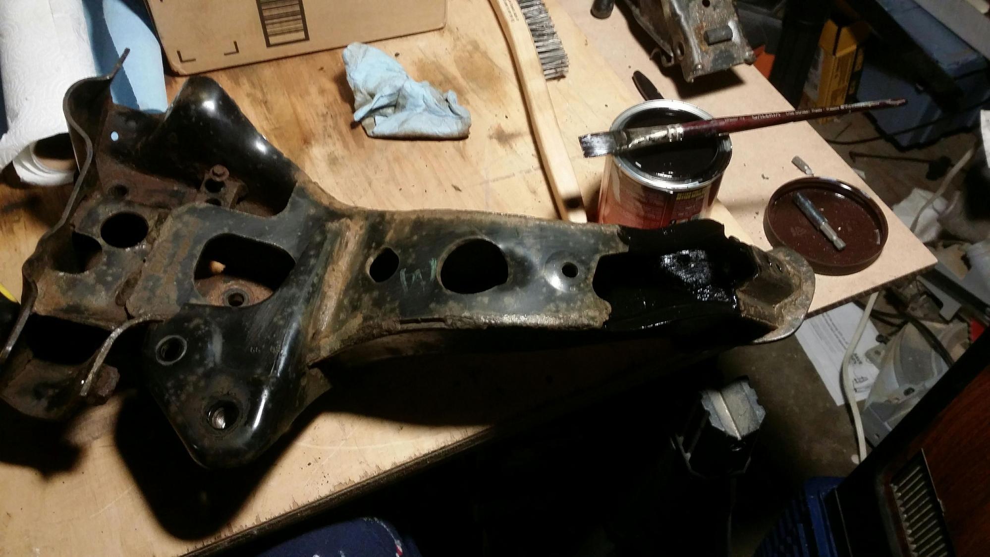

I just can't help myself. Turned on the heater in the garage, and did one coat on one side of the first trailing arm. Will probably do a light sanding between coats. Got the semigloss for all of the suspension bits. I got the heater blowing right at the part, and it feels like the bench is right around 70 degrees, so should be okay. Man, these were grungy. Had to say, I was contemplating going back to my original plan with the aluminum trailing arms when I first started taking these things off - they are pretty grungy. They cleaned up okay though. I scraped all of the big chunks of rust off with an old screwdriver, sanded with 80 where it needed it, then wire brushed the whole thing and then degreased it. One more to clean up.
Will do the control arms, the mounting brackets, and the axle carrier with this stuff. Well, still have not decided if I am going to order a new axle. The rust on the 'before' picture of the trailing arm below is pretty tame compared to how the axle carrier looks... it's rough.

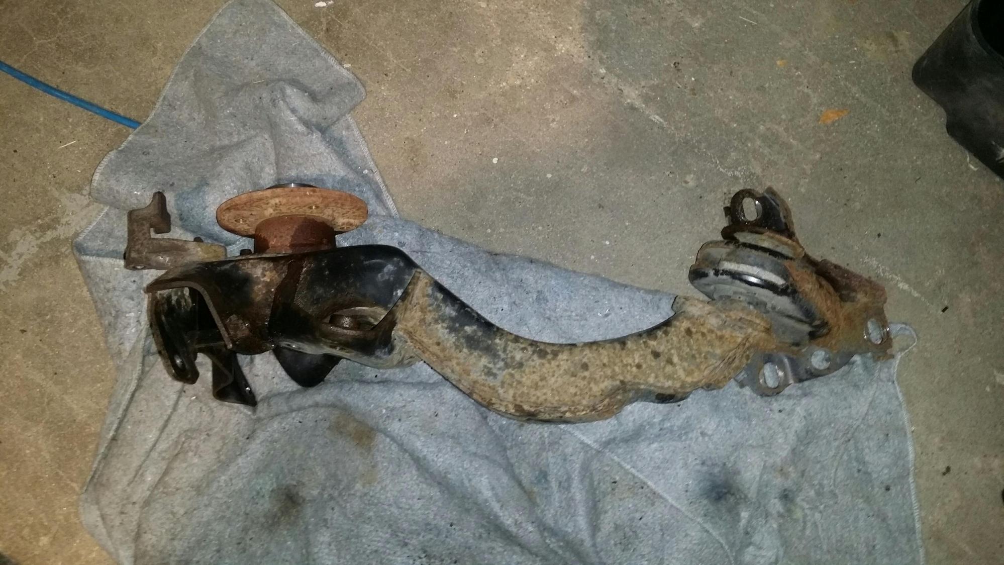

Just off the car.
Cleaned up - wire brushed, most of the rust brushed/sanded off. POR-15 'loves rust', so some rust shouldn't be a problem.
Now that's more like it!
Brrrr.... feet still warming up!
