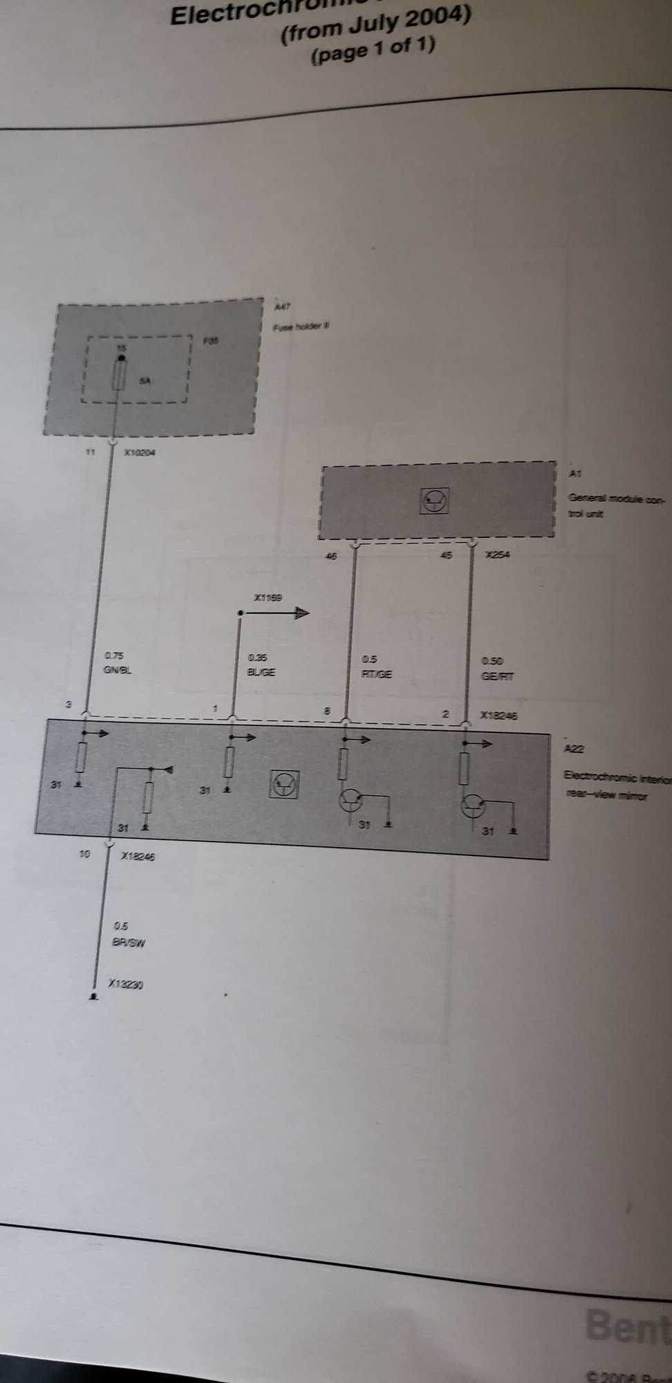

Reposting my question here, Electrical mod section doesn't seem to get much traffic.
I need someone to tell me if I'm reading the attached diagram correctly.
I'm trying to install the Invisicord power cord for my radar detector tapping the power in my mirror.
Wiring diagrams are like rocket surgery to me. I thought according to the attached diagram that I would get power from the GN/BL wire in position 3, and ground from the BR/SW wire in position 10.
I'm not getting power.
