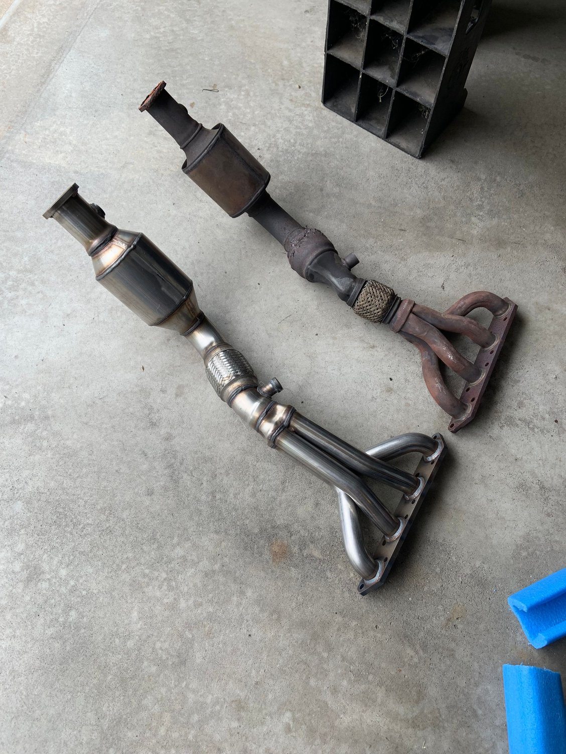

There’s a small pre cat before the main cat that’s looks to be repaired once before and looks hideous it’s that bad. I couldn’t tell if it was coming from that or not just behind the engine.

This isn’t normal right? To me it looks to b repaired at one time??

That is a butcher job at best and I don't doubt that is your leak!

Lol you think I could have a restriction there? Always wondered why my other MCS is so much fast with the identical mods. We’ll see what happens Monday when my Miltek header shows up.

Well the new pipe showed up today and excited to get it in. Wow what a difference!!

Yikes. wow never seen that before.

Well, that's one ugly-*** weld! My pre-cat cracked there and I welded the repair like this. Except better :D

Well got it installed and started up the car and the so called "exhaust leak" is still there. After further looking into it it turned out to be a bad timing chain tensioner. So my $800 header replacement really all that was needed was only a $40 part. Oh well live and learn but it's a very high quality header and the fitment was excellent. Haven't had a chance to drive it yet because I went ahead and removed the chain tensioner. So we'll see in a few days.
