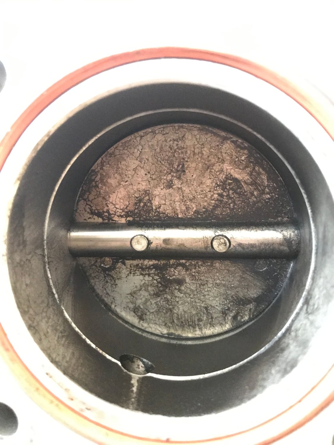

I then pulled the throttle body and cleaned it. I didn't move the butterfly at all but wiped it down really good so it shines now:

First off, it looks like the crank position sensor o-ring is leaking and replace it now, while it is easy. It is on the right side near the bell housing.(10mm bolt head) (you do not need to unplug the connector)
Second: Do not apply air pressure to BOV, as it will blow the diaphragm! Test with vacuum. You can put a small hose on it and suck on it, if you do not have a vacuum pump.
It does not take much of a vacuum leak to start throwing the P1498 code and it usually happens at idle as the vacuum is most then.
I use silicone gasket sealer on the BOV o-ring. I think it helps!
The two small lines can move, but I did have a difficult one and instead of waiting for a new one, I put silicone sealer on the outside of the tubing for that also. (lines that go into the supercharger).
Spray off the throttle body and BOV with Brake kleen. The grease on them gets sticky when cold.
Things to check are the crank vibration dampener, the serpentine belt idler/tensioner bearings, belt for wear.
Thanks for the heads up! I'll grab some more detailed pictures of the crank sensor area tomorrow, but it was replaced about 30k miles ago but if it's leaking I'll definitely change it now!
I sprayed the throttle body and BOV and got them very clean so hopefully that is good!

Okay, pressure tested again this morning with soapy water and found no leaks! Going to start putting everything back together now...
I had the MFE off in about 2 hours from jacking the car up, so hopefully install doesn't take much longer with bleeding the coolant.

Alright last week I got the car all buttoned up. We had a little hiccup when bleeding the coolant (had car on, bleeder screw open and opened expansion tank cap and had coolant pour out of the tank..). But after filling it back up with fresh 50/50 BMW Blue coolant all was well with the car making good heat and keeping temperature. We did also find out that my low speed fan resistor is blown (confirmed by doing a continuity test against ground) so have a new resistor from Amazon on order.
Some pics of the process:
The first owner of the car named it Stitch. Over the years other mechanics had added their own names to the bumper. I removed the other names and added the Stitch name back as it's only fitting
I also spent some time cleaning up more of the intercooler. Here is a nice 50% done picture.
Finally all put back together.
And the engine bay all shined up and the intercooler cleaned up!
The car drives great and seems to pull very strong, so that is great! I've done two cold morning starts with the A/C off and had no EML light or pending code so maybe the issue was the BPV o-ring/gasket. Time will tell as the weather cools some more.
