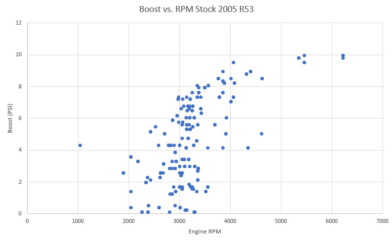

Before this happened I was able to do some data logging on my R53 as well as the family beater R53 (backup car). I came up with some interesting results below. The "Modified R53" plots are of my car with mods listed in my signature (~141k miles), and the stock R53 is literally completely stock (~132k miles) without a single mod just maintenance.
I still haven't pushed my car to its full limit so this data does not display the car's full potential.
I thought these were some really cool metrics to share with the community of the typical mods R53 owners make and potential gains. I wasn't really pushing my car to its full potential in the above, but the stock car was being driven as intended :D
