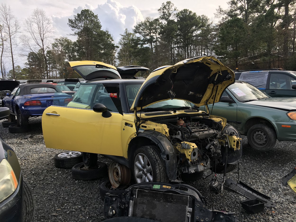

The local junkyard got a 2003 R53 in so this past weekend we went down to grab a few parts for the beater R53 we are rebuilding and see what else we could scrounge up for my car. It turns out the junked car had a full UUC exhaust system! From what I understand these were $800+ back in the day and sounded amazing. I had the entire exhaust dropped out in about 15 minutes and we took it home for $52
It needed a bit of welding repair but our local exhaust shop fixed it all up for $25. So $75 for a full UUC exhaust - I'm not complaining! I'll be swapping the UUC system onto my car and moving my JCW catback over to the beater R53 we have. The junkyard car also had an adjustable rear sway bar. My car already has one but for the $20 the junkyard charged for it we figured it would also be a nice cheap upgrade for the beater Mini!
A pic of the junkyard car:
And the exhaust:

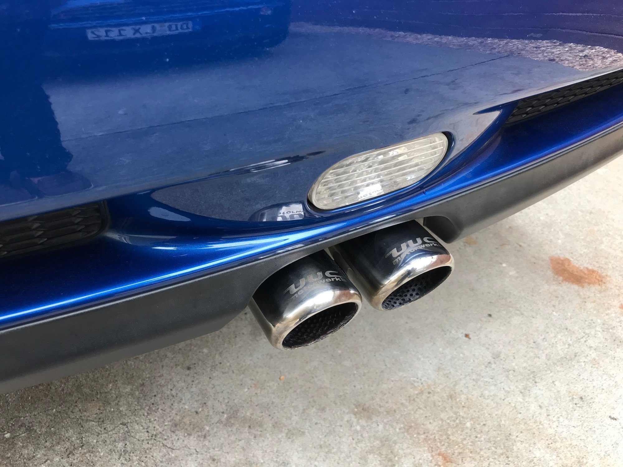

Next up I swapped out the JCW exhaust for the UUC junkyard find.
I’ve gotta say - if you have the chance to grab one of these UUC systems and are on the fence, my advice is go for it. This is hands down one of the best aftermarket exhausts I’ve heard to date. Little to no drone while cruising but just a nice hum to let you know something is different. But any amount of throttle input and the car sounds very throaty and deep. This is not one of those droning, raspy, annoying exhausts but truly a worthwhile upgrade. If you have the chance to pick one up I would highly recommend it. It may just be a placebo but the car also feels quicker. I don’t know if having the M7 intake and the free-er flowing exhaust helps at all but it feels stronger.
I’ll try to get a sound clip in a few days for future reference. (I can’t find any online right now)

Yep! Super glad I had the chance to pull it. It needed a bit of welding repair but not much at all.

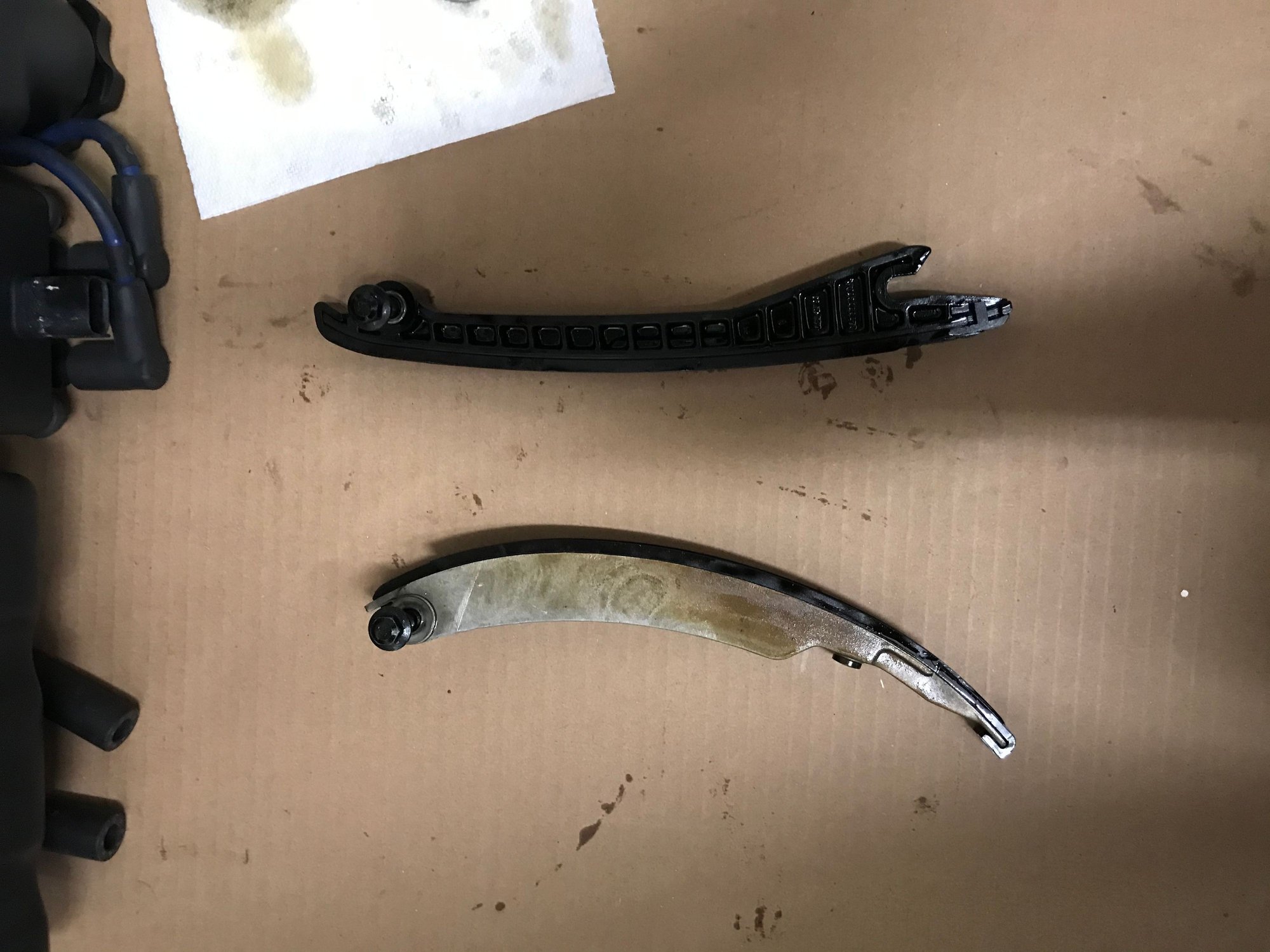

I'm thinking it's time for a chain and guides replacement now. At ~143k miles on the original chain and guides with the previous owner driving the car around with the sticking tensioner I am guessing that the chain has finally stretched out just enough to smack the tensioner in on startups... The bright side is I'll get a chance to replace my belt tensioner that has also been making more of a racket these days.
If anyone has any tips/tricks or even ideas for anything else I should do while I have the timing cover off please feel free to let me know. So far I'm planning:
Chain, guides, tensioner, timing cover seal, oil pump seals (2), guide bolt cover seals (2), front crank seal, oil pan gasket (broken guide retrieval), and the belt tensioner.
I'll also be going with MINI parts from FCP for the chain and guides. Not something I want to do again for any reason really, and surprisingly the MINI chain is cheaper than the OE replacement. Of course I'll also be dropping the oil pan to grab any of the broken guide pieces that are in there (I know there is atleast one).

Putting these here for future reference. Hopefully they save someone else some time if they have similar chain rattle issues:
https://www.northamericanmotoring.co...ain-cover.html
https://www.reddit.com/r/Catastrophi...sembly_failed/
And a helpful visual from WayMotorWorks:
From WMW's website. Appears to be stretched chain on left and new chain or right.

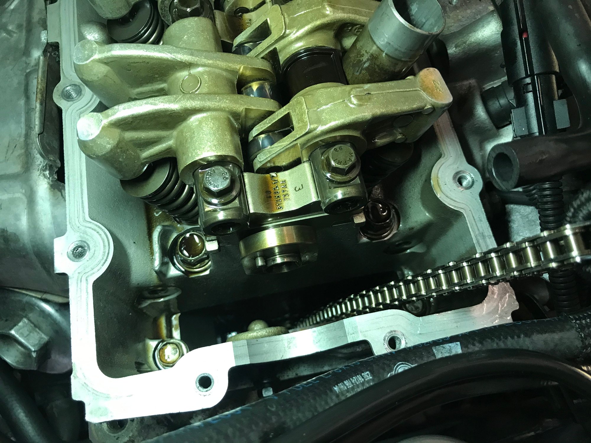

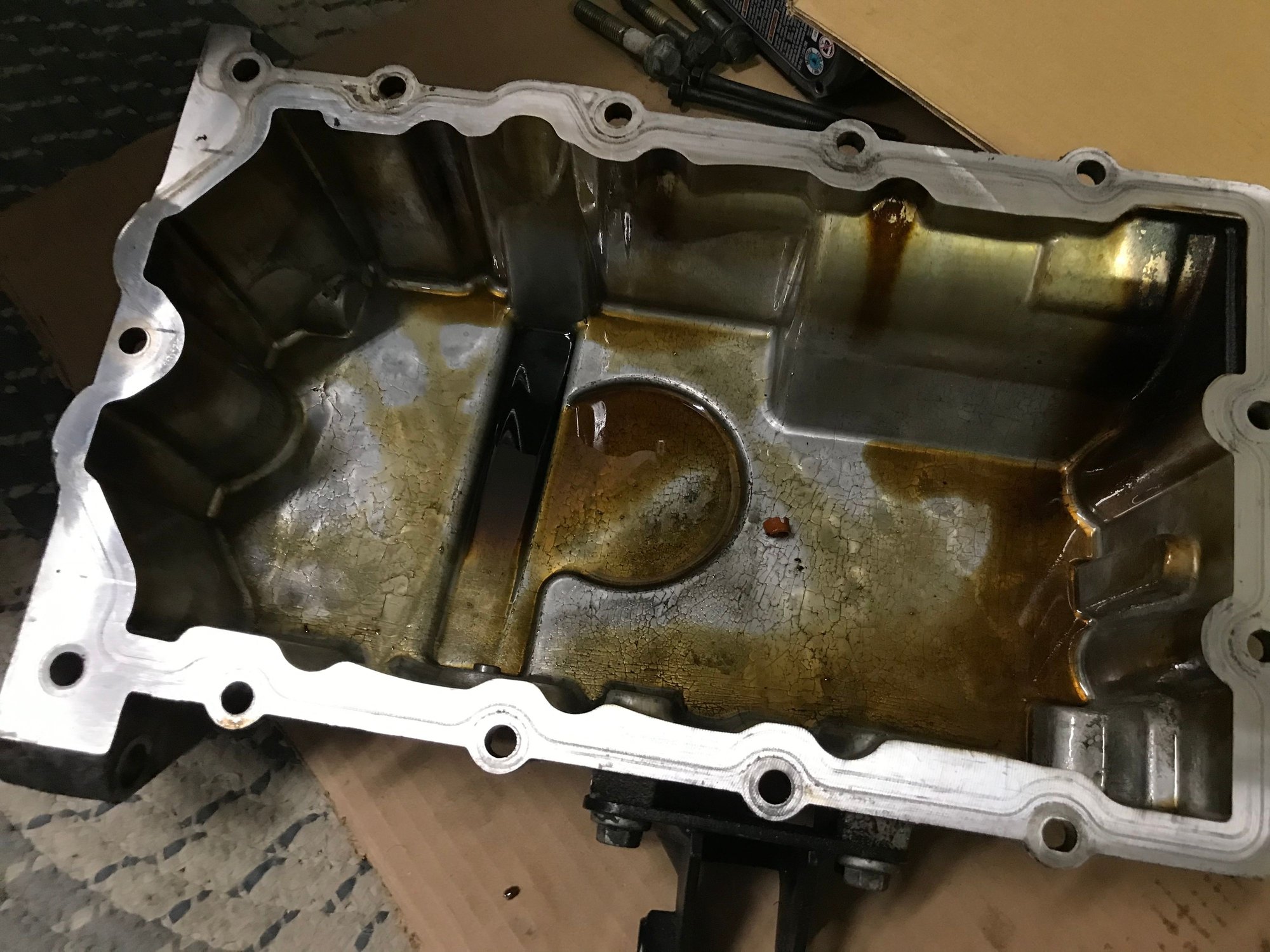

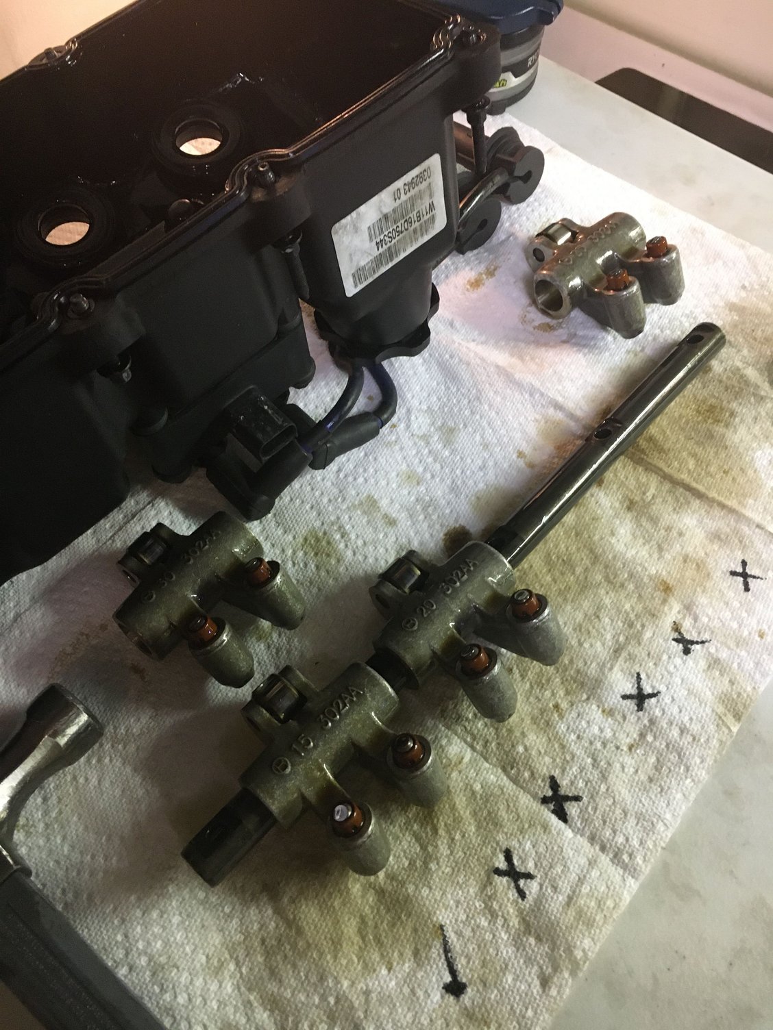

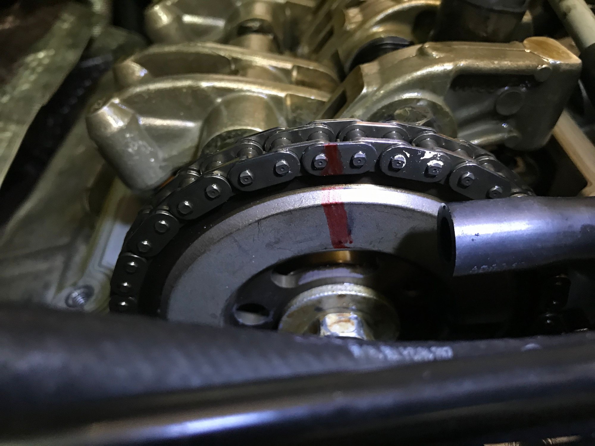

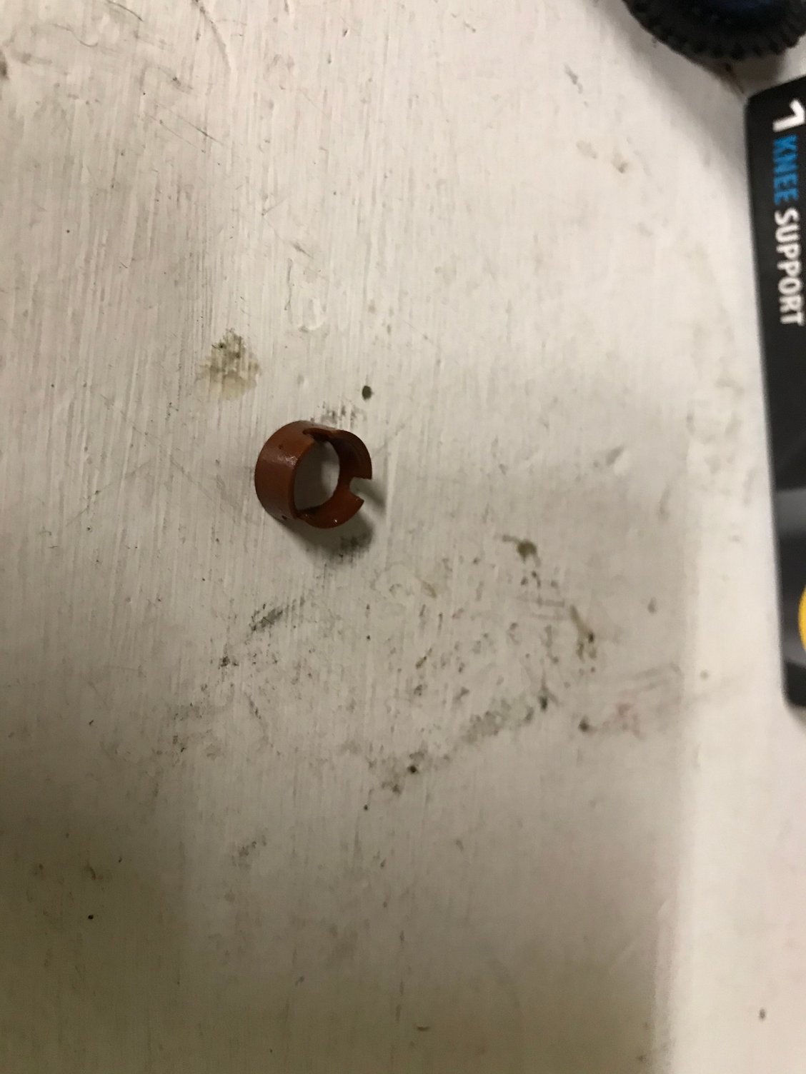

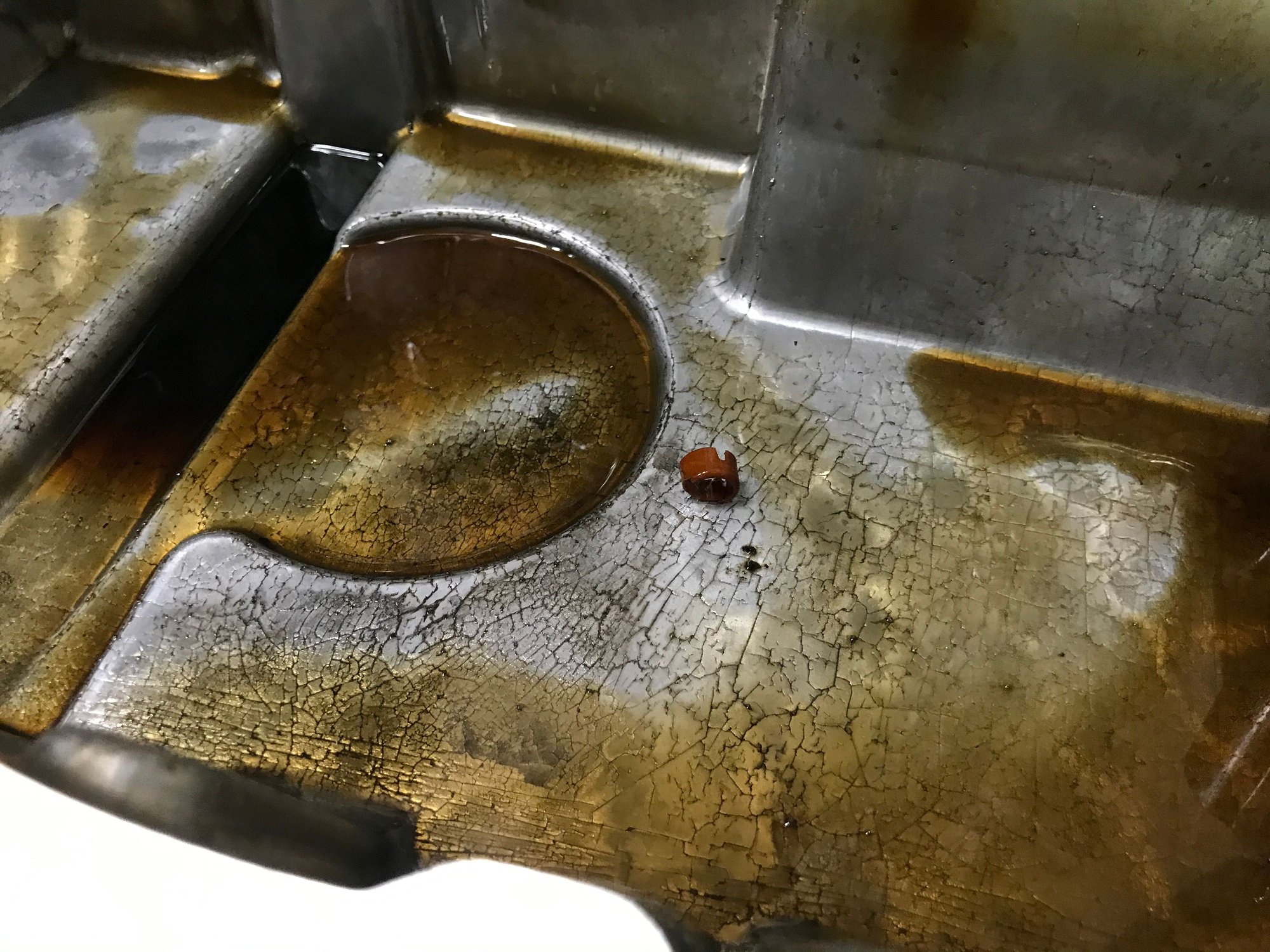

I knocked out the timing chain guides in a day as well as the oil pan gasket. I was expecting to find the broken chain guide in the oil pan but instead found a broken hydraulic lifter plastic tip. That explains the ticking I've had. Here are a few pics of the chain guide job:

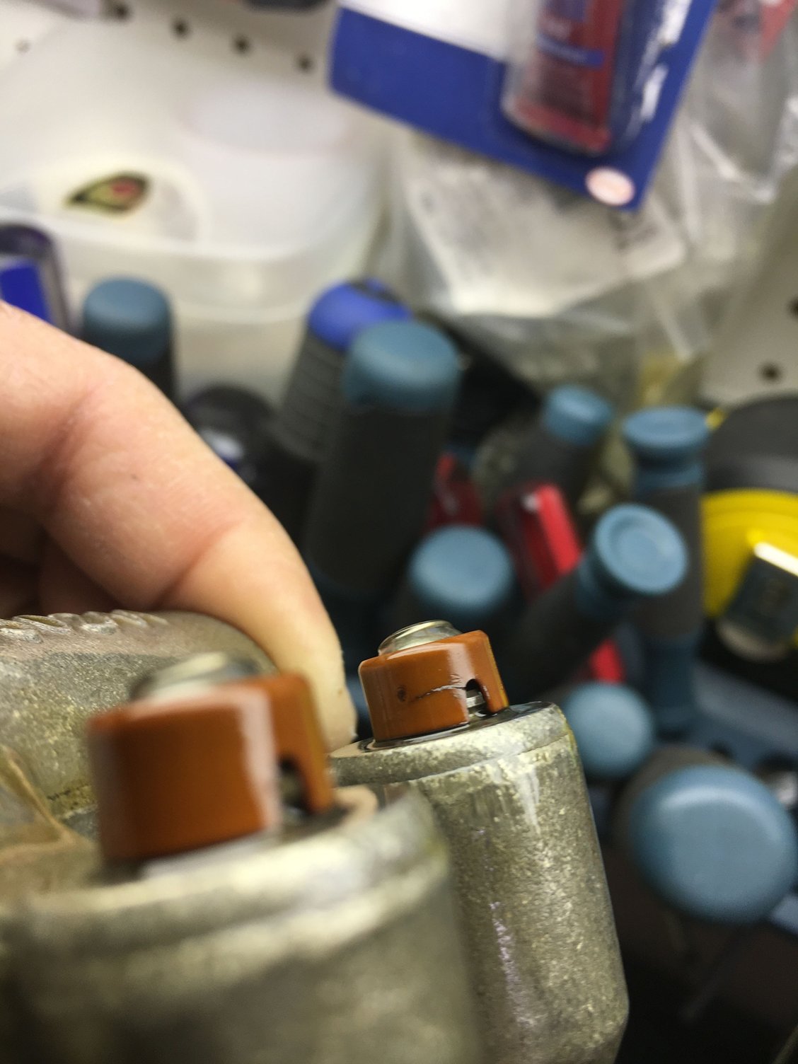

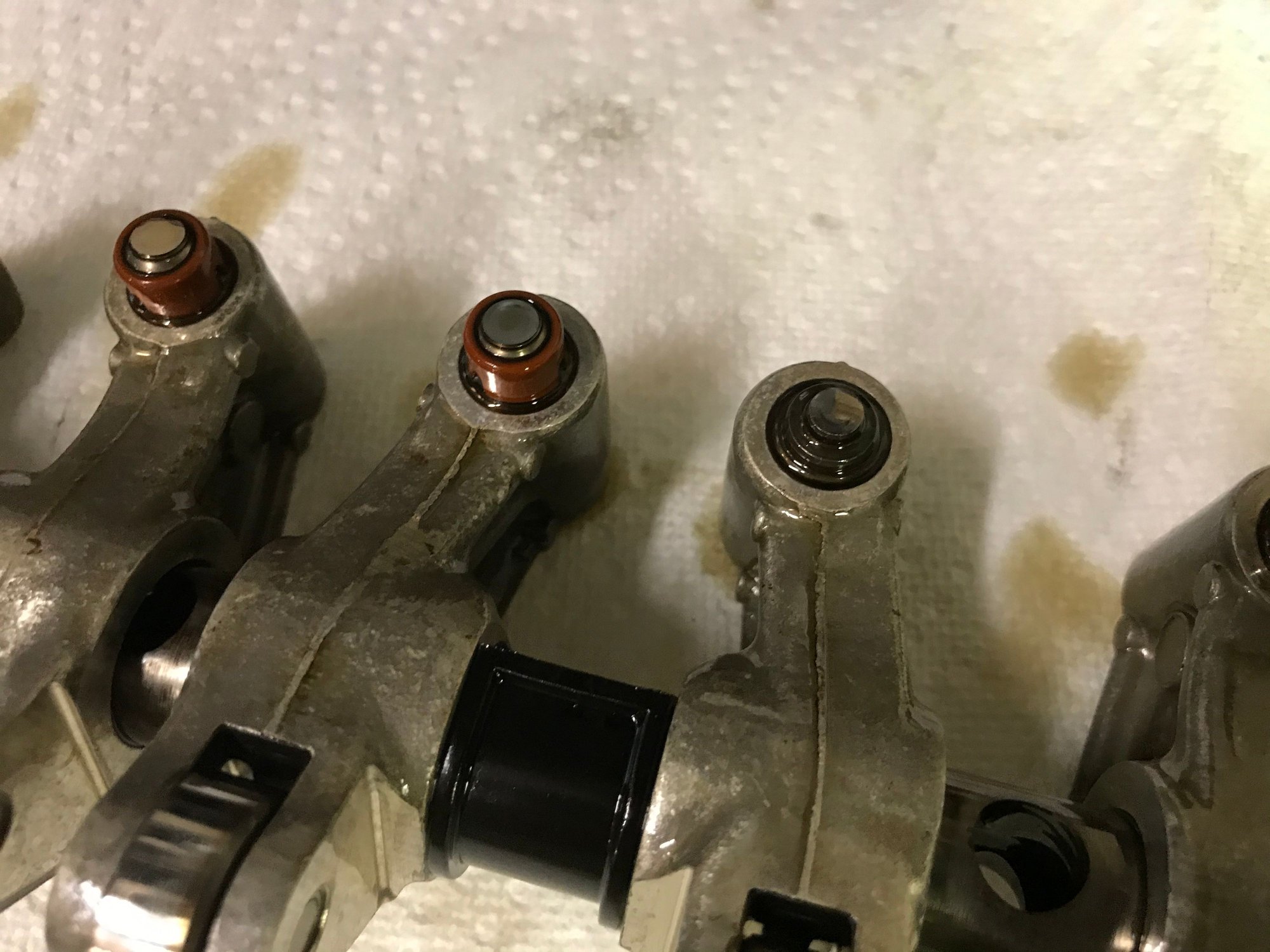

About 2 weeks later I swapped out a few of the rocker arms since I found 5 intake side lifters with cracked plastic tips and 1 exhaust side badly cracked. All in all a pretty simple job, just be careful to not catch the plastic caps of the lifters on the spark plug tubs to avoid cracking them.

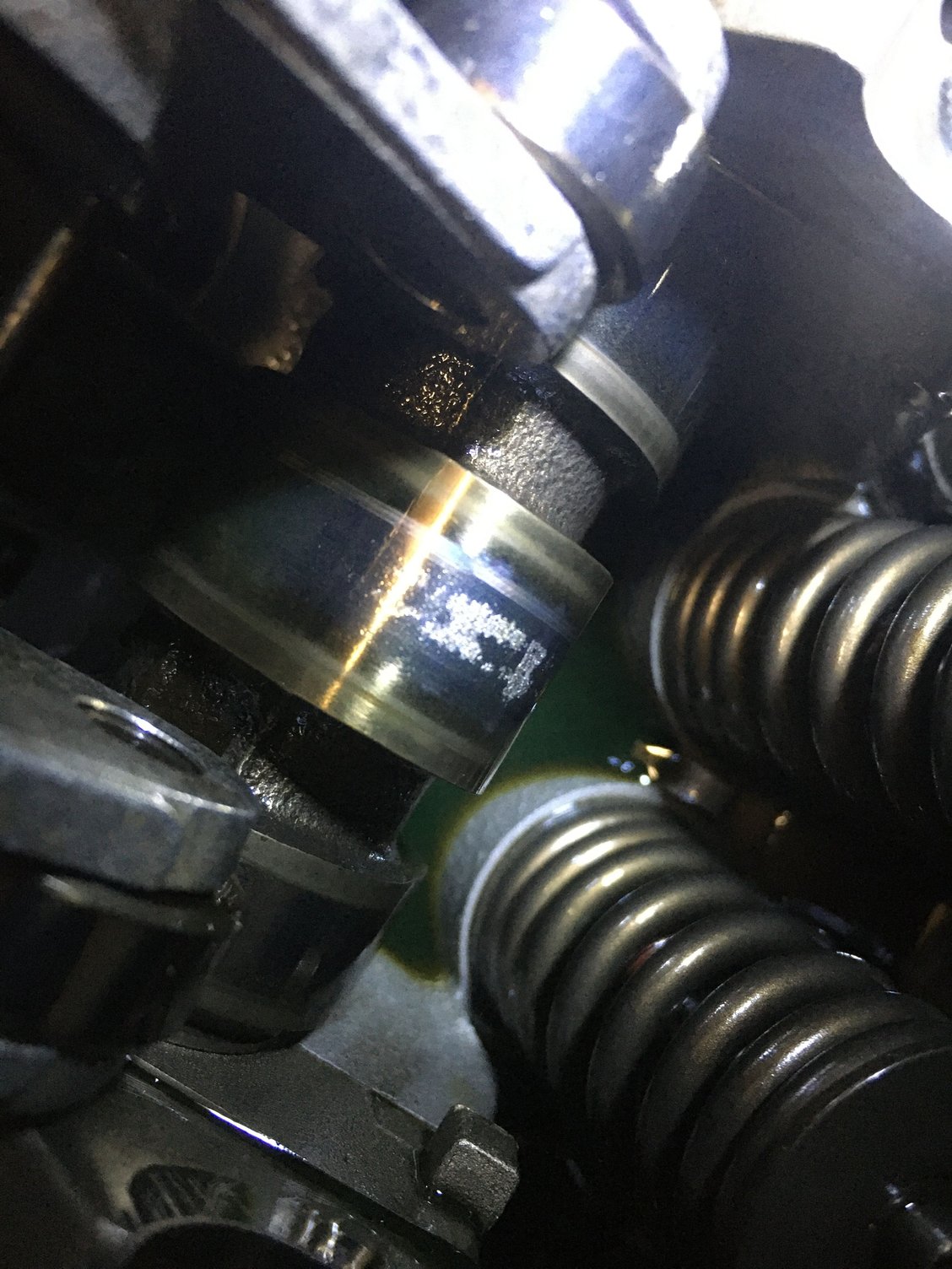

Also found a bit of camshaft wear but the car runs great so I'm sure it'll be fine for now:
After all the work the car runs great with no more weird noises and the ticking is gone since the lifter change. It might just be a placebo but the car seems to pull harder with the broken lifter being swapped out. All cleaned up after testing some turtle wax ceramic coat:
