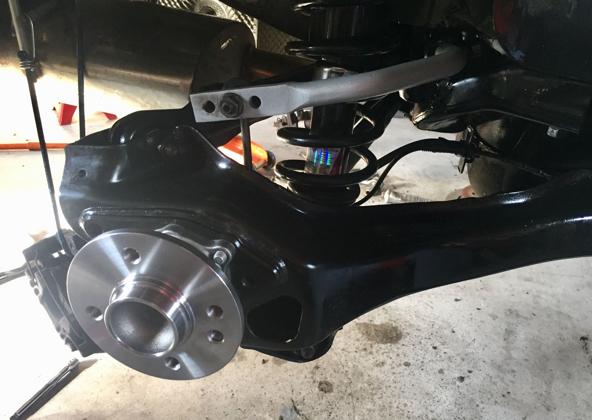

New hubs, shocks and sway bar

Looks good. Did you paint and refinish some of the rear suspension components or is what I am seeing all new?
Just the hub and shock. I just cleaned the control arm etc. The car is really mint in terms of chassis.

That looks like Whiteline RSB from your next door neighbour country.
Good eye!
