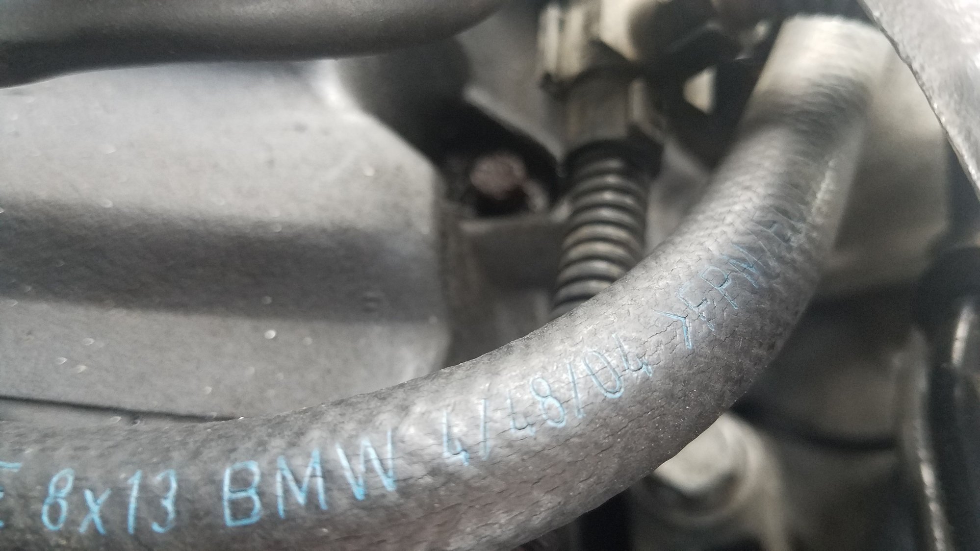

Originally Posted by BlwnAway
I'm a little confused as to where it's leaking since the actual hose never meets any of the injectors.
That line has 60 lbs of pressure in it with the engine running, I'm really surprised there isn't some kind of spray visible.
Pull the intercooler, have someone else cycle the key from of to run (not start) a few times to build pressure in the system while you move and pull on things.
Then if you still can't find it...
If it were me, before I started looking at replacing the line, I'd pull and clean the quick connect between the line and the fuel tube, pull all of this injectors, inspect and clean the injector bosses in the intake and fuel rail, and replace all of the O-Rings. (don't forget to lube them)
After following your advice and pressurizing the system I'll agree that its probably not the fuel line. The only thing near the line where I'm finding fuel is the far left injector.
Fuel spray was found in this area, just as the line tucks under the intercooler and sc horn.
A little corrosion but no noticeable leakage. The glossiness is from disconnecting the line.
Old Mar 6, 2019 | 08:08 PM
BlwnAway's Avatar
BlwnAway
Joined: Nov 2004
Posts: 2,607
Likes: 315
From: Arnold, MO.
The push-ring looks slightly skewed, probably not a big deal, but could be a sign of some unwanted buildup there.

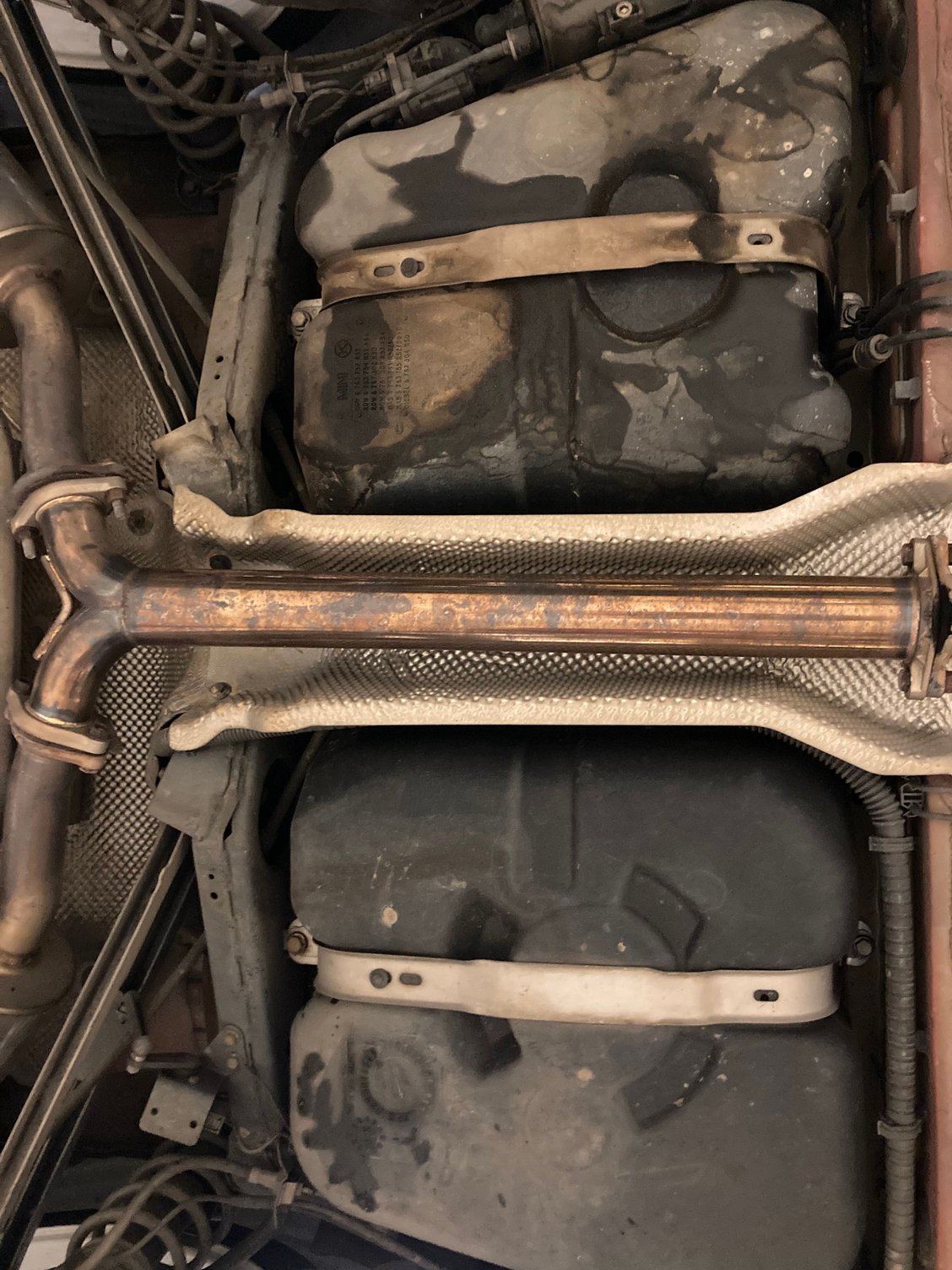

Old Nov 6, 2022 | 03:21 PM
cooperwiththemini's Avatar
cooperwiththemini
Joined: Dec 2021
Posts: 28
Originally Posted by Tgriffithjr
Thats exactly the issue I have except it will start right up on two cranks after sitting overnight and with no hesitation from off to start on the key. Other times I can shut it off then try to start it ten minutes later and it will crank repeatedly and the sputter to life. Haven’t figured this out yet. New fuel pump and filter. Should the fuel system maintain 60 psi even after the pump initially shuts off after priming? Mine will immediately bleed down to zero after pump shuts off. But still doesn’t explain why it will start right up sometimes and not others.
I have the same problem, I suspect a leak above my gas tank on the right side because of the gas tank appearance. A picture and my codes are below.
