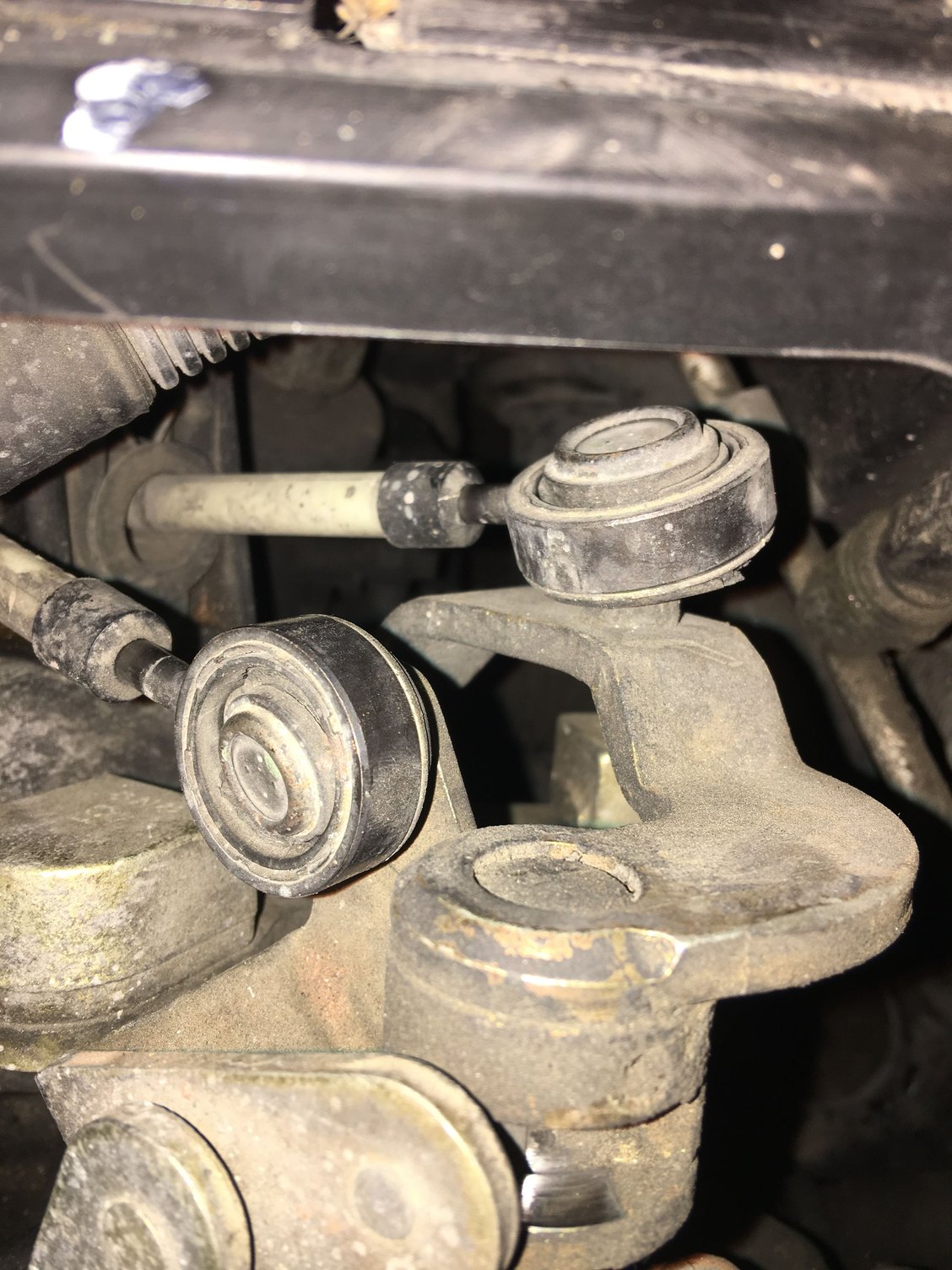

Did you check to make sure the cables are still anchored correctly? And it could be the bushing at the connector has failed.
For the transmission side, hard to get to under most of the air inlet piping, and under the shifter lever in the cabin for the other end.
see image (Thanks Pelican Auto Parts)
AS for the cables, you would only have to replace the one that has failed, but some would argue that it is a false economy to replace one without replacing the other, but since cable failures are so rare, I disagree with this view point and say just replace that which is broken. (cables are about $100.00 each)

The shifter doesn't feel different and will go into each gear just not engage (winding / spinning noise).
After reading the feed back and after review of both cables have opted for option 1 replacing both cables. (and praying not the gearbox). The seal on the one appears to be very warn and maybe even split, the other not as bad but equally ​​​​​​​questionable. I will update with my finding and hopefully success.

If you can feel the distinct notches (detents) in the shifter at 3rd and 4th, I can assure you that your problem lies likely not with either cable as I have remarked. Best of luck.
