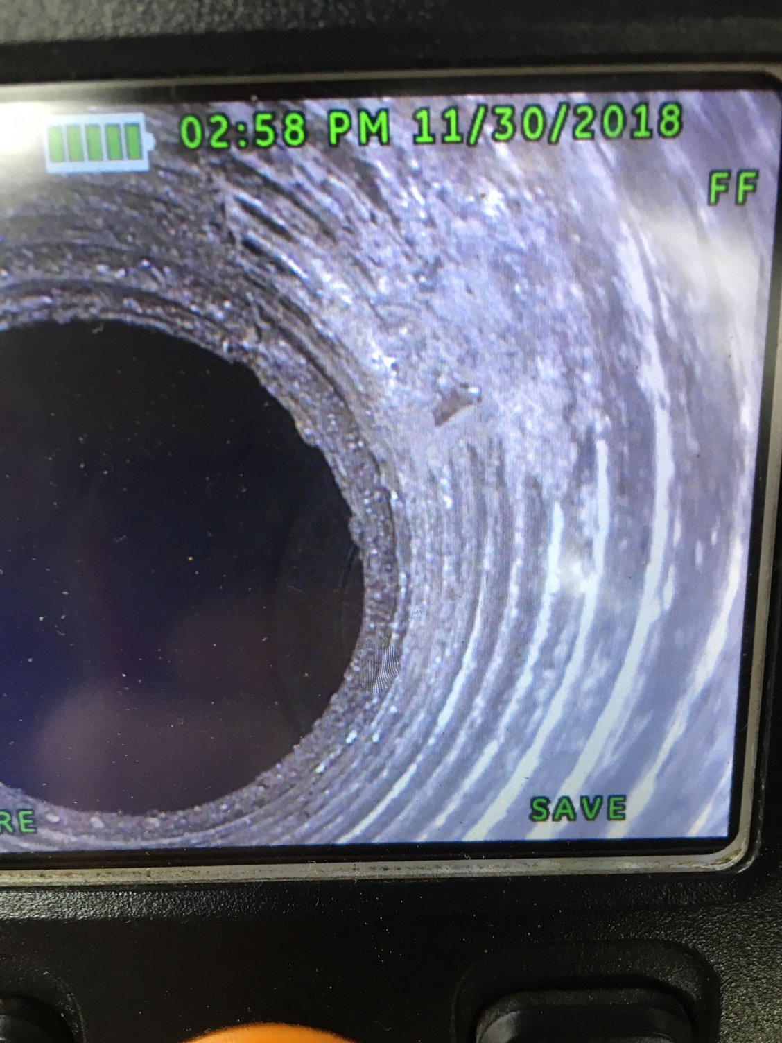

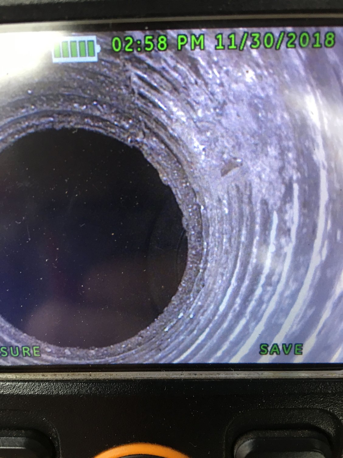

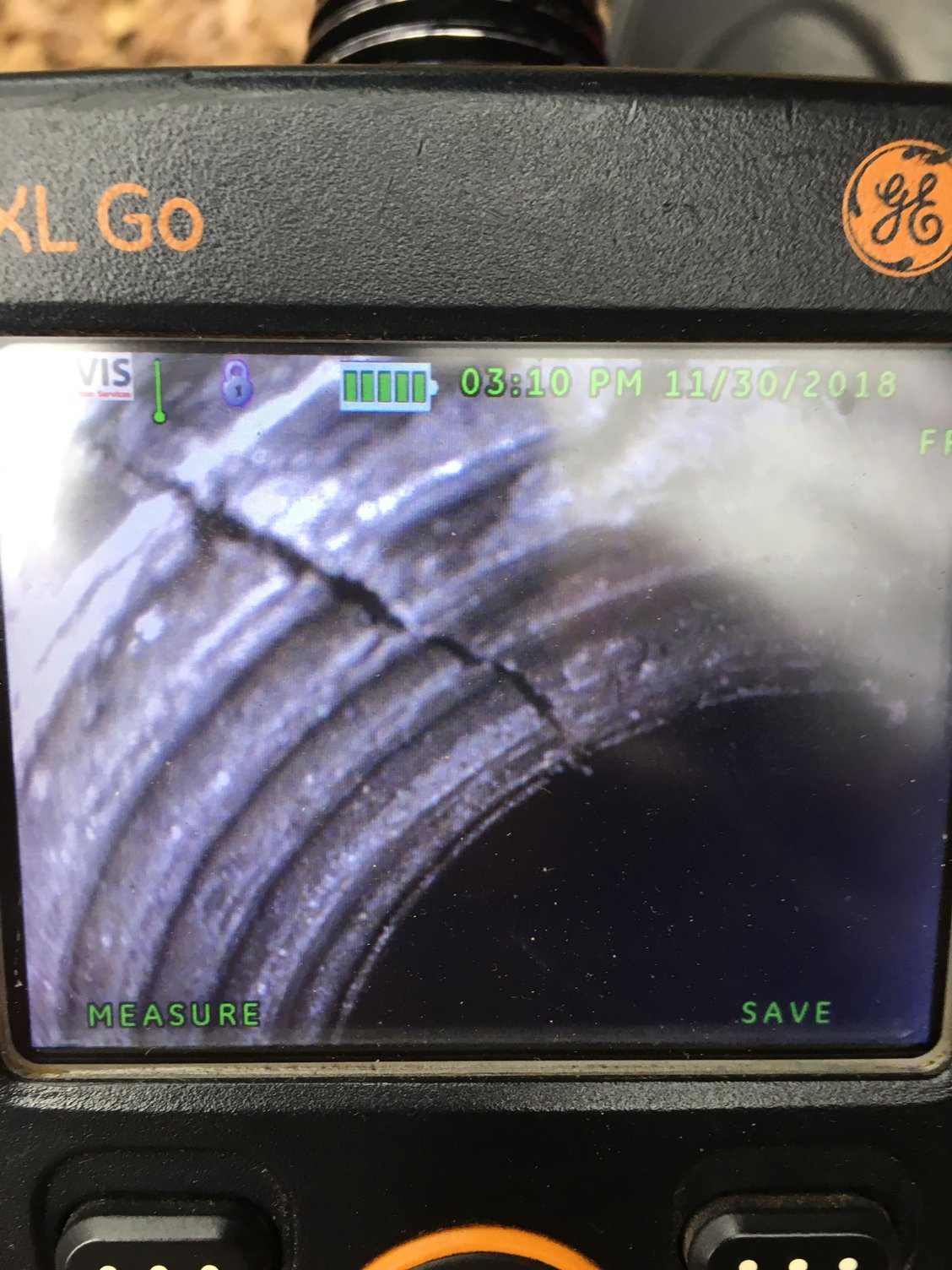

Hi all,
(2004 cooper s 160k miles) so I was driving home from work yesterday and about halfway home, I started to feel a misfire. Made it home on 3 cylinders and once I got home and opened the hood, the spark plug flew out of the cylinder head (didn’t hit me thankfully). I inspect power plants for a living and have access to nice borescopes, used the
scope to inspect the threading on the head and found two cracks...(see attached) the answer seems obvious but it looks like I’m in the market for a new head. Would I have any luck with a time-sert or heli coil? Any input is much appreciated!

I think it is time for a new head, as it is showing casting break down. Make sure to use premium fuel in it.
Using heli coils or other fixes like it, might only be a stop gap for a new head. Mini had problems in the gen 1s with head castings, although, they will never tell you that!
This is a very unusual type of failure!
Keep us posted on what you do!

There isn't a cam seal per say like on other cars.
This is what all we do with a cylinder head job.
https://www.waymotorworks.com/wmw-he...0-r52-r53.html
FYI we see cracks like that on R53s that have a pulley, but the owner didn't run the colder heat range spark plugs.

I had 3 cracks when I replaced my head. Have Sprintex, PO never changed to colder plugs (and never replaced plugs at all).

New head is on and the car runs great! Here is what the bottom of the head looked like:
two cracks found

It looks like the combustion was higher than the aluminum casting could handle. It looks like metal is deposited on the exhaust valves. Wrong heat range plugs, low octane fuel, too much timing advance, etc.
I had an aluminum headed D gas engine and very high combustion temps did similar damage (v8 small block Chevy) (in the sixties!) old fart here!
I would not consider fixing it on my car! I would hate to have to do a repair again, sooner than later! You can do many things to repair heads, but these Mini heads are not hard to find!

The Borescope is called an XLGO from GE. Yes they are very expensive, I borrowed this one from work. No it was not used for a colonoscopy lol, used for industrial inspections. It is a huge step up from the rigid/Milwaukee brands you can find a home depot.

I bought the car last April for a pretty good deal. it had BOSCH Platinum 4 plugs in it and there is no telling what fuel the previous owner used, i always use 93 octane. After I replaced the head, I put colder range NGK plugs in it torqued to spec. Hopefully the issue is fixed, I've put 130 miles on with the new head and it runs great so far. As far as too much timing advance, how can i check that? Thank you for the info.

It is always fun to find out what our Miniac's profession than just stay narrowly on topic. I figure the scope is likely for industrial inspection use, like oil and gas or metal fabrications. The resolution is too low for colonoscopy for sure. It has a 6mm diameter probe so at least won't be too hurtful with proper lubrication. For those curious here are the specs. It has MIL spec certification for what's worth. It packs a microphone and the most interesting feature is the articulating probe head controlled via a joystick.
I think the video sensor is not located at the probe head. The probe is likely consists of a fiberoptic bundle and a compact microphone.
