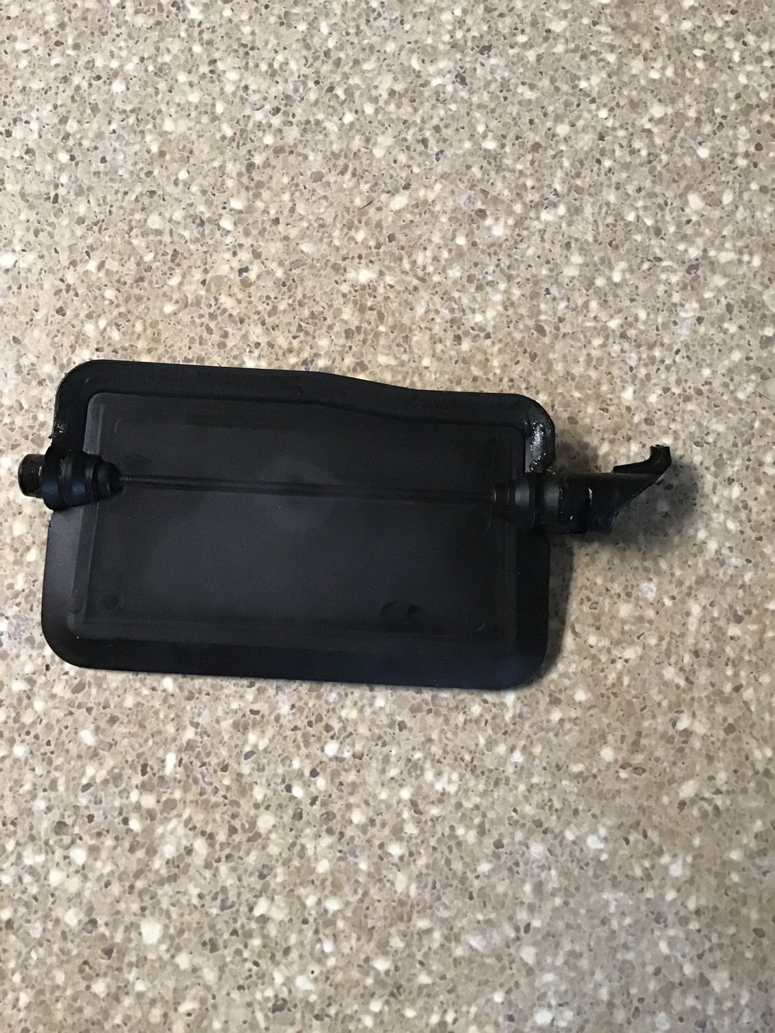

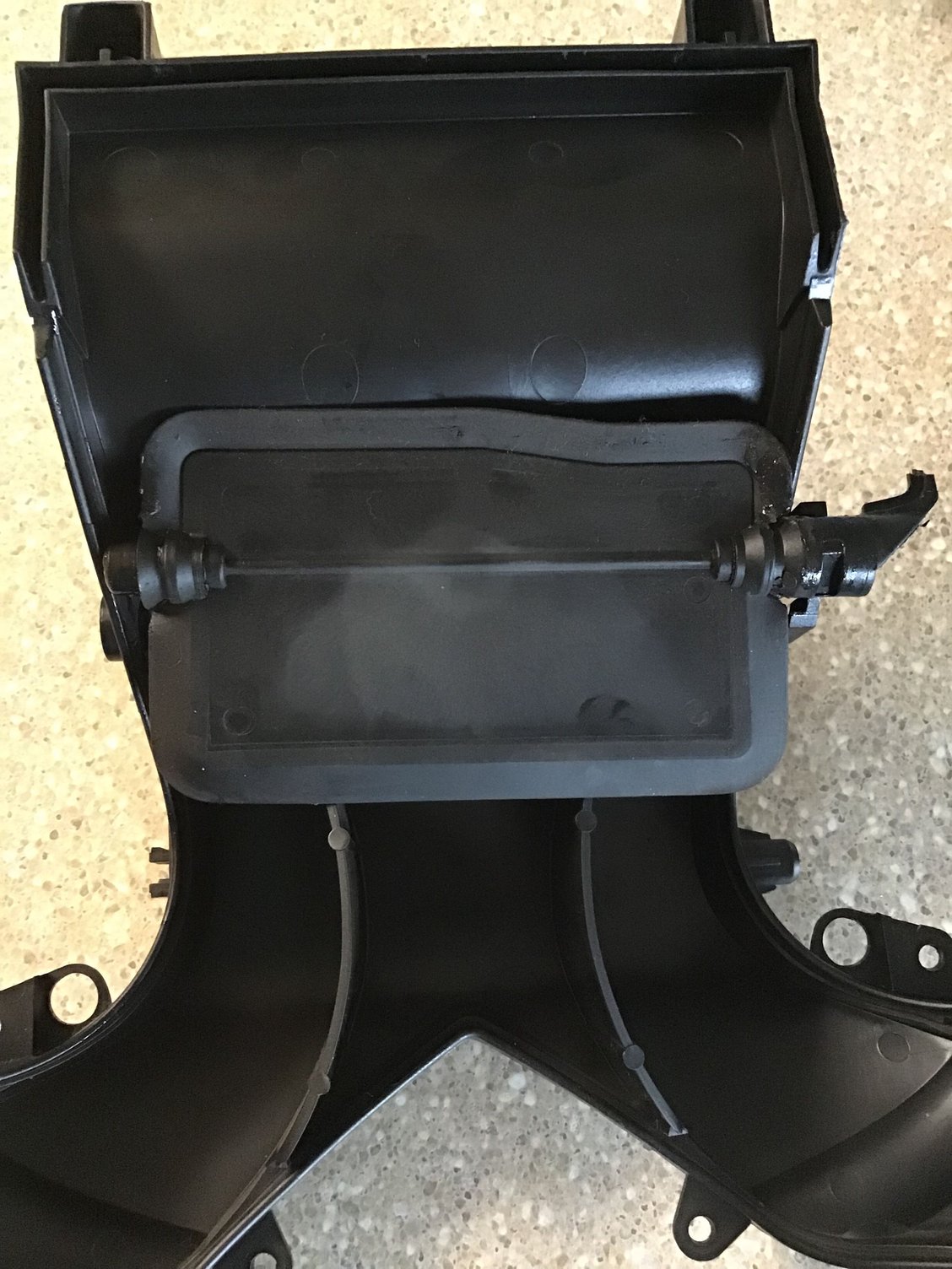

floor vent not working so took things apart and found the problem but can’t find the part. Vent door is broken. Please help
This is what I’m looking for
This is where it goes
Front look

It is known as the blend door.

I believe this is what you're looking for, it's included in a box of parts under PN# 64116910916. No idea if it's available separately, maybe give some vendors a call.
Literally a box of parts, haha.
