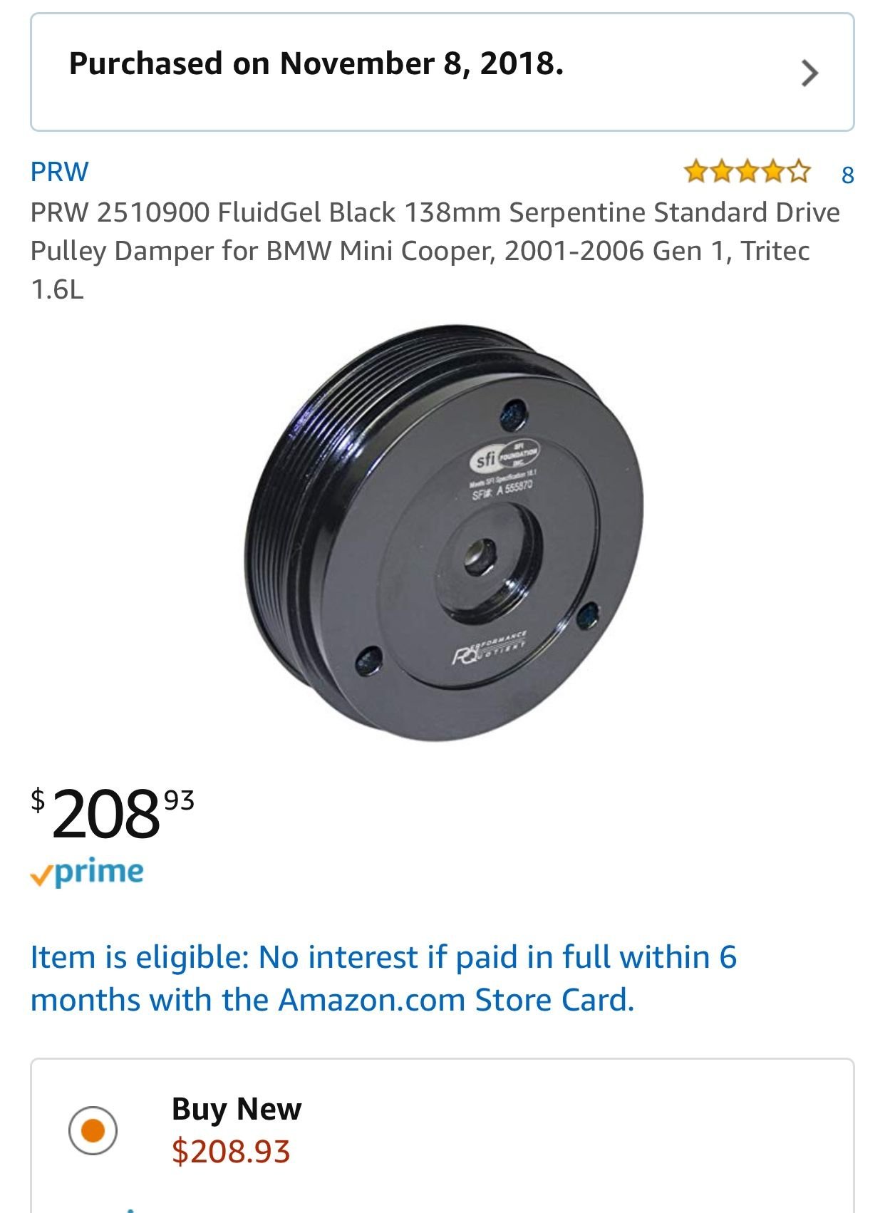

With all due respect, the factory crankshaft pulleys are garbage. Spend the $208.00 & get a quality unit from Amazon. Again, it’s not that hard to replace yourself. Once the rubber separates the car will go into creep mode and throw code P1688.

Since I have replaced the harmonic balancer, I started to get a subtle squeak from the idler pulley. Replaced and squeak eliminated. I would strongly advise you to do the same and consider replacing the belt tensioner also if after visual/hearing inspection there is the slightest doubt it needs to be changed. Scour YouTube for those vids & the signs that the end is near with that belt tensioner. It's $108 on Amazon and the idler pulley is $28.75 for the nice Gates model 36168. While your upgrading your crankcase pulley it is close to being counter intuitive not to strongly considering replacing these other pulleys.
PS; at least check all pulleys so you know when the "sound" isn't right & time to make a plan to address it.
Old, nasty, cheap, ill designed POS harmonic balancer that lasted 13 plus years and 126,500 miles. Glad its gone and a nice new hi tech fluid filled pulley is installed.
