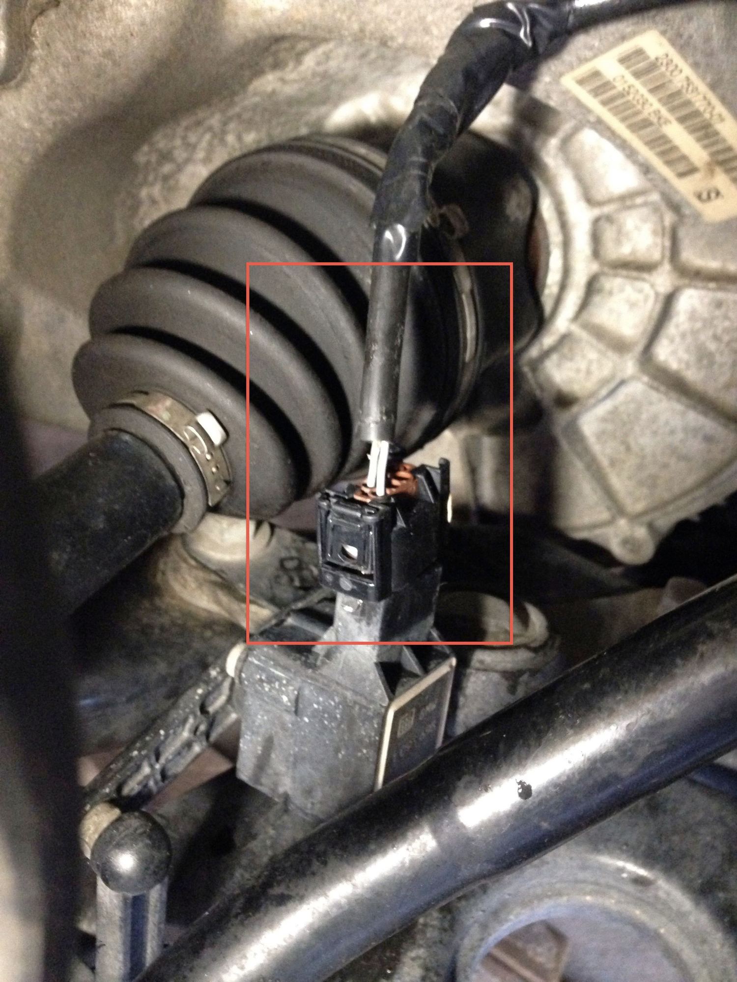

Can anyone tell me what sensor this is? It's on the front driver's control arm. I damaged the wire and need to replace it. I believe this is causing a simultaneous TPMS and DSC light errors.
Thanks in advance. This is on a 2005 MCS.

That is one of the two leveling sensors for the Xenon headlight. They have nothing to do with TPMS or DSC. The TPMS and DSC relies on the speed sensor at the hub of each of the four wheels. Do a search on R53 speed sensor to see where they are at.
