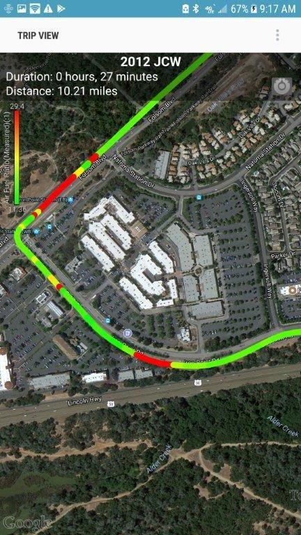

2012 JCW
2nd cat/res delete
91oct
50f IAT
You can see timing @ ~0 as soon as boost tips in, with just a few degrees negative at ~15psi. Also - AFR's like to sit closer to 11.8-12.2 @ WOT when IAT is low like this Ive noticed. When I first saw this, I was running an E30 blend.. so I ran new logs on 91oct (as above) and saw roughly the same boost levels/MAF reading/timing/IAT. I think the ECU doesnt like to boost as much when the MAF reading is high from the colder IAT. Once IAT is ~80f .. i see boost up to ~19psi, but have NEVER been able to see this when IAT is 'cold'.

r53 does not have this problem, boost is fixed with rpm
