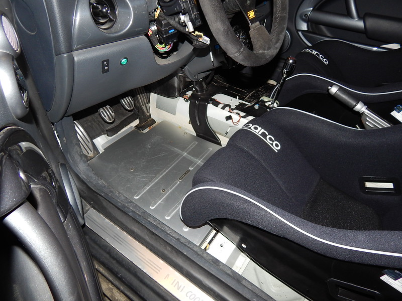

Where did you get your foot plate for the driver's side? Very nice
Old May 20, 2019 | 09:05 AM
Mudhen's Avatar
Mudhen
Joined: Aug 2013
Posts: 154
From: Eliot, ME
Rennline Track Mats.
http://www.rennline.com/Track-Mat-MI...ductinfo/TM22/
