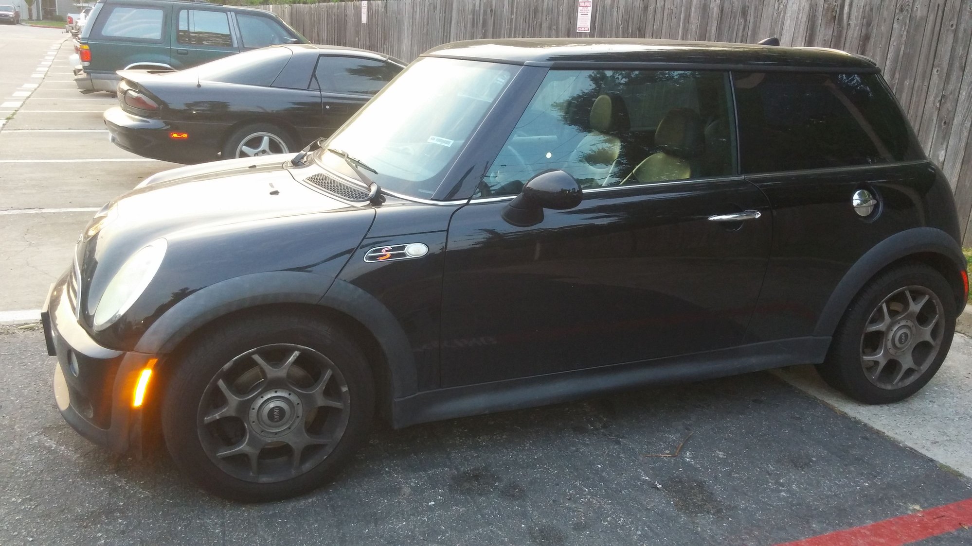

Went to see a 2002 mcs with a new engine but the seller stood me up. Was pissed and drove home, enroute I get an alert for a 2005 mcs with a clutch pedal on the floor. Smoker's car and not too well cared for. 161K miles but the body looked good. Some paint flaking around the passenger fog light. Had to jump the car to get it to start up, but could not drive it due to the clutch pedal issue. No codes on the OBDII reader. History from the owner is that it was fine, no clutch slippage but one day the clutch went to the floor as he was driving. Able to drive another 5-10 miles home parked it and now wants to sell. Guy tells me it is the clutch and will be expensive to fix about $2000. I tell him it is more like $3k at the dealer. It has about 5-6 very small door dings and some paint flaking around the passenger's fog lights, both drivings lights have cracks in the glass, and the antenna is broken. Headliner is falling down. Plugs and wires were changed 30K miles ago. Does have new tires, all-season Goodyears :(

We agree on a price and I tow dolly it home, what a miserable experience. Pull the battery to get it on a trickle charger. Looks like the battery has been for a swim.
Some of its issues are a failed passenger engine mount, coolant reservoir leaks, drivers seat torn, generally smelly, dirty smoker's car, both strut mounts failed, failed lower engine mount, and an oil leak on the passenger's side (possibly from OFHG) as the oil cooler looks pretty clean). Both inner cv boots have oil on them but I think it is oil spray from some where else.
Don't really like the hot air induction
Most likely the culprit of the clutch pedal on the floor
Old oil leak from the crank position o-ring. Seem pretty dry now, will leave it alone
Majority of the oil leak is superior to this area, which makes me believe the OFHG
Valve cover gasket is probably leaking
Also have this sound possibly coming from the PS pump. For sure not the serpentine belt which looks pretty new.
All in all not bad for what I paid.
