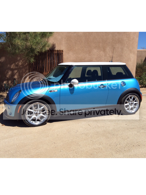

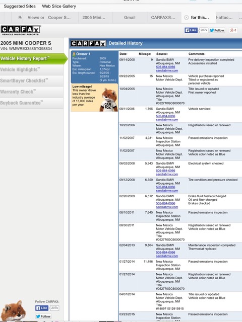

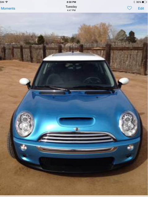

So before I purchased my Mini I had no idea of all of the issues they have had. When I bought him the car had 14,500 miles and I bought him in April 2015. Since the purchase I've replaced all the run flat tires, engine mount, got an alignment, front brake pads and rotors replaced, 2 oil changes and am now being told by the local shop the thermostat is leaking and the power steering hoses need to be replaced. The bill seems to be going up and up and at this point I'm wondering if I should just look at getting a new Mini.
I have no idea if I should sell it outright or what I would get. He was garage kept, all service done at the dealership, with the exception of the last oil change, pads & rotors, engine mount. With regards to the thermostat I've just pulled out the car fax report for him and the thermomstat was just r placed in 2013 so supposedly it needs to be replaced again with the car having such low miles?
The car looks brand new and has the leather seats, navigation system and only 28,000 miles. If I finance for 4 years with the cash I get from selling my car payment with be around $$210 a month. I feel horrible even considering selling him but I know absolutely nothing about cars as I'm a woman and after ready my about all the issues they have am wondering what everyone else would do if you didn't know how to fix your mini's .

Hi, I purchased it with 14,500 miles not 145,000 it only has 28,000 right now

My mistake! Wow where did you find that? Well if it helps those are the typical failure items. The engine mount is surprising with such low miles though.

I uploaded photos of the condition which is excellent, old lady never drove it so the car was 10 years old with 14,000 miles. I only drive 6,000 a year so that's where are at now. I'm just trying to be realistic as I don't fix cars on what I can expect. I have someone who is going to give me a second opinion on the power steering cables and thermostat which was just replaced in 2013 so I'm assuming it needs to be replaced again (so this will be twice in four years - which to me is ridiculous) Before I chuck a bunch more money into it I'm trying to figure out what I should expect.

You have a nice low mileage mini and from the pics it appears to be in a non winter area of the country. I can do my own work, you cannot, so if you are set on selling it, suggest you forego any more work, put it on Craigslist. Kelly Blue Book (KBB) will give you a good idea on what the car is worth, in the $6k range. Most people selling a car have a hard time accepting the KBB price, but most buyers will go by it. You should also post the car here as most here knowing the car should give you more than the guy on the street and KBB. The dealer is going to give you about $4500 regardless what their math says.

NICE MINI BTW !

YOU HAVE ONE OF THE BEST TWO YEARS! It is a beautiful loaded S. It has the rare chono package, strong W11 engine, High end wheels.
