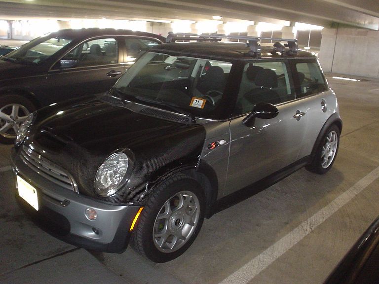

Bought and Installed CF Hood
Well, after not receiving a response from either the sellers at ebay nor ViSRacing, I decided to take the plunge anyway. Here is the result. The whole think took about 5 hours working mostly by myself and without a service manual. I did run into a couple problems but was able to work around them. First was the hood box at some point was flipped upside down at some point and the front was broken and CF bent. Fortunately all of this would soon be located behind the grill so I proceded anyways. The other problem was that one of the bolts that was epoxied to the underside to hold the air flow duct did not line up and I ended out breaking the glue contact. I was able to use some two part epoxy and put it back on but it was very time consuming cause the glue kept melting the old glue and not sticking once the two mixed together.
As far as weight goes, the new hood definitely weighs less but after you put the headlights, grill, and everything else back on, it feels about the same. I did some investigating and could not find where an aftermarket hood was not street legal so the statement by ViS "For Off Road Use Only" is probably only there to keep them from being sued. There are prebuilt latches that match the OEM hood on both sides so it feels very sturdy when locked down. The hood from ViS does come with most of the holes predrilled, including the cutouts for the windsheild washers. Most of the accessories lined up fine and the overall shape was very close to the oe hood. The hood actually latched shut on the first try and didn't need to be modified. It does rub when opening but I think I'll try a heat gun at a later time for the minor shaping. I still need to put the plastic archs on and will be replacing the bumper with a pure silver painted Aero bumper that's on order through Classic MINI.
Overall, I think it worked out well and looks pretty good too. I'm debating pure silver racing stripes and CF mirror covers; any recommendations?

Old May 13, 2005 | 11:33 AM
minihune's Avatar
minihune
OVERDRIVE - Racing Champion
Joined: Feb 2003
Posts: 15,262
Likes: 72
From: Mililani, Hawaii
Nice.
Did you weigh the bonnet before you installed it?
Supposed to be about a 19 pound weight reduction.
That should lower center of gravity a little and reduce weight in the front which is normally about 60-61% of the total weight.
Old May 13, 2005 | 11:44 AM
bee1000n's Avatar
bee1000n
Joined: Jun 2004
Posts: 1,522
From: San Diego, CA
Nice work! I would paint the majority of the hood PS, and create racing stripes by leaving that part of the CF unpainted. Not sure if that makes sense - basically the opposite of what you said. I'd rather have the subtle suggestion of a CF hood than black hood.

Old May 13, 2005 | 01:26 PM
leo's Avatar
leo
Joined: Sep 2002
Posts: 5
My initial intention was a result of an accident I was in a couple weeks ago. I am paying out of pocket so I wanted the cheapest method of attaining as good if not better repair of damage. I live in Atlantic City and have only been here for a couple years so I had no reference of good paint shops. The only references I could find were negative. Because of this, I decided to look for painted parts. Not finding any luck with used parts, I found the CF hood. Figuring that I could paint it later if I found a place, I went for the CF hood which ended out probably costing me the same as what a new hood painted would have cost. In addition I ordered a factory painted bumper from Classic MINI so I didn't and won't need to bring my car into a paint or body paint shop at all.
