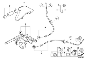

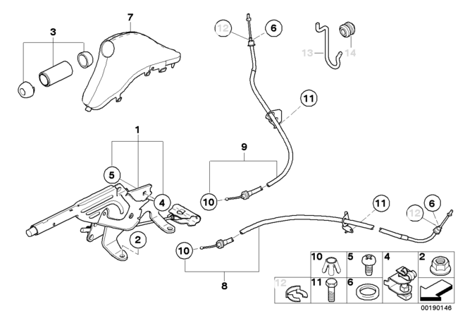

You've done as much as I probably would. I'm wondering if it's the lever unit itself that's squeaking. Maybe the joint sections? I know you said you sprayed it down, but maybe try cleaning off the unit itself and only spraying the joint areas. Can you expose the area enough so that you can work in it and wiggle certain sections to see if you can recreate the squeak? I'd pay close attention to each area and maybe use a cloth to place/wrap on an area and then drive around to see if that eliminates the noise. Hope that makes sense. If worse comes to worse and you've determined that it's 100% coming from the unit, you could replace it if you really wanted to: http://www.pelicanparts.com/cgi-bin/...-6-774-814-BOE. Hope you get this figured out.
