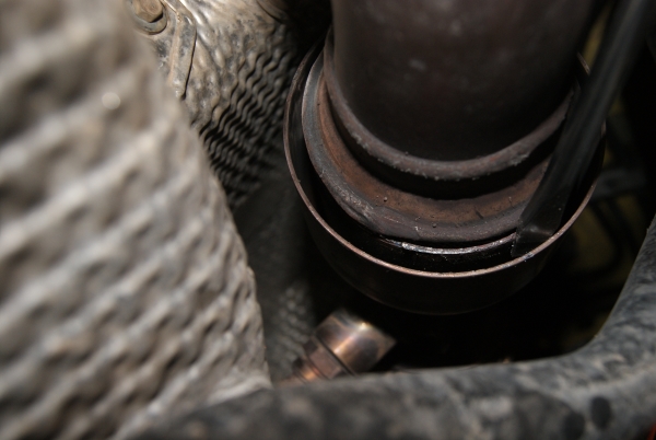

Pics from my experience…

Underneath the car and over the swaybar

I will certainly look for that. How is that normally supposed to look when it's in place? One solid piece? Does the metal of the lower part connect to the outer (housing) of the upper part? Reason I ask - it looks like there is metal around the white thing in the center, which is then surrounded by the housing.

It may be difficult to see if it has cracked… run the test that cristo mentioned and see if that helps.
Below is a pic of what the factory manifold looks like in ONE piece. The manifold/header is in a tough place. It is secured to the cylinder head (backside of motor, in front of firewall) and then attaches underneath to the exhaust system. It has nowhere to move. So when the motor revs/moves over time, it puts pressure on the manifold/header and locates the “weak link”. Picture a piece of wire that you fold back and forth many times. What happens? The part where the crease forms becomes weak and eventually cracks and snaps. Similar process here with the factory setup. That is, of course, assuming that this is what you are experiencing now.
I don’t think MINI thought that there would be any weak links on the factory header. Apparently, there are and this is common. I understand that this break may be accelerated due to motor/transmission mounts that are shot. They would allow more movement and flexing to put pressure on the manifold/header.

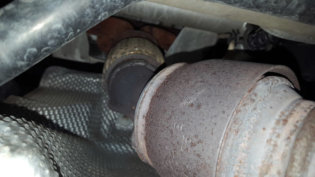

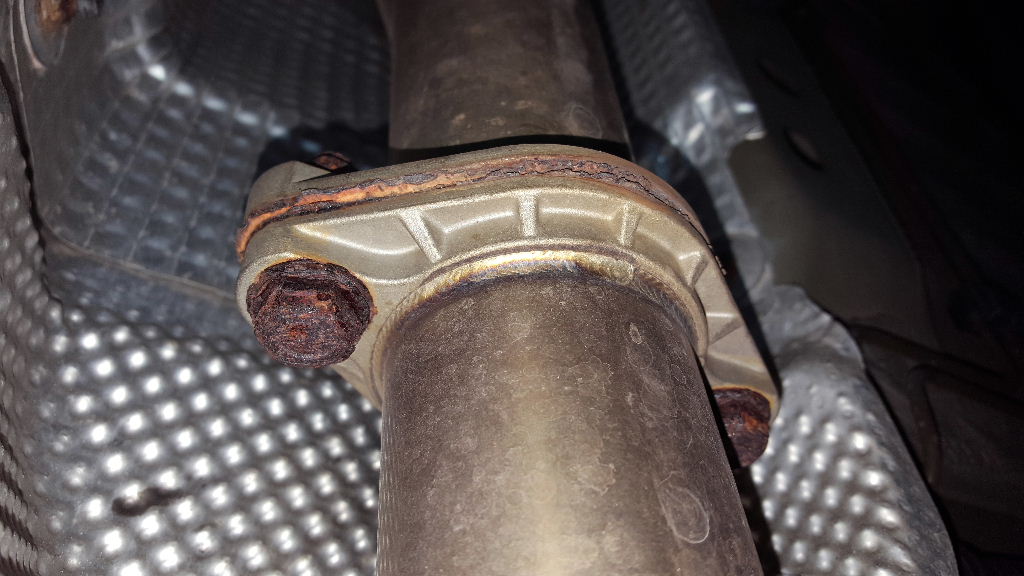

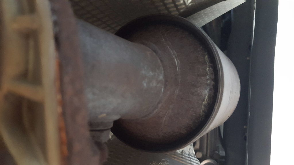

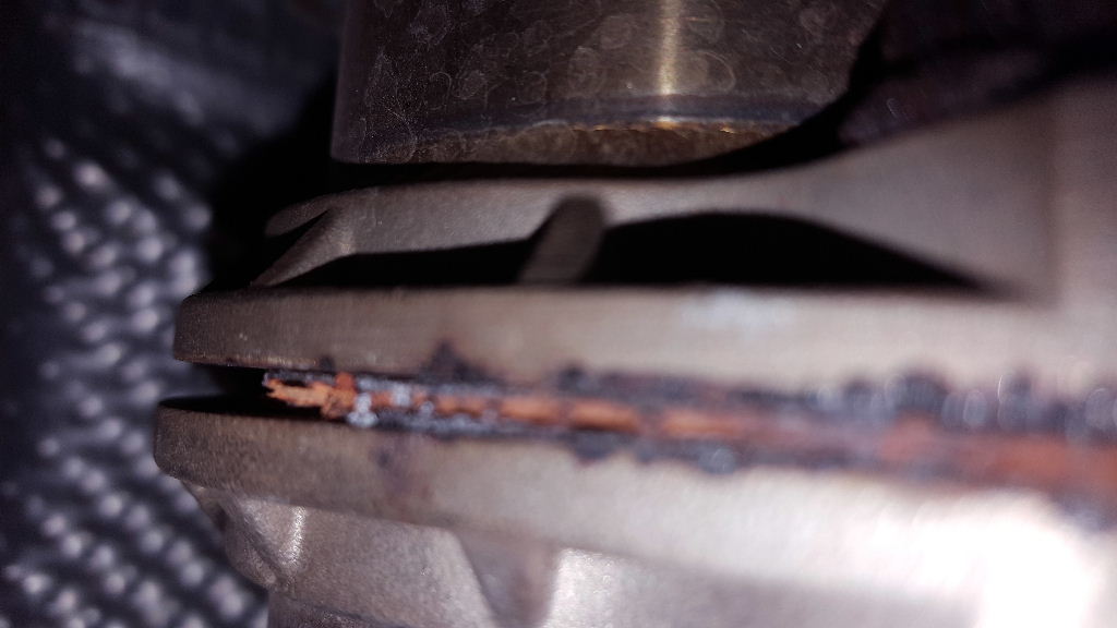

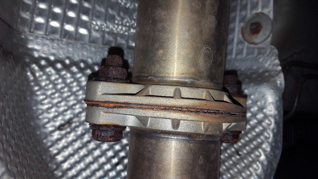

I think I found the issue. Putting my hand over the top of this pipe, I could feel the exhaust pulsing out - where the two pipes come together right before the gas tank.
Pic 5 (rg01e) is of the original exhaust connecting to the catback.
Attached Thumbnails Puzzled-rg01a.jpg   Puzzled-rg01b.jpg   Puzzled-rg01c.jpg   Puzzled-rg01d.jpg   Puzzled-rg01e.jpg

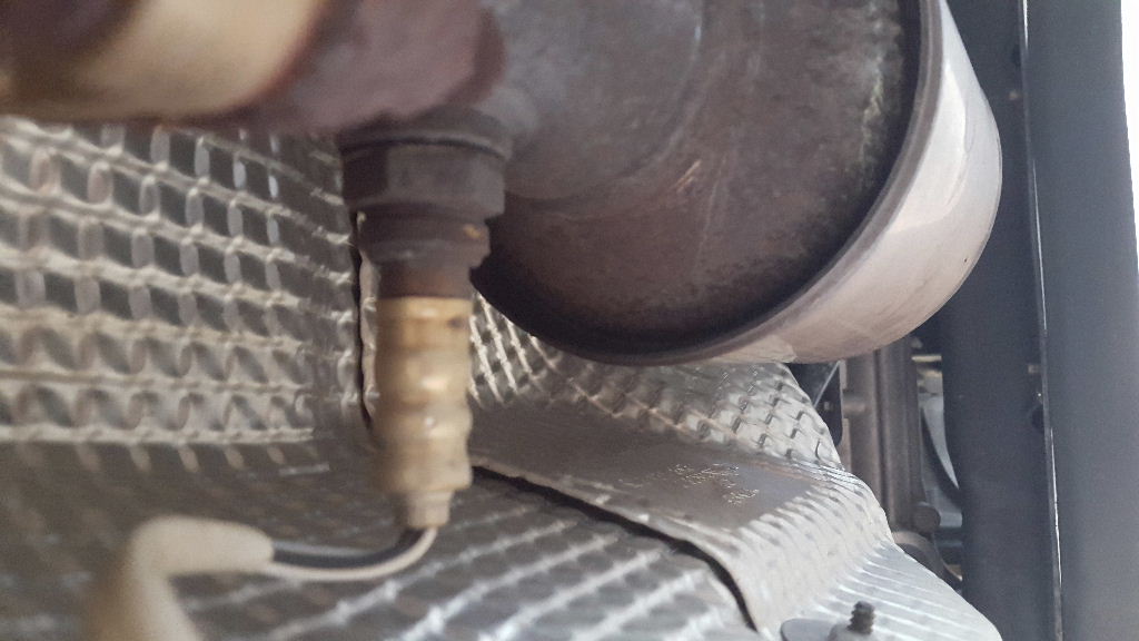

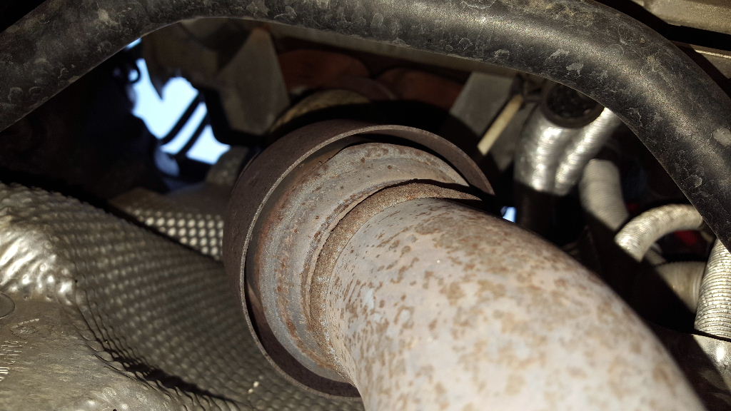

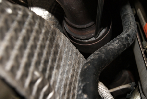

A few shots of the 2 'canisters' in the front of where the connection in the above post is.
Attached Thumbnails Puzzled-cat01a.jpg   Puzzled-cat01b.jpg   Puzzled-cat01c.jpg   Puzzled-cat01d.jpg   Puzzled-cat02a.jpg

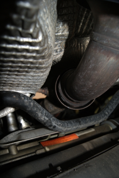

A shot of behind where the connection is, one of the dual breakouts.

Interesting pics... Looks like a gasket let go? Maybe this will be an easy fix yet.
That'll do it! cheap fix, looks like those bolts may be a bit of a pain to get off. Be sure to soak them with a bit of liquid wrench before trying to get off. The rest of the exhaust looks good.
I'm hoping - those are the best kinds of fixes, the easy ones.
Nik
I'm thinking they will probably need to be cut off and replaced.
