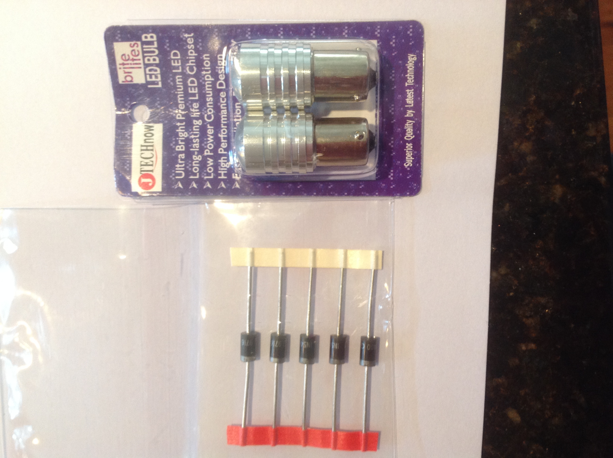

Wow, I posted last week I couldn't figure out why the top rear lights were not working, after a bit of research they are rear fogs check.
I needed the 2 3a 50w diodes. I screamed down to radio shack in Spencer, 20 miles away. They had all sorts of diodes but none 3 amps in size, haven't had any in a long time; Rats.
So I ordered from EBay the diodes and 2 red LED's
The diodes went super easy the red LED's appear to work well but the locator nubs on both sides of the led were inconsistently placed but I was able to seat them. I also moved the top bulb to the flasher location, thinking the top bulb was never used. Really rediculous Mini left the rear lamps like that.
I know have extra diodes 3, if you want them pm, let me know and I'll send them to you.

So the actual mod is to wire the unused rear fogs as additional brake lights?

Yes the idea is to wire the top unused fog lights as brake lights. With a car soo darn small a pretty smart idea. It's actually hard to believe Mini didn't do it.
Simple to do, I used red LEDs, seems a bit brighter but can be my imagination.
I did the diode bit but in reality probably just need to use the splice thing to join the two wires together.
Again, I have 3 extra diodes....
