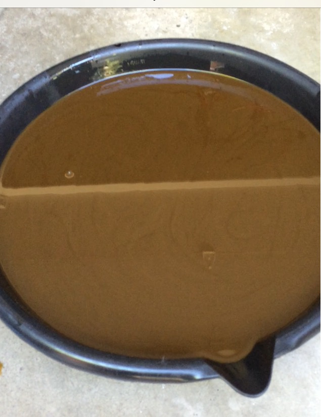

BUT, I checked the oil again the other day and saw what I thought was milkiness on the stick. Jerked the oil cap off, same milkiness. Drained the oil and this is what I found. Brand new Mobile 1 synthetic, and it looks like Hershey's syrup.

So, three questions for you fine motorheads:
  1. Is there such a thing as an intake gasket bleeding coolant into the oil on these guys?
  2. What's the preferred method of testing a head gasket on a Mini? Going to do a liquid test and probably a coolant pressure test to be double sure.
  3. Assuming the worst, how much trouble am I in?? Committed to doing this myself (because it's there, etc).

the oil cooler does let coolant and oil mix if the seals leak...often overlooked...
But since you a rough idle...I'd do a compression check...might give you info on the idle...easy enough to do....and might give you a definitive answer on the headgasket...might not since you have not seen steam out the tailpipe....
Yes...bleeding these cars can ba a pain...any sign it was low on coolant and that was causing after the t-stat change? Or had a bubble, aka was not fully bleed?

The chances of the oil cooler being failed bad enough to allow that much coolant to intermix with the oil is slim. I would bet you either need a head gasket or have a cracked head.
Start with a compression & leak down test, if that comes back less than definitive pull the valve cover and look for coolant around the rear most cylinder 1 head bolt.

Ok, so the head gasket blew. But why, did the head warp due to over heating? You have a few cycles of overheating so lets hope it isn't warped. When you have the head off I would take it in to have it inspected and possibly decked. But don't forget to ask why did it overheat in the first place was it just a blown head gasket or is there another reason. Be sure you check the water pump and PTO drive gears on the back of the supercharger. if the PTO gears got stripped and stopped spinning your water pump it would cause overheating. If your wife did not notice right away it could cause the head to warp and then blow the head gasket. this would not be the first case of this. While the head is off pull the supercharger and give it an inspection and top off the supercharger oil. If the gears don't have any teeth left you need a rebuild of that too or a used one.
worst case
1k for a new stock head. If yours is now warped and cannot be decked.
1K for a rebuilt supercharger because the supercharger gears chewed themselves away and are gone.
Best case. head gasket just blew and you are out $300 in parts and 8 to 10 hours of your labor.
