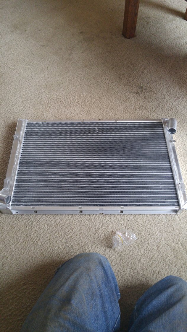

Well, was fixing a crank position sensor o-ring and oil pan gasket. Upon putting car in front end service mode I found a small crack in the plastic end tank of the radiator.
Weird, because I hadn't been losing any coolant and the car wasn't overheating.
Hooked up the hoses and mocked the radiator support on the car. Ran a pressure test.
Smallest leak you could ever imagine.
WELL. Im not going back to stock.
Do some shopping on all aluminum units.
Mishimoto-- mixed reviews.
EBay--mixed reviews.
Well, seeing as this car is slowly turning in to an EBay car anyway (headers) figured why not try the radiator!!
Ordered this bad boy from DNAmotoring and I have to say, I'm surprised at the quality!!!
I capped the outlet and hooked the pressure tester to the inlet and it is not losing pressure (20 minutes)
Of course that is no real world test, but I wanted to make sure it's at least welded shut lol.
Stay tuned because I am finishing the oil pan and fitting this bargain radiator this evening. Will report back.

$126 shipped. Fits perfect. There's no lower support for condenser though. The little c shaped holder. I improvised. Zip ties did the trick. There are no leaks and when the fan kicked on high speed it cooled down FAST. The fan was only on for maybe 15 seconds?????
Don't mind my broken radiator support if you see it, pulling that front end off solo made me drop it.... Little epoxy goes a long way
Time will tell if it holds up but all is well now. Hopefully someone gets some help from this thread. Decent radiator at a GREAT price.
