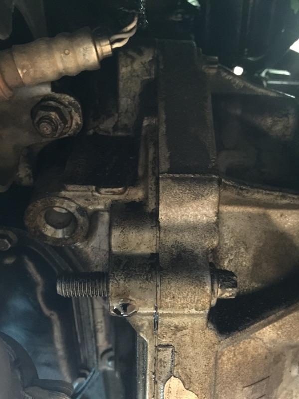

Oil Leaks
So I took my 2009 mini s into the dealership to get the footwell module replaced and they decided to give it the once over. They are saying that it has several oil leaks. They said the vacuum pump/engine harness is leaking $1885 to fix.
The oil filter housing is leaking $1490 to fix. And the turbo oil feed lines are leaking $1115 to fix. This after the already $1009 for the to fix the footwell module. Looking at the pictures, I can see the oil filter housing leaking but the rest? This dealership stuff on this car is ridiculous. Last year I spent $4500 to replace an entire transmission and transfer case on a 2008 Acura MDX. This was done at the dealership as well. Mini wants the same price to fix some leaks?

A couple of those leaks do need to be addressed. Have you looked into an independent that works on Mini's? You'd pay probably half and could put off a couple of them..

Yes. Looking into an independent for sure.....Which ones need to be addressed and which ones put off?

If you're going to get into the engine to replace some of these leaks you might as well tackle them all. I recommend doing the repairs yourself if possible - Detroit Tuned makes an awesome turbo oil line super kit that contains a different design oil line, one that will not leak in the future. It also comes with the oil filter housing gasket, and you can purchase the oil cooler gasket which you could replace at the same time for another $20 or so. In total it's less than $200 in parts, the rest is labor. I don't know about the vacuum pump leaks though, that could be more.
The working space is very very tight but I managed to get it done over a weekend with a friend, while also replacing the DP and IC. Saved me a ton of money, the dealer wanted $1200 for the oil filter housing repair alone, and I spent the $200 on parts and another $800 on the DP/IC instead

ok....picked up the mini from the dealer today and the new foot well module installed and programmed. $998.47 OTD.
To continue on the oil leaking issues, this is what my invoice says regarding:
Vacuum Pump Leaking Oil, Engine Wiring Harness Oil Contamination with O2 Sensors, Oil Feed Line Leaking Oil, Oil Filter Housing Leaking Oil, Turbo Leaking Oil.
I am on Detroit Tuned website and I am ordering the Turbo Line Super Kit and the oil cooler seals for a DIY job. I'm guessing that my purchases should fix the oil feed line leaking oil and oil filter housing leaking oil. Not sure about vacuum pump leaking oil, that engine wiring harness oil contamination with o2 sensors and the turbo leaking oil.

I just finished all the repairs. Replaced the vacuum pump, replaced the turbo oil feed lines, replaced the oil filter housing gaskets and the oil cooler gaskets. I put the vehicle all back together and took it for a test drive. Everything seemed fine but when I got home from my short drive, there was some oil dripping down from the oil filter housing. I cleaned up everything pretty good when I was in there but could this be leftover oil from the old leak? Is it possible that the actual oil filter housing is leaking? Before I jump to conclusions, should I just wait a few drives and see if it continues to leak? After all that hard work, I'm feeling very frustrated.
