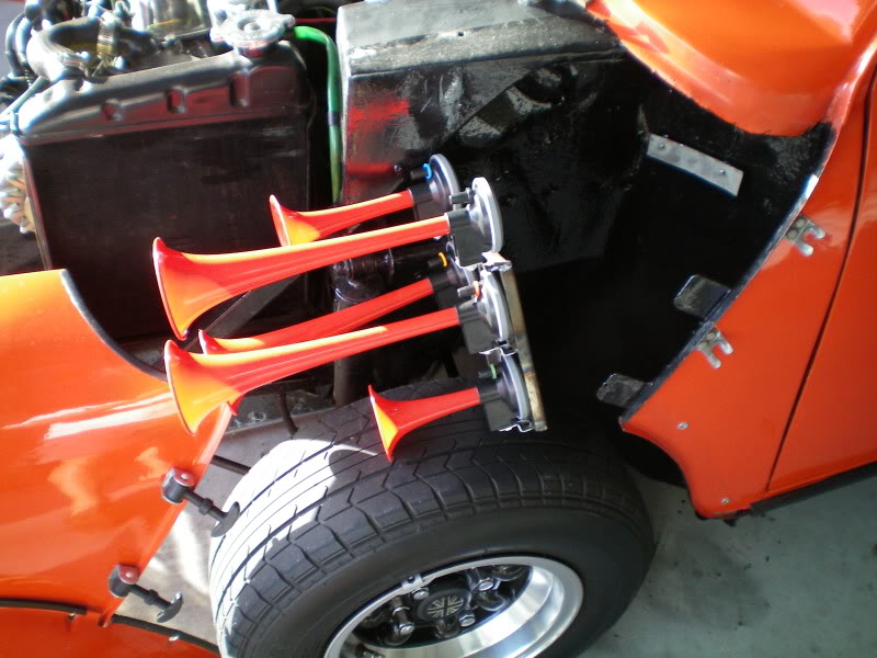

I've got those Hellas on one side of my 79 (wheel well)
and these on the other side
They play a bar of the Colonel Bogey March, popularly known as the theme song from the movie Bridge on the River Kwai (and yes ya'll, I know the details .... I'm simplifying . . . .)
