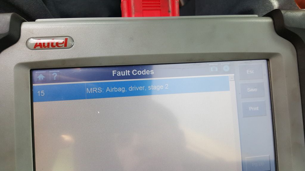

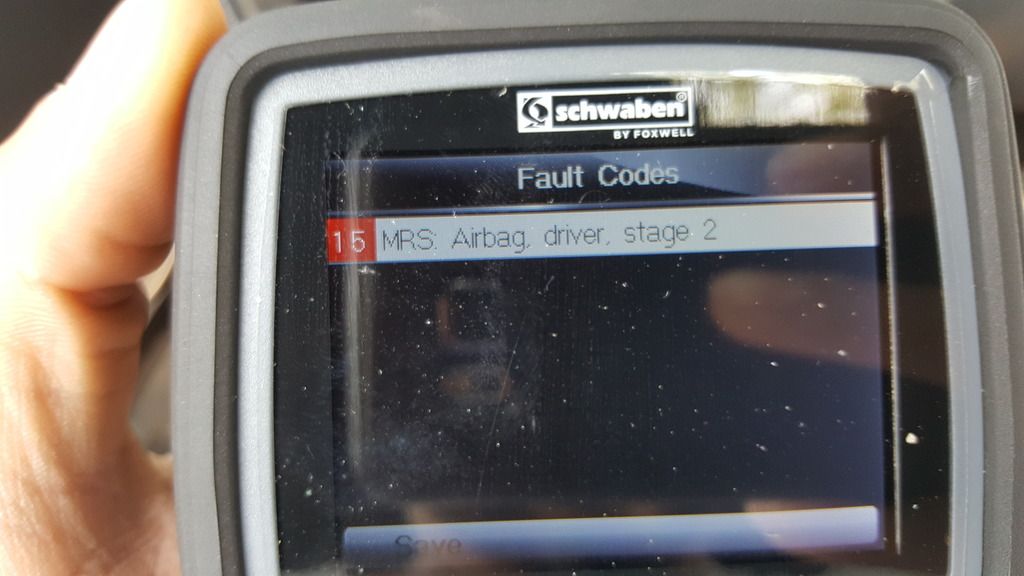

Dont waist you money this is the same thing as Autel DS708. It does nothing special at least for the R53 which is what i was hoping for. Haven't tested on my R56 (It maybe better for the R56 since it more computerized then the R53). I'm about to send it back. It does not clear the Air bag anything. I even asked ECS, before i purchased it and they told me it does. I have this code after removing my seat and forgot to take off the battery and it has never gone away. I wouldn't hold my breath in this getting an updated for the R53 before the 18 months is over.
When i did the original scan it didn't even pick up the P2096. Here are some picture to compare the Autel and this. the menus are the same everything is the same.
The Autel hasn't been updated Since it was purchased in 2011. The ECS unit just came out so imagine.

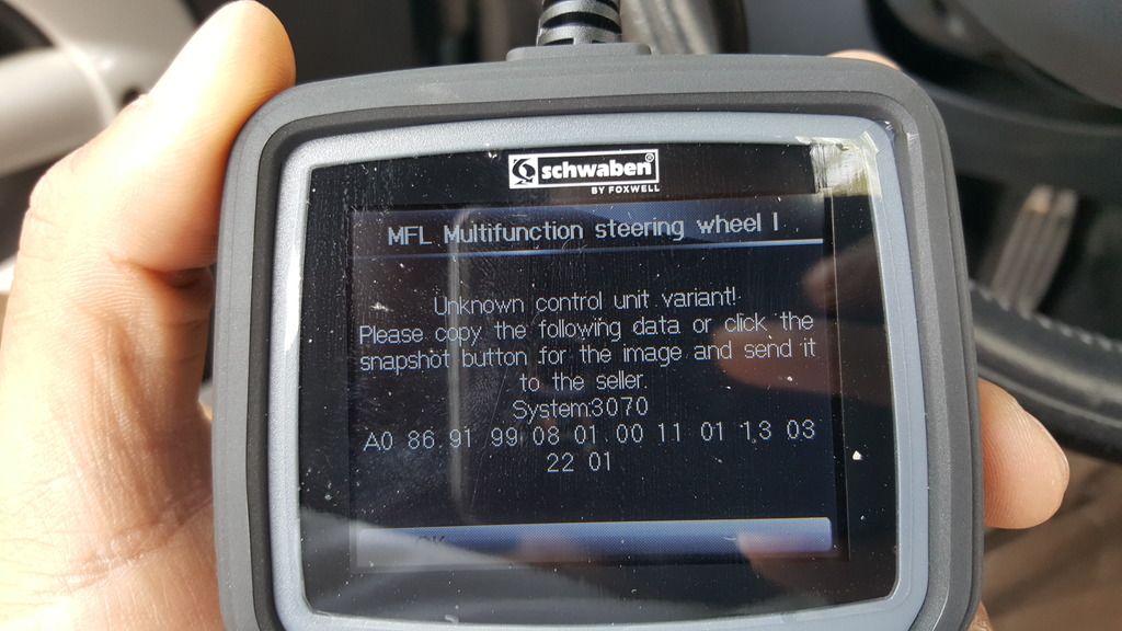

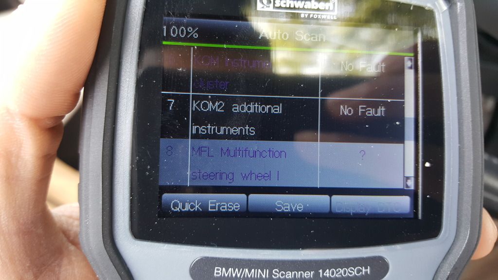

it reads a module that it doesn't even have a clue what it is. For a scanner that is made for a mini it unacceptable in my opion. The Autel does the same thing.
