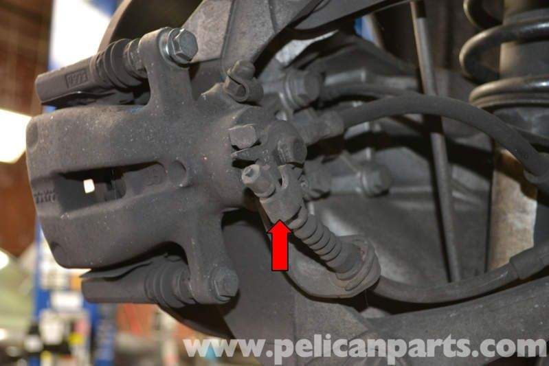

rear brake drag
Originally Posted by sevin
But why? The parking brake isn't engaged. Wheels should never feel like they're heavily dragging.
With the mechanical parking brake the chance of the rear brake drag is increased. Not in a low mileage car, but increase tendency with high mileage car, and worst with those in the rust belt. I don't know if you have done this to diagnose if he parking brake mechanism is causing excessive drag. Bentley has a spec for the gap to check for the parking brake lever arm. With high mileage car and/or rust belt car the return spring can be weaken from use, or corrosion.
Before replacing the caliper, I will hand force the parking brake lever to make sure it is not causing the extra drag. Once you ensure the parking brake is not applying pressure on the piston exercise the (hydraulic brake) a few times hard and check to see if the drag is excessive. If the drag is excessive, it is caused by the slider pins, or semi-seized piston. Piston corrosion or pitting can cause it to behave semi-seized as it does not slide smoothly against the hydraulic seal.
I appreciate my goovy parking brakes, especially in San Francisco.
Old Sep 11, 2017 | 03:33 PM
  #191
sevin's Avatar
sevin
Joined: Jul 2014
Posts: 1,118
Likes: 25
From: North Carolina
I'm not sure what you mean by "hand force the parking brake lever to make sure it is not causing the extra drag". You mean pull up the parking brake? Are you talking about the springs on the caliper? They looked fine when I was checking the caliper, no rust. The Autozone calipers come with new springs.
Old Sep 11, 2017 | 03:37 PM
  #192
pnwR53S's Avatar
pnwR53S
6th Gear - NAM Hall of Fame
Joined: Apr 2017
Posts: 3,967
Likes: 393
From: soggy pnw
I refer to the lever arm on the caliper. It has a spring to return it back to the release position.
Also Bentley has a rather German procedure to set the hand brake lever cable tension.

Old Sep 11, 2017 | 03:40 PM
  #195
pnwR53S's Avatar
pnwR53S
Joined: Apr 2017
Posts: 3,967
Likes: 393
From: soggy pnw
Old Sep 11, 2017 | 03:41 PM
  #196
sevin's Avatar
sevin
Joined: Jul 2014
Posts: 1,118
Likes: 25
Yeah, I saw that. So just push that clip the cable is wedged in up to release tension?
