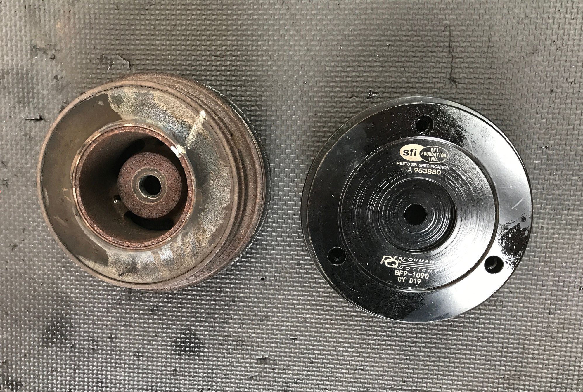

Well, found out my pulley broke.
Seems pretty typical from all the posts.
Decided to replace with a PRW pulley.
Significantly less cost than OEM or other recommended aftermarket pulleys.
Needless to say even my wife notices the difference in smoothness of the car now. That's saying a lot since she pretty much just drives the car until it breaks down!
I would strongly suggest if your Mini has more than 100k on it and the pulley has never been changed just do it!!! While you're in there change out the belt pulley (the small one) and the belt if they haven't been changed in a while too.

We tell people this all the time as the aftermarket dampers are actually dampers and balance better than stock which is just a chunk of rubber. But if you noticed that with the PRW you would have really liked the ATI damper as they balance even better.
We always replace the crank seal, crank bolt, and belt when doing the job.

The harmonic balancer is one of those items on the MINI that seem to be a "when it fails, not if it fails item." You can see a pretty beat up one at figure 6 here. Glad you got it all fixed up and you and your wife are enjoying the MINI once again.
When they took mine off it was in two pieces!
I'm thinking that this is almost a maintenance item at 100k. Maybe even less.
