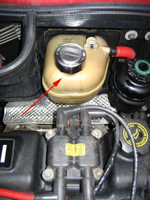

Once you do the pulley, most do a new belt every 12-24 months...the smaller pulley/smaller diameter and the slightly lighter aftermarket belts compared to the OEM conti-tec belts seem to need to be done more...you DO NEED a shorter belt to go with the new pulley...but they typically cost $20-25 at the local auto parts store, and the install only takes 15 minutes....the belts used on a MINI with a pulley reduction are VERY common on other makes....so easy to buy.
As for the coolant...yeah...IT IS THE MOST OVERLOOKED item on these cars...
the CAST-IRON block need a bit more care than a aluminum one...and since coolants are formulated for newer style aluminum heads/blocks, folks ASSUME it is good for 10 years....many folks have rust block their heater cores...then realize the block is FILLED with rust.....
I would suggest the BMW/MINI coolant...it is blue, and is actually a pretty good deal $$ wise....pick up a gallon, and a jug of distilled water...and you are good...was actually cheaper than some non-spec stuff that did not meet the OEM specs...

+1 for Zippy pointing out the cooling system as he is right, it is overlooked unfortunately. In general, it's recommended that you flush and clean out your cooling system once every 36 months, or approximately every three years. I like to perform this task on my own cars about once a year, or if I let it slip, once every two years. The reason for this is that old, exhausted coolant can actually cause irreversible damage to your engine components: We here at Pelican found this out firsthand when the head gasket on our '93 BMW 325is was replaced. The previous owner didn't look like he had changed the fluid once in the past ten years. As a result, there were many parts of the engine that were corroded and showing severe signs of wear. All of this including a good write up about Electrolysis can be read in our article here.

Flushing the coolant system here:
https://www.northamericanmotoring.co...g-coolant.html
Use MINI coolant or Blue Coolant that meets the specs. Mix it 50 / 50 with distilled water.
