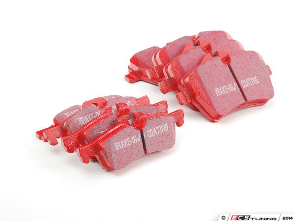

On pads you can go with the ECS reds , also match the calipers for grip of the Hawk HPS. Good middle road pad with great bite and wont dust near as bad as OEM pads.
