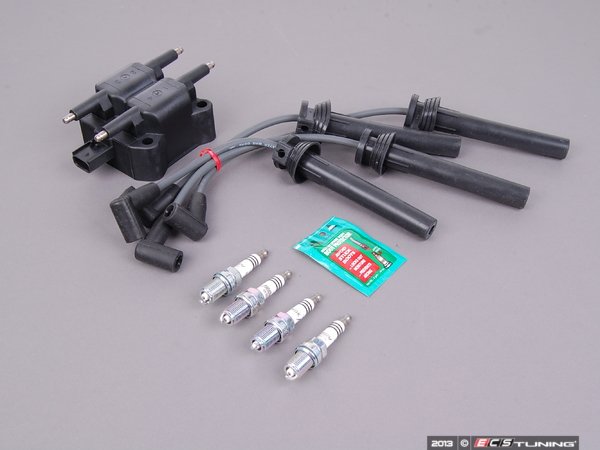

"What can be done to increase low end torque? I have a 15% pulley and CAI installed and plan on pulling a light trailer.
Other then a CAI and a pulley make sure you ave changed your plugs / wires / coil and done basic maintenance on the ignition side. "
http://www.ecstuning.com/Mini-2005-Cooper-R52-S-Convertible-L4_1.6L_W11B16A/Engine/Ignition/
Other then major changes , like an exhaust or a tune ?
