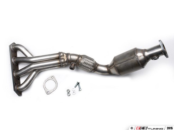

I would guess blown flex section on the down pipe (it is the braided section) see image...
But that is only a guess...

mm straight pipe, although if the flex joint went, it would throw a code, cause the rear o2 wouldn't see the same efficiency. the mid pipe might have disconnected or the pipe connecting to the first muffler could have

my son looked at it this morning and said the pipe snapped right behind the cat and suggests we get a new aftermarket header/highflow cat. any problems with that? Who has decent prices for that kind of thing?
