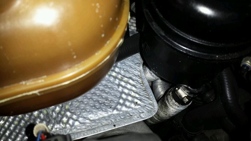

It just sounds rough to me with a ticking sound. I'm not sure if that's normal or normal for this type of car. I just noticed the leaking from the brown tank, what tank is that? There's also some leaking around the black tank next to it, what tank is that?

The brown tank is the coolant expansion tank. The black tank is the power steering reservoir. The coolant tank should probably be replaced before it completely fails, luckily its fairly inexpensive to replace with an oem unit. The power steering reservoir is likely leaking from the hoses on the bottom, some folks have had luck replacing the one time use factory clamps with a standard screw style clamp. The hoses run about 75-100 bucks each if your replace them. Keep an eye on the fluid level in the p/s reservoir if it gets low you could over heat the pump and burn it up. It does use a special fluid, CHF-11S, I would recommend sourcing a can , so you don't get stuck needing it and not having it.
I think the rattling noise you hear when the car is in neutral is the throw out bearing, dual mass flywheel, or a combination of both. Its a labor intensive job to replace those components but an aftermarket clutch kit made by Valero can be had for about $400. It will replace the troublesome dual mass flywheel with a more traditional solid flywheel.

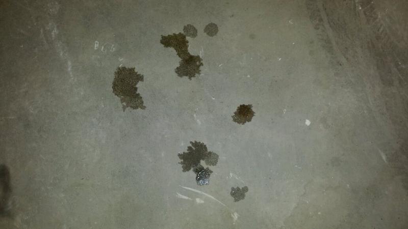

I have a leak of somekind on the garage floor and took better pics of the coolant overflow but more importantly the power steering res tank. Is this motor oil on the ground and what could be the most common leaking area?
Also, is the clamp and aluminum hose original?
