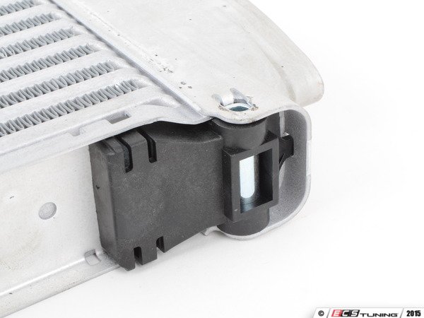

The larger oval port goes on the passenger side.
SC Intercooler ( Stock size )
http://www.ecstuning.com/Search/SiteSearch/11651515368/
If I remember right the black Tabs on the side go to the back:
Old Apr 2, 2015 | 01:57 PM

The larger oval port goes on the passenger side. SC Intercooler ( Stock size ) http://www.ecstuning.com/Search/SiteSearch/11651515368/ If I remember right the black Tabs on the side go to the back:
Hey ECS yup - left to right is hard to get wrong but what are these black tabs you are referencing?
Old Apr 2, 2015 | 02:04 PM
Posts: 36,760
Likes: 2,549
The black mounts on the one side.
Grizld700's Avatar
Grizld700
Joined: Apr 2010
Posts: 2,474
From: E. Iowa
Hard to explain with out photoshop circles. But if you look at the top pictures there are little black tabs at the bottom of the IC (as it sits in the picture).
Then if you look at the engine bay pic, you can see the same tabs (barely) at the top of the IC (as it sits in the picture) or toward the windshield.
