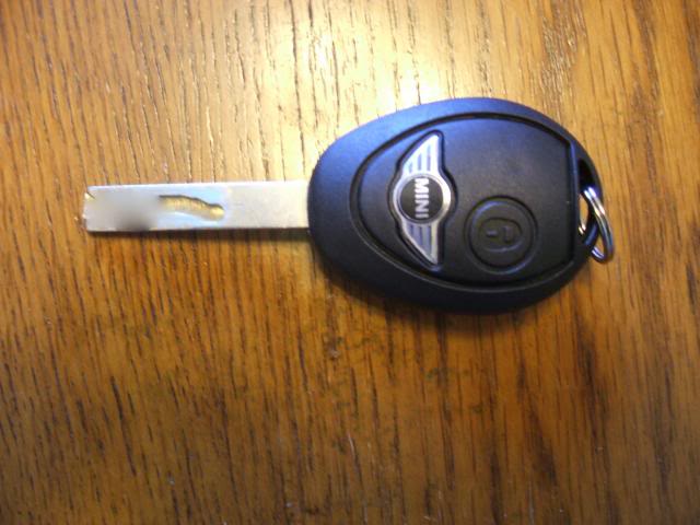

Is your key in physically good shape? It should look something like this:
Assuming there are no holes in the key fob (where the rubber buttons have fallen out) or missing switches it sounds like your door actuators have gone bad. It's a common problem with the early MINIs and the only real solution is to replace them. Some have attempted to try to fix the OEM actuators but the new ones that are available are more robust and built to a higher standard (or so it would appear).
Try this: does your key lock and unlock the hatch? One press on the lock button locks all the doors; one press on the wings unlocks the driver's side door and a second unlocks the passenger door and the hatch. If the hatch unlocks and locks as it should your problem is with the door actuators and not the central locking system.

Key does look like that, sans chrome Mini emblem. It's just embossed into the key but otherwise the same.
The key will unlock all doors, but not lock any of them. And the lock switch on the center will lock and unlock all doors.

Sounds like your key won't even lock your hatch. In that case, it could be your key or your central locking system. Open your key up (there's a place to pop it open where the ring goes through and see if pressing the lock microswitch on the board lights up the LED that you can't see through the cover. It should light up when either of the microswitches is pressed.
If not, the switch might be bad or something else might be bad on the key. If it does light up with the lock switch I'm guessing the central locking system is at fault.

Just pulled the key apart and the LED on the board is blinking, so it must be something in the central locking. I'll have to dig around and see how to diagnose it. Thanks for your help.
